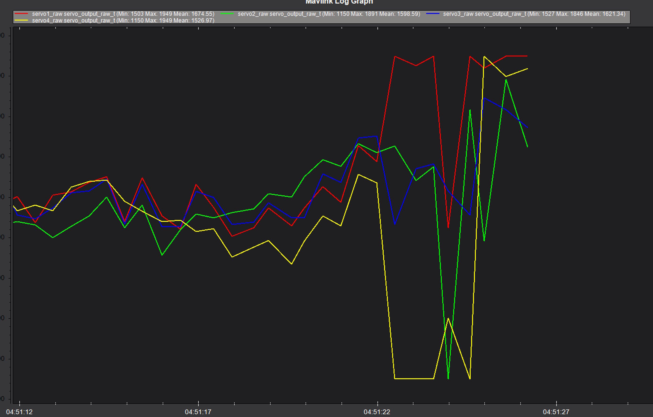

I would like to request help in finding the most likely cause of a crash incident we experienced, so we ( and maybe others ) can prevent this in the future.

Our analysis of the tlog so far…
We looked at requested vs actual attitude, and can see that roll is lost first ( positive direction ), then pitch ( negative direction ). This is consistent with the observation from the pilots.
Then looked at chxout, shows motor 1 ( ps/left rear ) signal going to 1950ms and motor 4 ( sb/right front) going to 1150. This looks to us like a problem with motor 1, that does not follow commanded signal, and again is consistent with attitude readings and observations.
After this, the steps become a bit less certain.
When we look at esc1_current we would expect this to either rise steeply ( in an attempt to follow a 1950ms command ) or go to 0 ( motor wire / signal wire / esc issue ), but the current reading stays more or less the same… which is odd.
Looking at esc1_rpm we would also expect this to either rise steeply or drop off, but this also almost stays the same… and after roll is falling off the reading goes to 4000, then 20000 rpm. The motors are not powerful enough to spin the props at 4000 on the test bench, so these readings are also odd.
Conclusion so far…
Our best guess at the moment is a possible wiring issue with wire carrying the the bi-dir dshot signal from the fc through the pdb to the esc, and that the current, rpm and other info were still coming back through telemetry… esc’s are set to shut down after 500ms of no-signal… but this is not consistent with current & rpm readings staying almost constant.

Motor 3 lost thrust and motor 2, opposite arm, dropped to compensate and down it goes.

Direct before the power lost off one motor the vibrations increase above 30 on all three axis. All the time vibrations (mainly y and z) rises sometimes above 30 but always only for a single axis at a time. But at that moment right before the thrustlost all three axis rises above 30 upto 45. Right in the moment of thrustlost also the total power consumption goes down.
As I notice first some vibration rises - next controller tries to stabilize by maxout servo1_out and reduce servo4_out - followed by reduced over all power consumption.

@dkemxr you are right, I now saw the individual ESC data on the STATUS Tab while replaying the tlog. Also this shows ESC1 goes up with RPM and going down with CURRENT values.
It starts to paint the picture of a broken prop.
If the ESC_RPM values are the true (measured) RPMs and not a commanded / calculated /expected value. (I don’t have an experience with such modern ESCs :grinning_face:) than yes, a broken or loose propeller mount
I think you guys are right. eRPM is actual RPM from commutation signals so how else to explain a runaway motor RPM, a Commanded high servo output and current dropping to near zero?
Motor 3 (servo output 1) is the left rear motor for a BF Reversed Frame Type so this jives with the visual report from the pilot.

you can clearly see on the ESC data that ESC1 rpm goes up to around 19.000 while the current is nearly 0. This is not saying motor / propeller is working well at that point. The later fire can be issued by ESC2 with 0 rpm while high steady current arround 50A. I think this happend by the crash and blocking of the motor

Yes, perhaps it could. I don’t know if we can tease any more data out of the Tlog and because of the low sample rate it’s hard to know if the timing between data fields is right. There is also a question about the scaling on the graphs. Some are clearly right where other are questionable. Always the issues with Tlogs unfortunately. For example here we see the command output for Motor 3 going to Max and the opposite arm going low which is a typical signature of thrust loss on a motor. It also shows some ms delay before the current drops on that motor but I don’t know if we can really read anything into that.
One bit of info that is interesting in a gallows humor kind of way is I think you can see the IMU temperature rising as the flight controller burns before logging halts.
