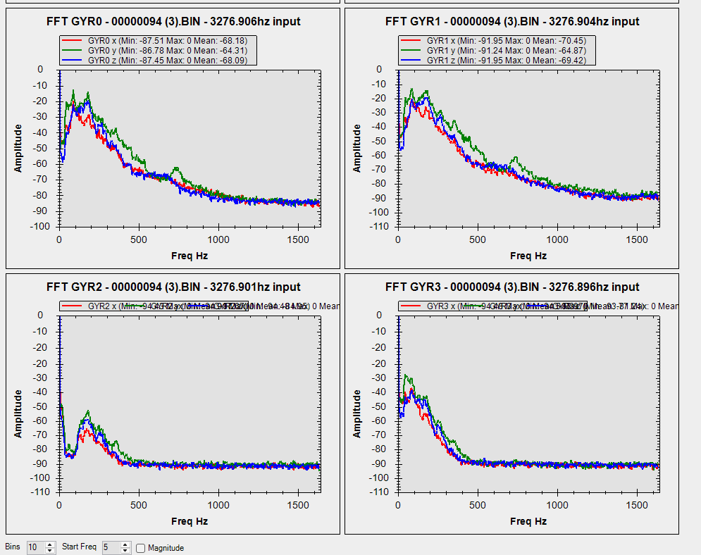

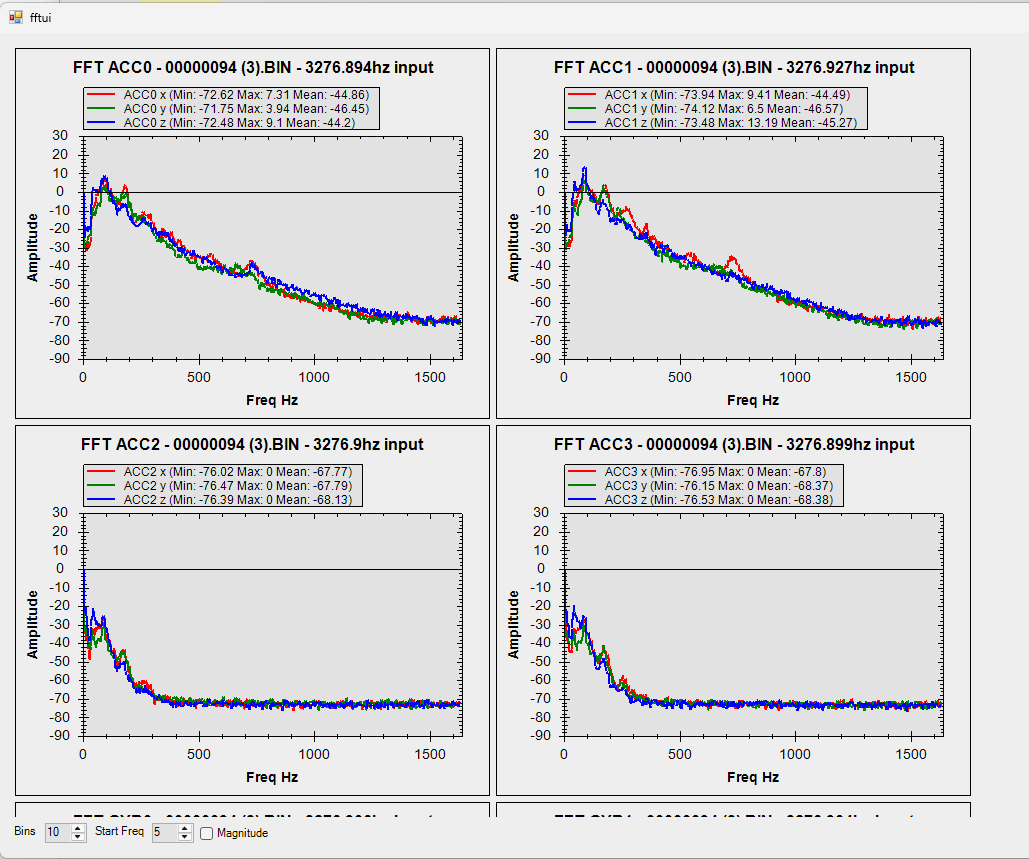

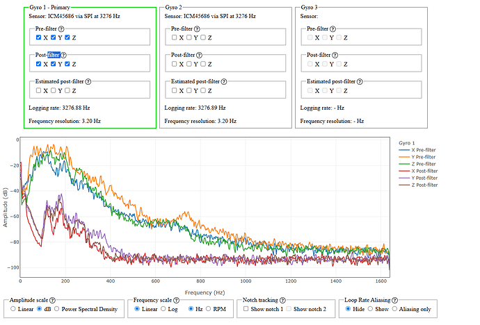

I’m using ArduPlane firmware on a Y6F VTOL configuration and I’m trying to interpret the Filter Review Tool graphs. I’m not sure how to read the plots or determine if my filter settings are correct.

https://firmware.ardupilot.org/Tools/WebTools/FilterReview/
Log file: here

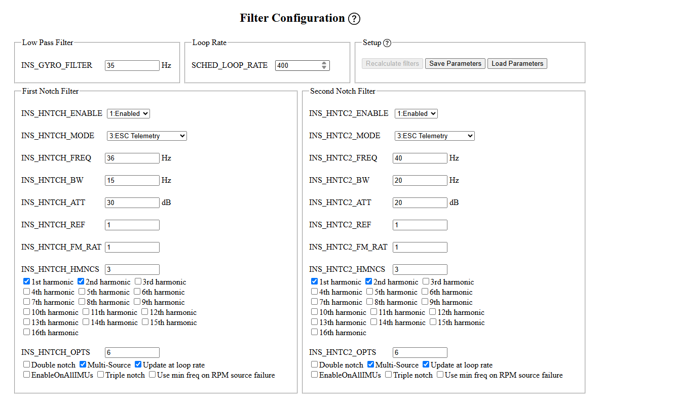

I’d appreciate any feedback on the Filter Review Tool results and recommended INS_GYRO_FILTER/INS_ACCEL_FILTER settings.
Arming checks are disabled? And there is a crash dump?
Your setup is quite odd. You have to notches tracking ESC telem?
Its a bit hard to tell what is going on, raw logging with INS_RAW_LOG_OPT would give a clearer picture than batch logging.
