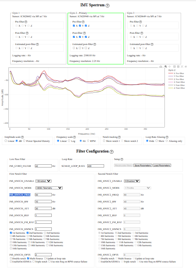

Filter Review - can't select "post" filter, can't turn off "estimated post" filter
I haven’t done and ArduPilot tuning in a while - so maybe I’m just forgetting some things.
I did a test flight today on a 400” class quad-copter using a Cube Orange. I’m using bi-directional d-shot, so have rpm as the basis for my notch filter. I’m also using a 3 bladed prop.
For some reason, the Filter Review tool doesn’t allow selecting the Post filter data. And it has the “estimated post” filter selected by default - but it doesn’t show lines for that either.
I think I have all the parameters set properly - but maybe I’ve missed something. Below is a link to the log file on google drive.
I’d appreciate any suggestions. Thanks!
Note - my notch filter settings for this log file are still what I had set for a two bladed prop. Since this is for a three bladed prop, I need to change INS_HNTCH_FREQ. Hover rpm is 5100. I’d appreciate some guidance for setting INS_HNTCH_FREQ properly.
Logging is misconfigured. You have a case of “check all the boxes” with the Log Bitmask and are not taking proper advantage of raw logging with that Flight Controller.
Set the Log Bitmask back to default (disabling Raw IMU and Fast Harmonic Logging anyway).
Disable these:
INS_LOG_BAT_MASK, (set to zero)
INS_LOG_BAT_OPT, (set to zero)
And then enable this:
INS_RAW_LOG_OPT,9
Then advance.
AMC refreshes your memory with the correct sequence of configuration steps, and when only one correct value exists, like the ones above, automatically sets parameters to their correct value.

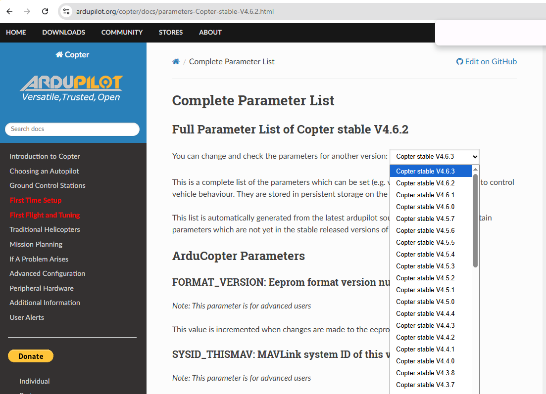

Presently the ArduPilot Parameter List wiki only goes to 4.6.3. Your link is for the Development version of v4.8.
I didn’t even know there was a development version of the parameter list.
And I’m not sure when it would be appropriate to use it for it. After all - this parameter is in the current stable firmware.
I did see the new entry in the wiki - very helpful.

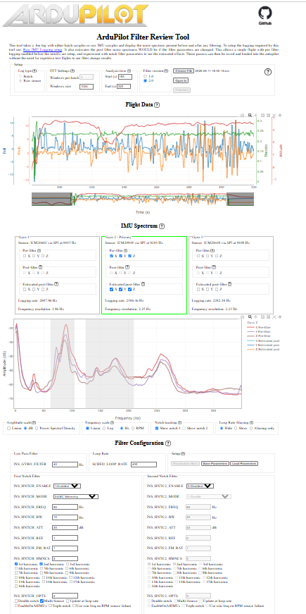

Using the new parameter, the Filter Review tool now generates the proper charts - with pre and post filter data.
Now - I have to do the tuning. I’m using 3 blade props - and as I recall all the docs assume 2 bladed props. So I may need further assistance.
Here’s the log from my test flight with the parameters new parameter settings.
