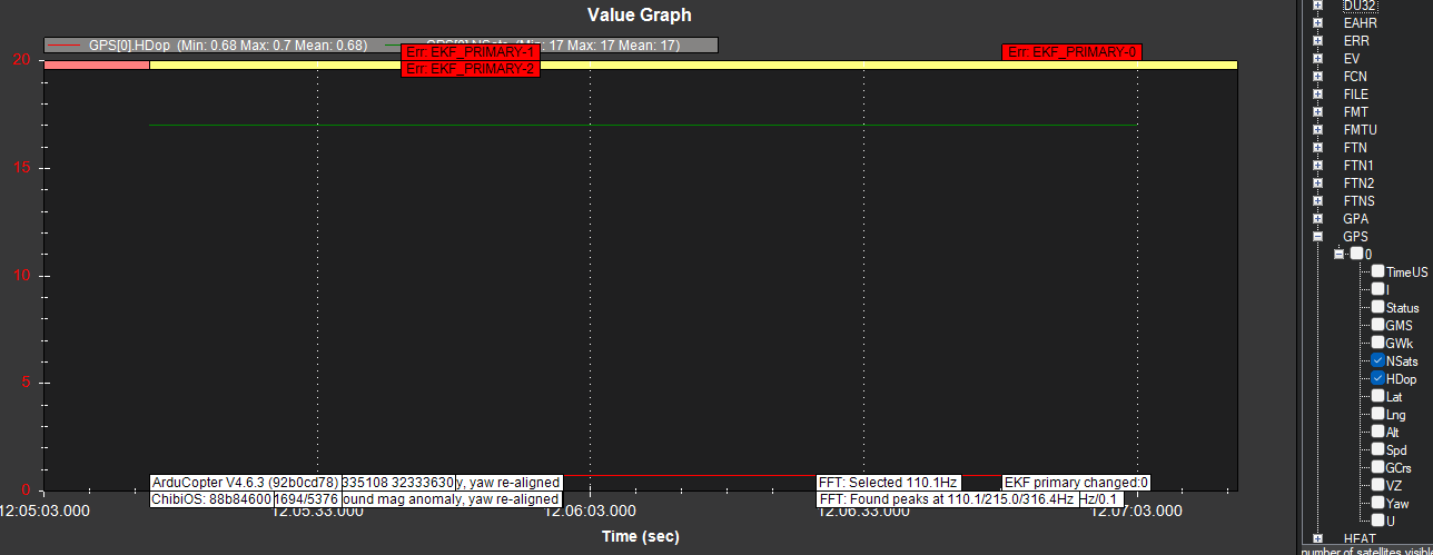

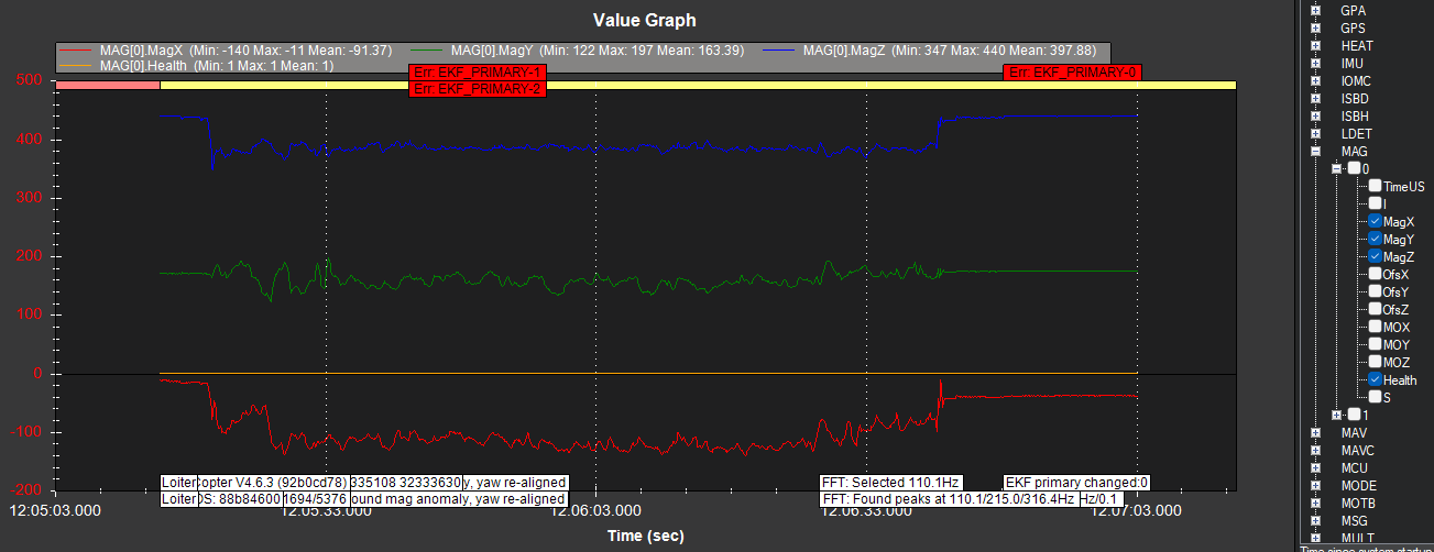

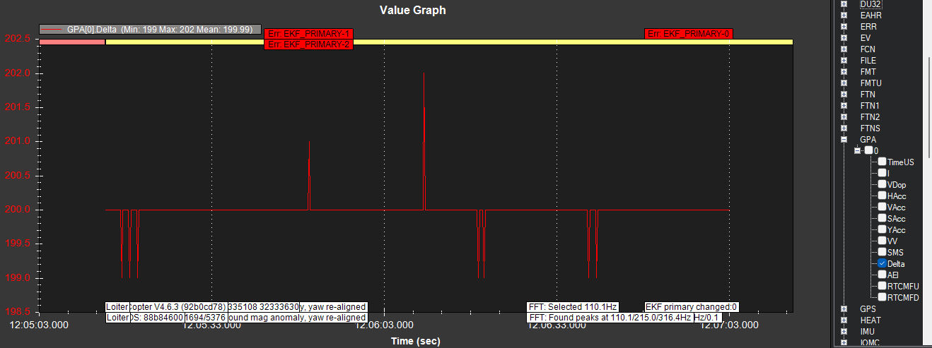

  2. I’m getting constant EKF lane changes, the GPS puck (CANBUS) is 10CM away from the Cubepilot, Herelink etc on a GPS stand. Why is this happening?
    • All components on the latest firmware. (Autopilot, Here4 etc)
  3. The drone in loiter mode randomly will ascend, again not sure why this is happening?
  4. When working with dataflash logs is it possible to extract the logs that would be displayed in the “Messages” tab in mission planner? Or is that data only present in TLOGS? (I do not have the tlogs for these flights)

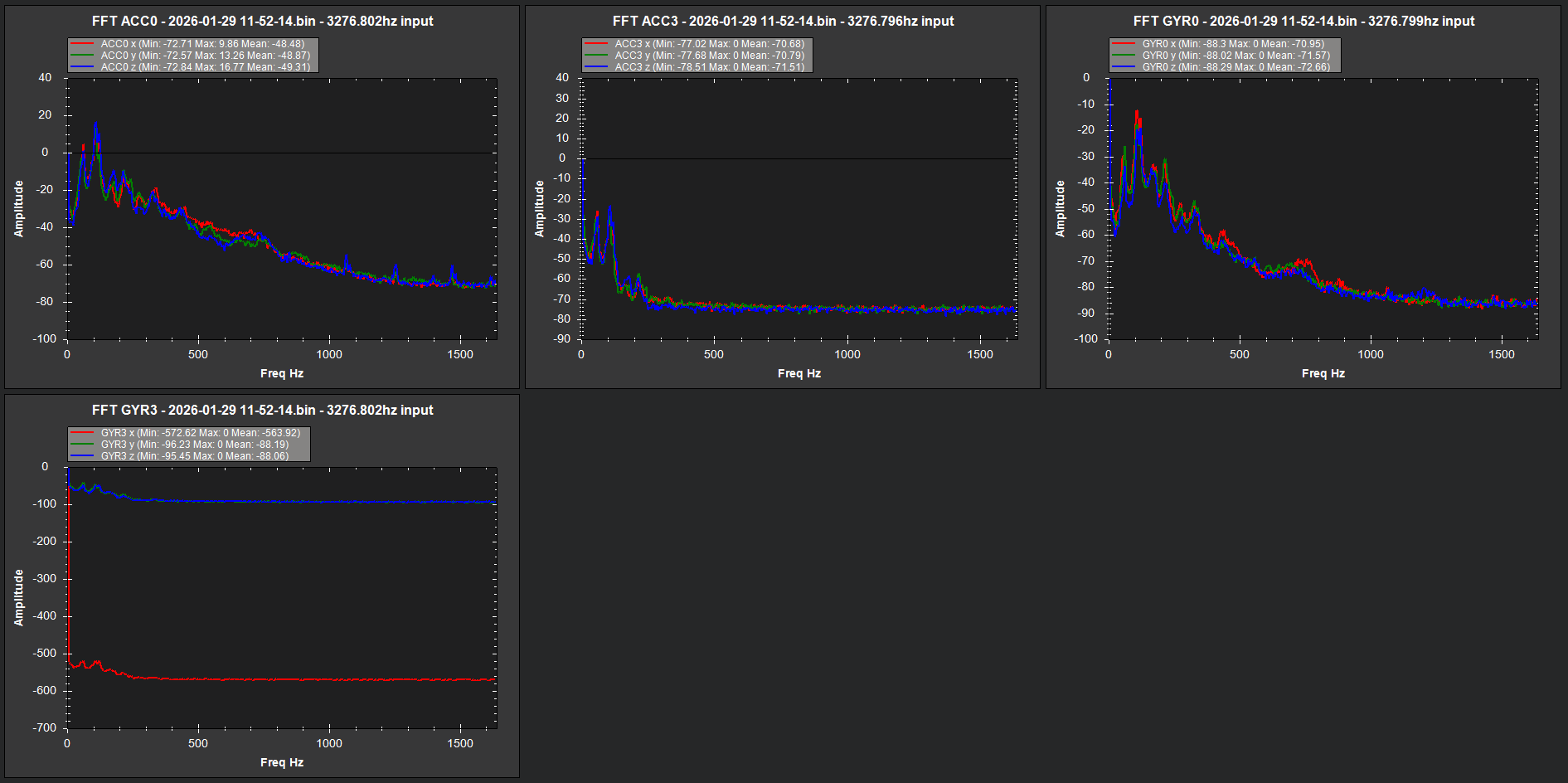

And here is a screen grab of the FFT:
I would suggest using a Throttle based notch, they work well. And you are using the wrong tool for analysis. Webtools
And, if you want someone to review the log for Notch Filter analysis you will have to link to a .bin file.
Thanks for trying this feature! I think you are the first person to try it since I developed it. The FFT selection looks sane, the error means that no notch was configured for throttle-based notching. We are basically trying to avoid overwriting your existing configuration. To get around this enable the notch - INS_HNTCH_ENABLE = 1 - then setup for throttle - INS_HNTCH_MODE = 1 - then disable the notch again - INS_HNTCH_ENABLE = 0. It should then work. Note that we try and setup the defaults to make this work out of the box, but there are some idiosyncrasies that I’m not terrible hapy about.
The tool I was using was ArduPilot Filter Review but I was trying to diagnose why the auto selection wasn’t working.

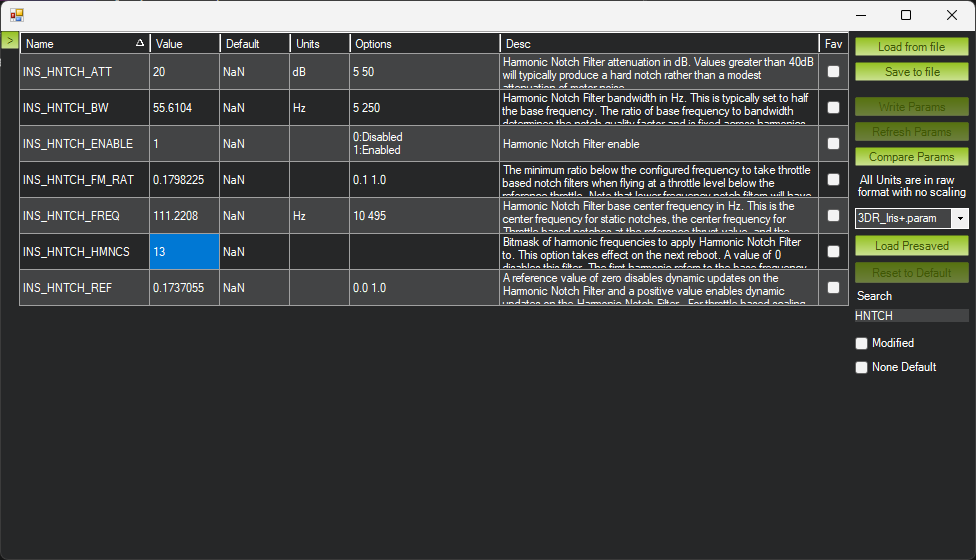

I’ve done some flights today. The notch filter setting was successful, but the flights afterward performed quite poorly—worse than when the notch filter was disabled. I’ve attached the DATAFLASH BIN here:
It also set INS_HNTCH_HMNC=13 automatically. (It was originally set to 7/1,2,3 harmonics before disabling the notch and running the FFT)
After running the FFT when trying to fly I got a tonne of oscillations.
Here is the BIN straight after the FFT Tune (rebooted autopilot):
I wasn’t sure what option to take here so I disabled multi-source and set INS_HNTCH_OPTS = 0 and the oscillations went away. But I’m still receiving a tonne of EKF lane switch messages and the drone would randomly ascend and descend in loiter. (Though I suspect I’ve got a potential baro issue too as I’m getting some fluctuation on Position/vert EKF) I also got some GPS issues later on despite the Here4 seeing 16 satellites.
This is often a problem with the FFT analysis - it misses the first peak due to lack of energy. Try dividing the FREQ by 2, changing the HMNCS to 7 and dividing the bandwidth by 8 (if you are using notch-per-motor you typically need a lower bandwidth).
