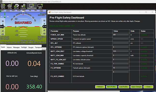

Create this yourself with a Plugin. This one took 10 minutes to create. Added to the Right Click menu in the HUD.
Thanks so much! That’s an amazing Solution!
Very easy to accomplish too. All I did was prompt an LLM with your post verbatim except item 4) and told it to provide a plugin for Mission Planner. A couple of bug iterations and the basic structure was working. Added it as a right click menu item and then added the profile save/load. You can see it needs more work but that’s just the standard tweaking these code generators need. You can do a lot with Plugins!

OK, attached. Past it into the plugin directory.
PreFlightSafetyDashboard_v1_7.zip (5.8 KB)
If you want to work on this further upload the plugin file to your LLM and prompt it with what you want changed. It might first have to know what version of Ardupilot you are using. This is for Arducopter V4.7.1 current Stable.
Thanks very much! Works like a charm!
