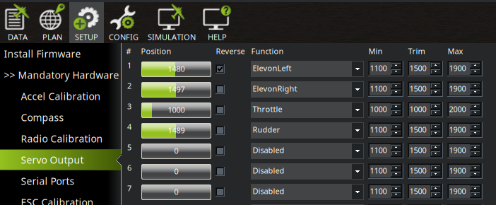

Is it configured as Throttle? Use Mission Planner to setup, configure and tune the plane using Arduplane. Use QGC as a ground station later if you like.
Thanks for replying, Servo 3 is configured as throttle, and it works since I could calibrate and test it.

I have an elevon + pusher prop fixed wing, with a typical PWM ESC.
The RC is configured and the servos are moving correctly, following the steps here - Elevon Planes — Plane documentation
After that, I follow the ESC config described here as “Typical ESC Calibration” - ESC Calibration — Plane documentation -
Connect via USB, arm and raise throttle, then connect battery, lower throttle. The ESC beeps to acknowledge that it’s been calibrated.
Then I test it a few times, it spins up and down as it should.
Then I disconnect the battery, re-connect, re-arm, and try to spin up from Manual flight mode, but it just sits there.
If I repeat the calibration, it will respond again, until I remove power.
I repeated the calibration and configuration with Mission Planner but it’s the same.
I thought the issue could be that the ESC was being powered before the FC was armed, so I switched “Arming Required” to 0 to test, but it still wouldn’t spin up on start - so I put it back.
It’s as if the ESC calibration is not being saved.
I’ve narrowed it down to a problem with the start up sequence.
When I plug in the battery directly, the ESC gets power before the FC is active. The ESC beeps thrice to indicate it’s powered, but doesn’t do any of the following “Cell number” beeps.
If I plug the FC to USB first, and then connect the battery, then the ESC will beep to acknowledge power, and battery cell count, and then respond as expected to arm/disarm/throttle.
So, as a work around I’m powering the FC first via USB and then connecting the battery.
