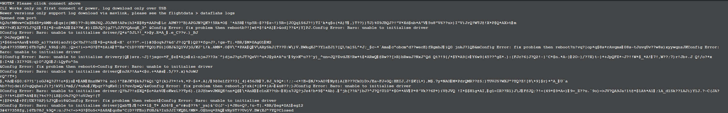

I bought a Mamba h743v4 to do some autonomous navigation a while ago and got ardupilot to work. Unfortunately things came up and I set that project to the side. Now I wanted to try again but I can’t get arudpilot to work anymore.
Current status:
ardupilot has previously worked, to the extent that I remember, I did nothing differently this time
currently betaflight works (I can get telemetry and spin motors)

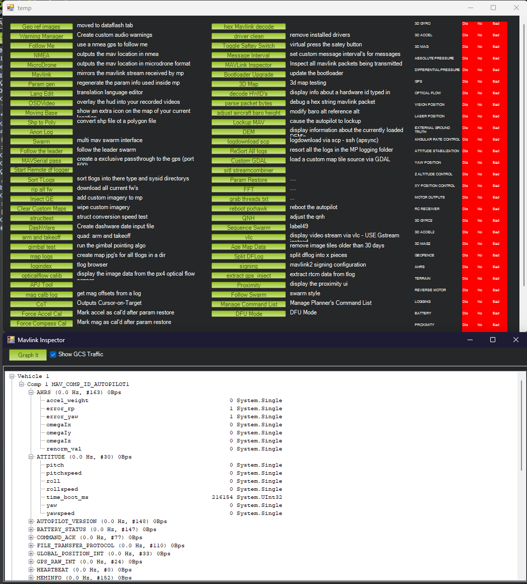

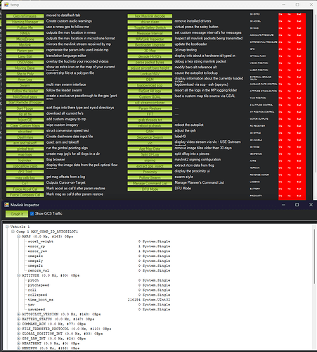

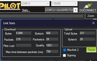

ardupilot currently installs, I can connect it to mission planer with mavlink and edit parameters from the full parameters list but that is it, can’t spin motors, even no gyro data
What I tried:
multiple reinstalls and flashes, solutions by chatgpt, none of them helped

I included some screenshots from mission planer.
