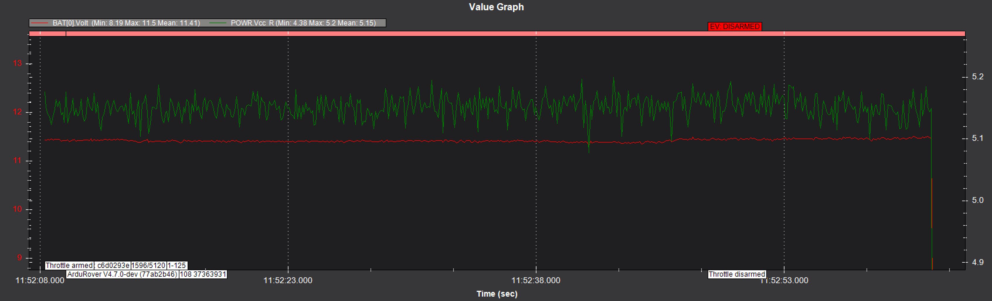

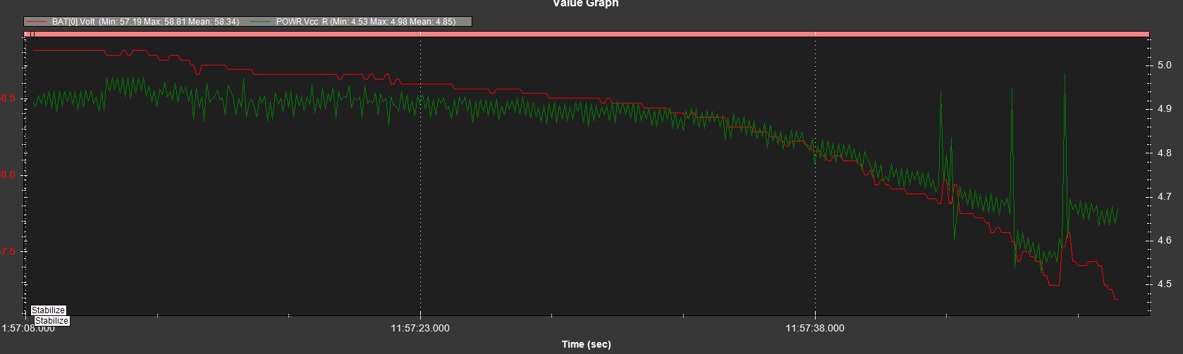

This isn’t right. Those Power Modules are supposed to produce a relatively stable 5.2V. This never does and it slopes off with input voltage which voltage regulators don’t do until they hit the drop-out voltage.
Is this Power Module even functional now? Measure the output voltage with a meter.

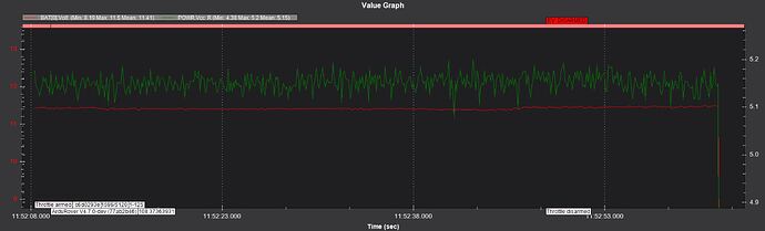

So, what should an example VCC graph look like?
Like this. I only have a Rover running today that logs Vcc (CubeOrange+) so I’ll use that as an example.
If I ran it longer to deplete the battery the Vcc voltage would remain relatively constant.

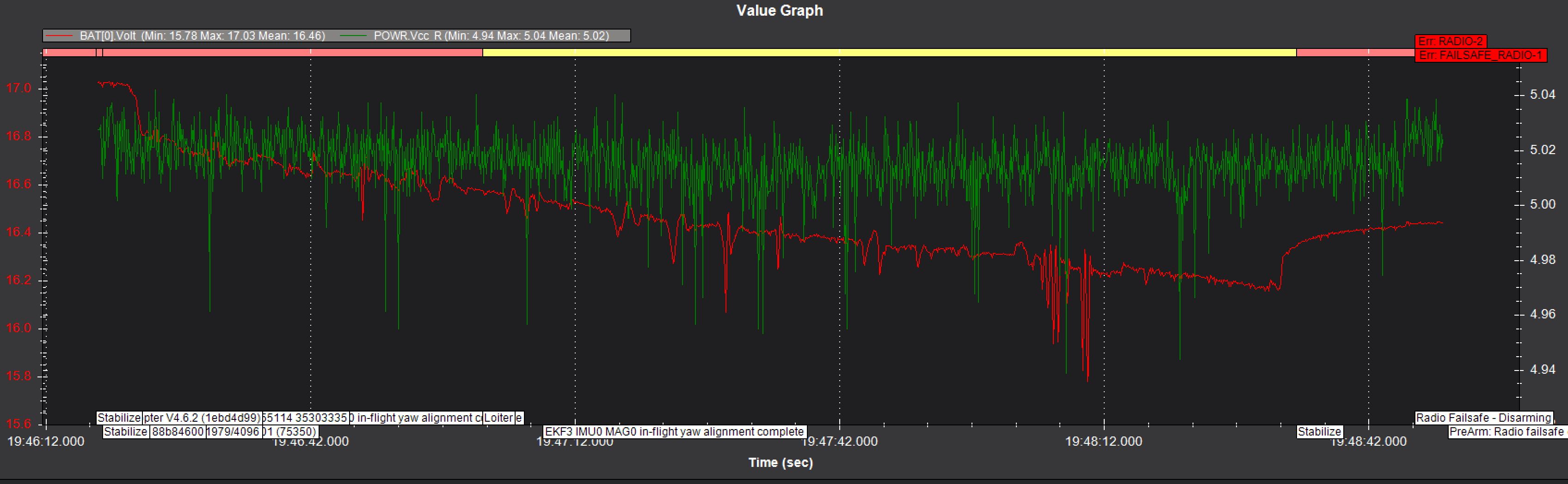

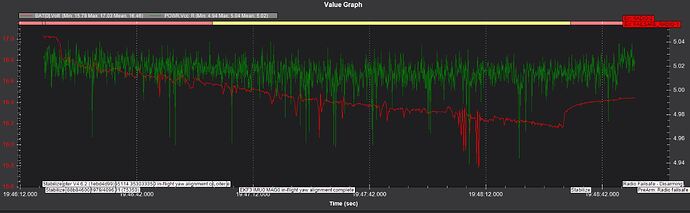

Here is another one from a small quad. Note the Vcc is within a 100mV as the battery depletes. And this is a cheap Power Module.
Actually, this The cause and solution are simple. If the VCC voltage were completely restored, the system health and flight performance would be better, right?
