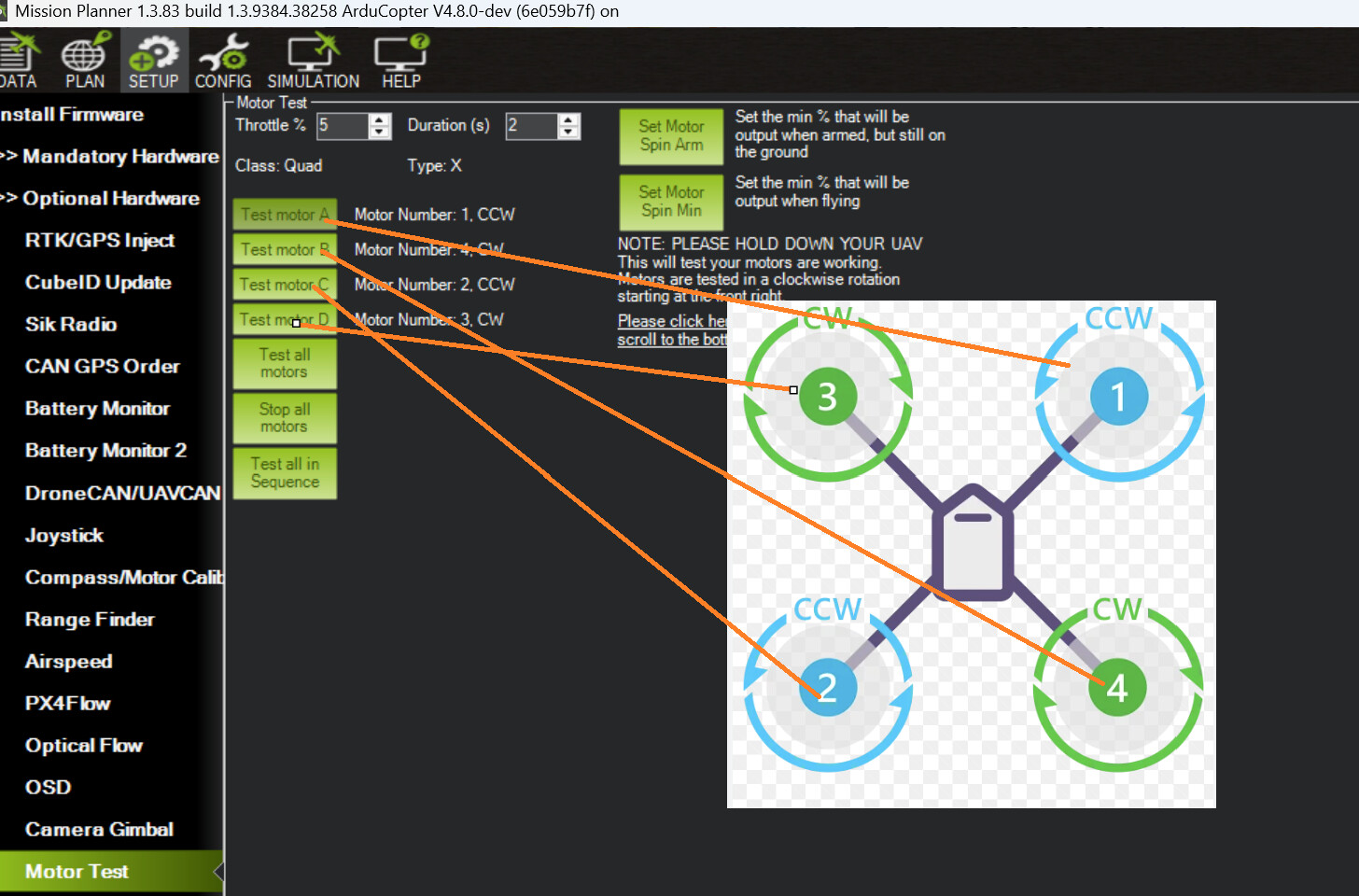

The other thing to check is motor layout and spin - send a video of the copter arming and disarming so we can see the props turn then stop. Or do the MissionPlanner motor test and choose All in Sequence.

Spin direction is OK in that video although we cannot tell if motor order is OK.

Imo this is motor order / orientation issue and poor compass calibration which cause yaw rotation at takeoff.
i checked motor order and orientation before flight. Perhaps copper busbars effected internal compass. FC is positioned 9cm above the power supply line. i will disable internal compass and use external compasses. This can correct the error in the compass, right?
Hello!
Have you run the motor test to validate the motor order?

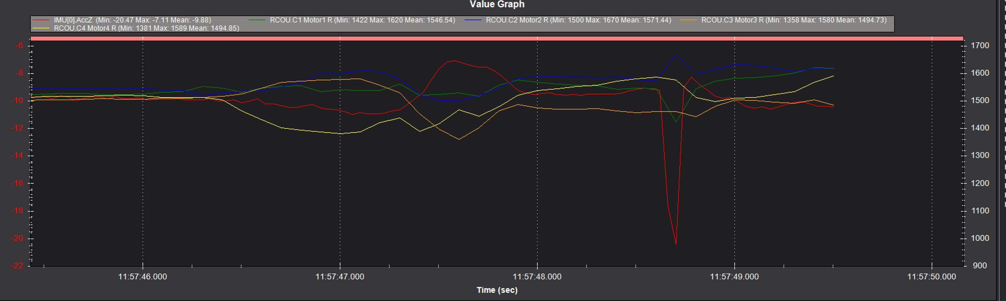

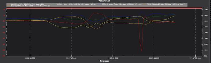

I don’t think it’s motor order as around the 39s mark it’s in a very short hover. Wrong motor order would cause a flip or spin as soon as it leaves the ground.
You can see here just before the AccelZ spike from the landing gear strike it was in a short hover. Then it bounced off the ground and the log ends. But of course right after that it flipped over and chewed up some ground.
Yes it was short take off. The drone lifted off the ground. Then it touched down to ground. Then, as it increased the throttle, it suddenly flipped over.
