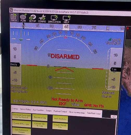

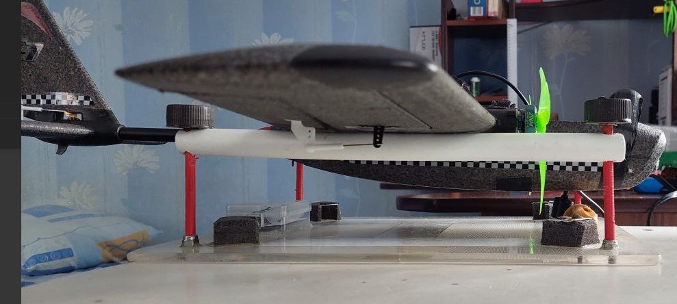

The problem is that I fly in manual and after switching to fbwa or Autotune, the plane turns its nose sharply up, I attach a photo that the plane is calibrated exactly, and a video of the situation itself. And I drop the log file in which I tried to take off, after the throw it sharply gained altitude up exactly, and then after losing speed it fell down.
See here under servo reversal:
