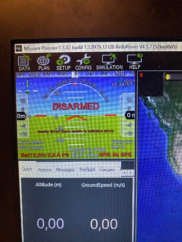

I flashed with firmware and got it to connect but then Config Error: Baro: unable to initialise driver. Saw some change buzz to on but didn’t work

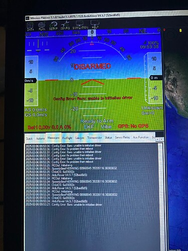

The wrong firmware maybe. You would not be the 1st. What exact board is it and post a screen shot from the messages screen in Mission planner after connecting that shows which firmware.

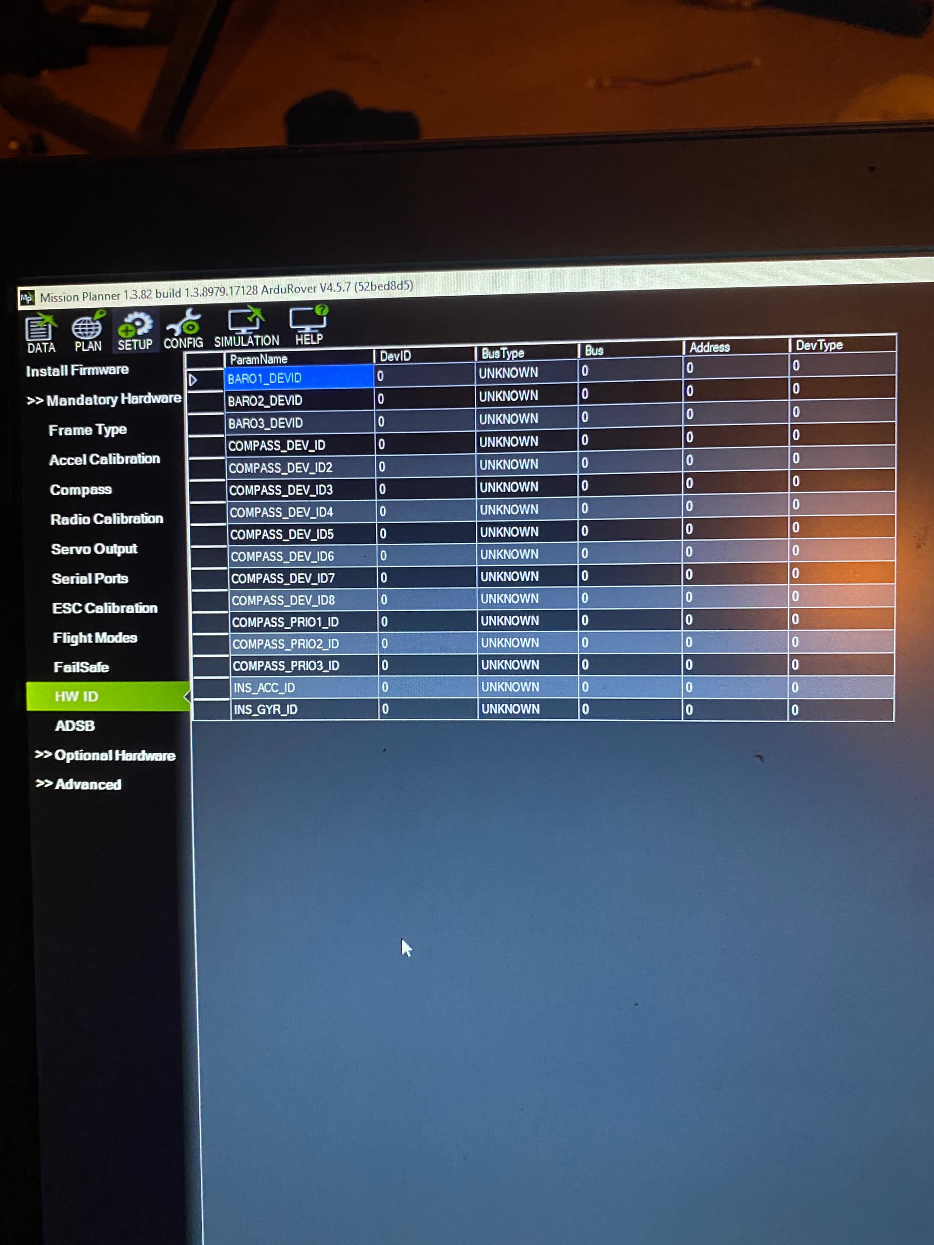

No, because that screen shot is not the messages screen. Then go to the HW ID screen and post a screen shot of that.
And you were showing the Plane Firmware page and Rover is installed.
I wanted to just try FC in rover first, downloaded .hex file with rover now, get same problem and view

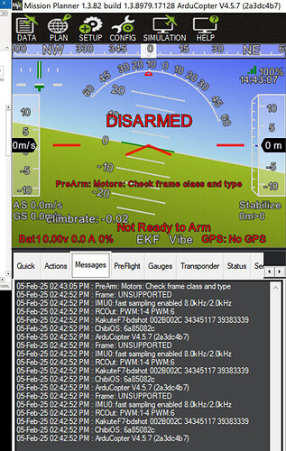

Post a screenshot of the MP Messages screen after you connect where it shows the firmware version. Like this:

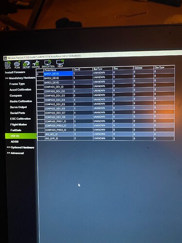

HW ID screen:
thanks, first picture was above right?
No, the 1st picture is the Messages Screen. Can you not just do what is asked?
The HW ID screen shows no hardware recognized.
Why is hardware not recognised? Was this what you meant?

Usually because the wrong firmware has been flashed. Yes, lets’s see a photo of the board you have.

First try re-flashing Rover by downloading the .apj from here and using Mission Planners “load custom firmware” to flash it. Then see what shows up on the HW ID screen. If nothing I suppose the board is scrap.
