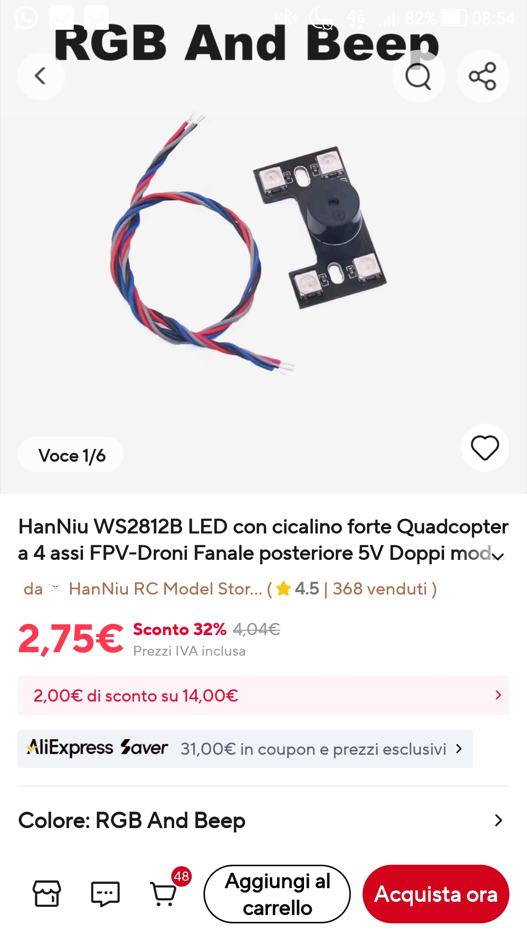

Hello, I have a Kakute f4 aio to which I connected a led strip with buzzer. Powered at 5 volts, negative on negative fc, signal connected to Pad led and buzz-. The buzzer works, the LED doesn’t want to know about it. Can someone kindly explain HVprogram?
Instead of such screenshot post a link to the module you have, best is a direct link to the manual.
Also post a detailed description of your interconnection between your FC and the module pin by pin.

Ho appena trovato questo articolo su AliExpress:
1,59€ | Fanale posteriore per droni FPV quadricottero a 4 assi 5V WS2812B LED con cicalino forte Controllo doppie modalità per NAZE32 CC3D F3 F4 F7
https://a.aliexpress.com/_Ewa2C7e
I post a link (hoping not to break the rules of the forum) manuals are not found (at least I did not find them) for the links:
Vcc---------- Pad 5volt On flight controllers
Gnd----------Pad ground on flight controller
Led-----------Pad led on flight controller
Bb- -----------Pad buzz- on flight controller
There are two things here: buzzer and WS2812 leds, which require two connections. For the leds connection see this.
My question is, how do I find the led output of the Kakute f4 in ardupilot? Connections are made.
It says to connect to a pwm output, is the led output a pwm output? What is that exit called in ardupilot? Thank you

If you have read the Kakute F4 AIO V2 manual you have seen that the LED Driver is on PWM channel 7. So try to set according to the link @Webillo send:
SERVO7_FUNCTION to 120 (NeoPixel1 - I am not sure but you have 1 Ledstring on your module )
NTF_LED_TYPE to 8 (WS2812B compatible)
NTF_LED_LEN to 4 (I am not sure but you have 4 Leds on your module)
