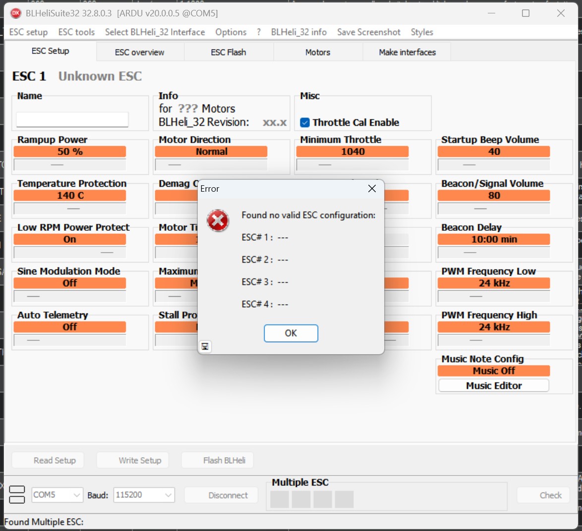

Post your parameter file. It’s not making much sense what you are reporting. Can you connect to BLHelisuite and check the ESC configuration?

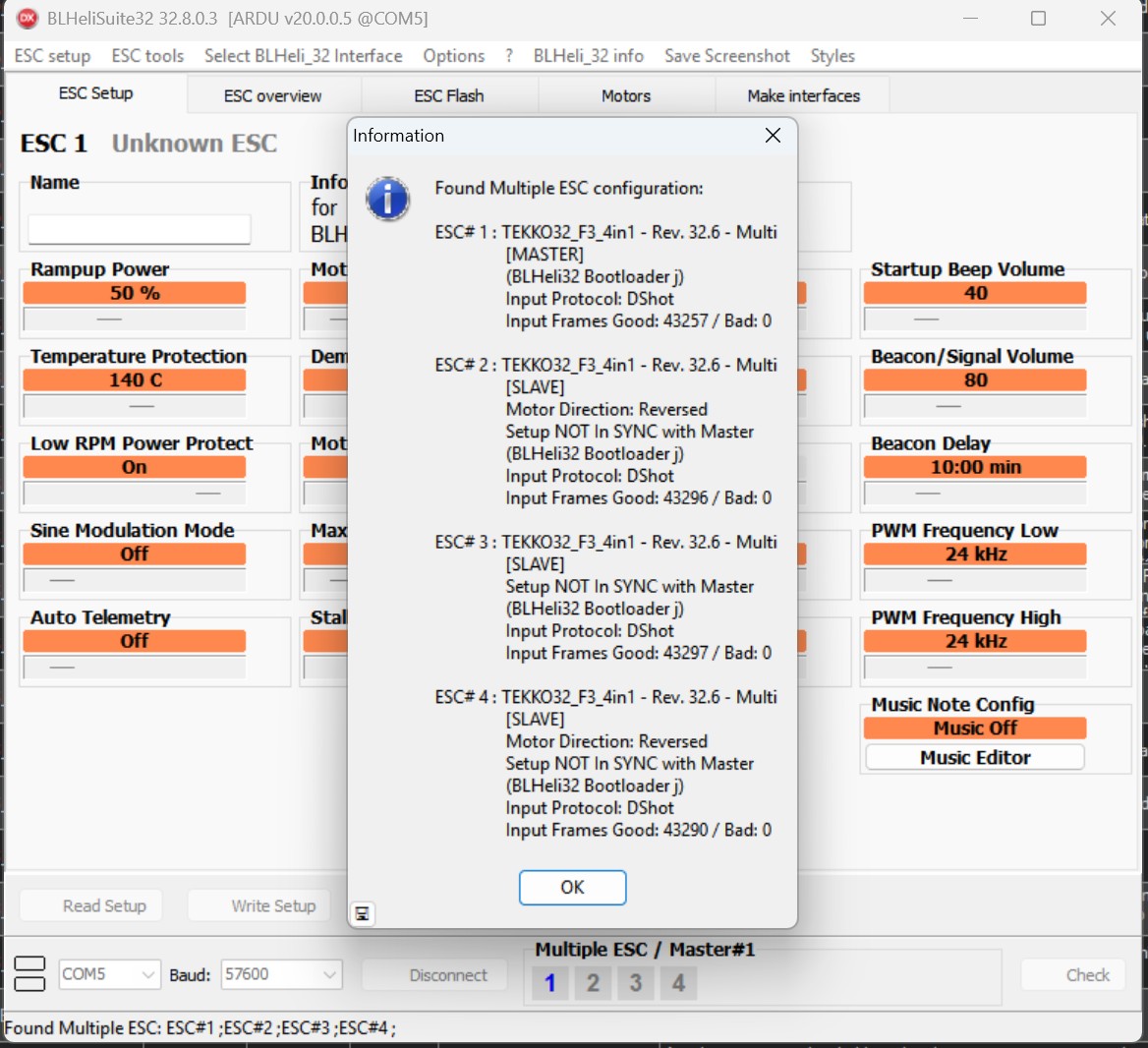

I’ve almost never used BLHeliSuite - so not sure what I am looking for, but here’s a screen grab.
Duh - I didn’t have power to the ESC’s…
Disable Low RPM Power Protect.

OK Dave - it appears that changing LOW RPM POWER PROTECT from ON to OFF has fixed the throttle issue - this is just from using MOTOR TEST - rpms above 40% are now actually higher and higher - I’ll go out later and try to actually take off.
