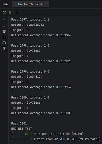

Hi All,
The new embedded ArduPilot neural‑net library is now successfully learning XOR inside SITL.
This confirms that the full forward‑pass, backprop, gradient flow, and weight‑update logic are working correctly in an embedded‑safe, fixed‑size implementation.
What’s needed next (for anyone who wants to continue the work)
  1. Weight persistence
    Add a mechanism to save trained weights from SITL and load them onboard during initialization.
    The library already exposes the weight structures; this is mostly a matter of serialization and a small loader.
  2. Scheduling inference
    Once weights are loaded, the network becomes a fixed function.
    Running feedForward() + getResults() at ~1 Hz is more than enough for initial testing.
  3. Feeding real sensor data
    Replace the XOR inputs with actual flight‑relevant features.
    The input size and layer sizes can be adjusted in AP_Neural_Config.h.
  4. Activation functions
    The current implementation uses tanh, which is fine for the toy model.
    For real turbulence or anomaly detection, experimenting with ReLU or leaky‑ReLU in the hidden layers would likely improve responsiveness to sharp sensor changes. It’s modular so you should be able to try without too much trouble.
Project Status
I’m moving on to another journey and won’t be continuing development myself, but the library is now in a solid, working state and ready for integration and onboard testing.
This work is based on Dave Miller’s original PC‑based neural net tutorial, adapted for ArduPilot’s embedded constraints, and co‑developed/reviewed with Microsoft Copilot.
