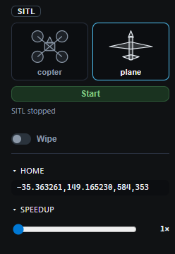

Windows or Linux x86_64 from release 1.1.0. SITL in the header → plane thumb → Start. It downloads official SITL and Links tcpout:127.0.0.1:5770.
SITL rail
