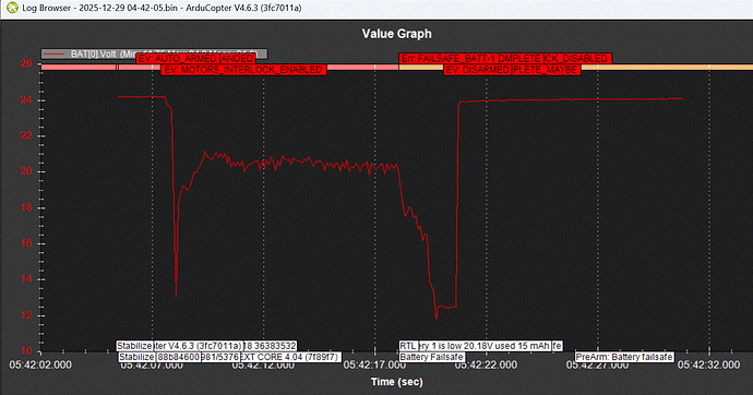

I charged it from 22.8V to 24.8V and took the aircraft out to the field. Power up was normal and armed okay after GPS lock. Takeoff was smooth and I was trying to get it to hover in Stabilize mode, but after about ten seconds and sank and landed. After taking it back home and revieing the log, I saw that the voltage dropped from 24.8 down to and below 19V which caused the battery failsafe to trigger:
Could this be a defective lipo pack?
A voltage drop of almost 5V?

Doesn’t look like it’s pulling many amps:

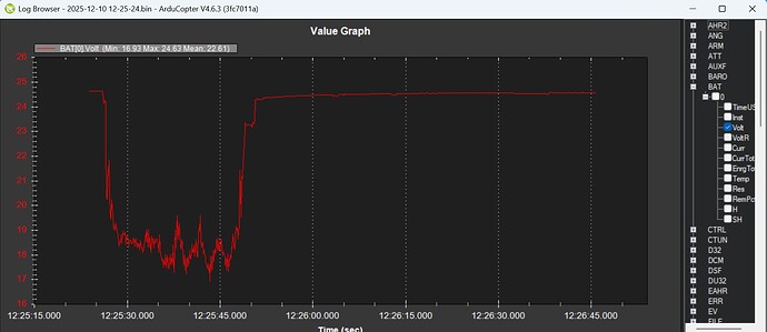

I just completed a static test. For comparison, here is the voltage graph when I tried flying in the field with the gimbal controller connected as well as the 5V going to the RC receiver:

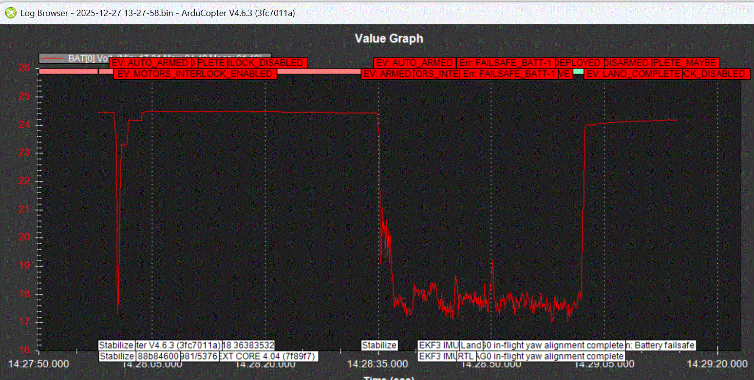

After running the static test with the quad weighted down:
The 5V BEC was not connected to the receiver, so all power was going to the motors from the PDB except 12V BEC going to the landing gear controller.
I Feel confident that the motors and ESCs are fine as well as the wiring. I’m beginning to suspect the power module.

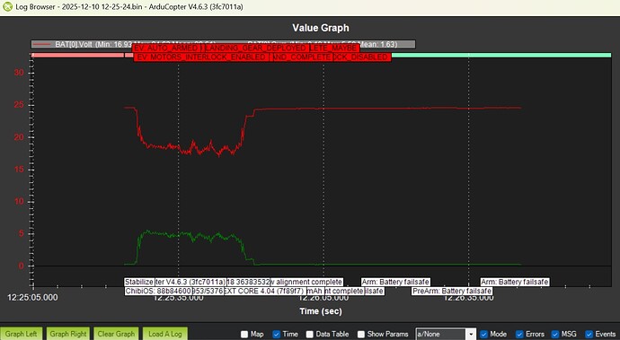

If you run static tests you can parralel measure the voltage on PDB IN and OUT.
Your pictures only shows voltage but no current so at the moment these pictures are not so informative
