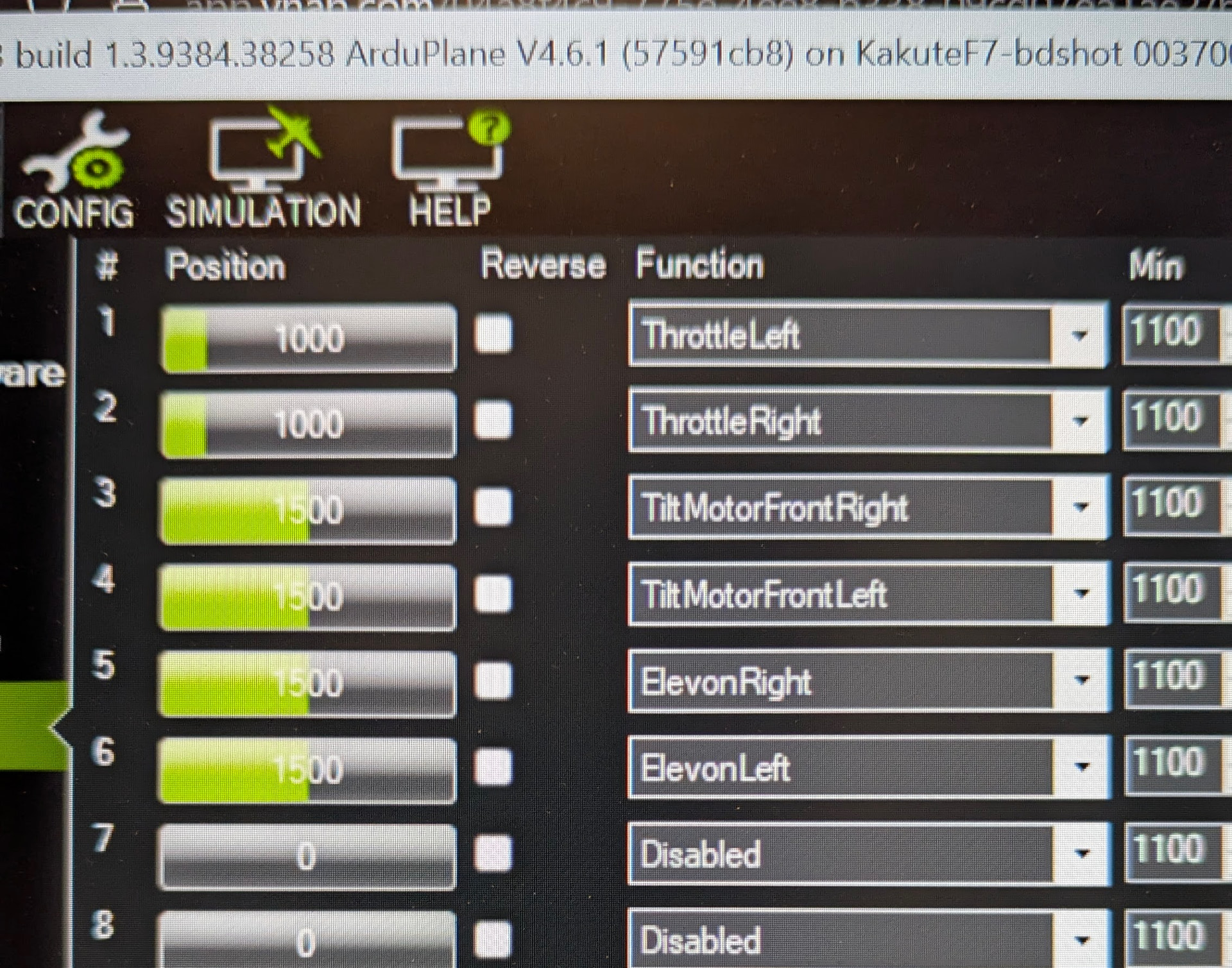

Everytime I reboot, Servo 3 and 4 change to TiltMotorFront (right/left)
I’ve tried a Pixhawk and a Kakute F7 - both on v4.6.3 (though oddly, Mission Planner keeps telling me a new version is available, and THEN says “no upgrade available”, which makes sense, cause I’m already on 4.6.3).
Anyway, I change servo 3 and 4 to disabled - but when I reboot, they are set to TiltMotorFront (right/left). Does it mattr they are like that?
I’m building a 2-motor tailsitter, non vectored.

You picture shows firmware 4.6.1 not 4.6.3.

That I actually have 4.6.1…
Yes very weird, even though I have 4.6.1 loaded (thanks for pointing that out), and even though Mission Planner prompts me with “New firmware available” - when I try to install, Mission Planner says:
”No need to upload, firmware already installed”. So THAT is weird.
And yes, I’ve changed the servo output both ways many times: by using the drop-down list on the servo GUI page, as well as by changing the values in the full parameter list.

OK - I downloaded v4.6.3 from:
And then did a “load custom firmware”. which did allow me to upgrade from 4.6.1 to 4.6.3.
And I still have the same issue - when I reboot, servo 3 and 4 (two outputs that I am not using, and repeatedly set to DISABLED), are re-set to:
TiltMotorFrontRight
TiltMotorFrontLeft
Two questions…
Why does this happen? And - can I ignore this error and fly successfully?

Tried 4.7 beta - same thing. So this error occurs now with 2 different flight controllers and several firmware version (including BD-shot and NON-BD-shot) - I went all the way back to 4.2.X(?) - same error (but I did not try the firmwares in between 4.2.x and 4.6.3.

IMHO, the reply is not satisfactory (God bless the devs…but) and the firmware is in fact dangerous. My apologies in advance if I’m missing something, but under the current state of the firmware, I believe an attempted take off would have resulted in a very quick CRASH, as I found out I need to change ANOTHER parameter (Q_TAILSIT_VHGAIN) to actually tell the flight controller that I do NOT have vectored motors.
