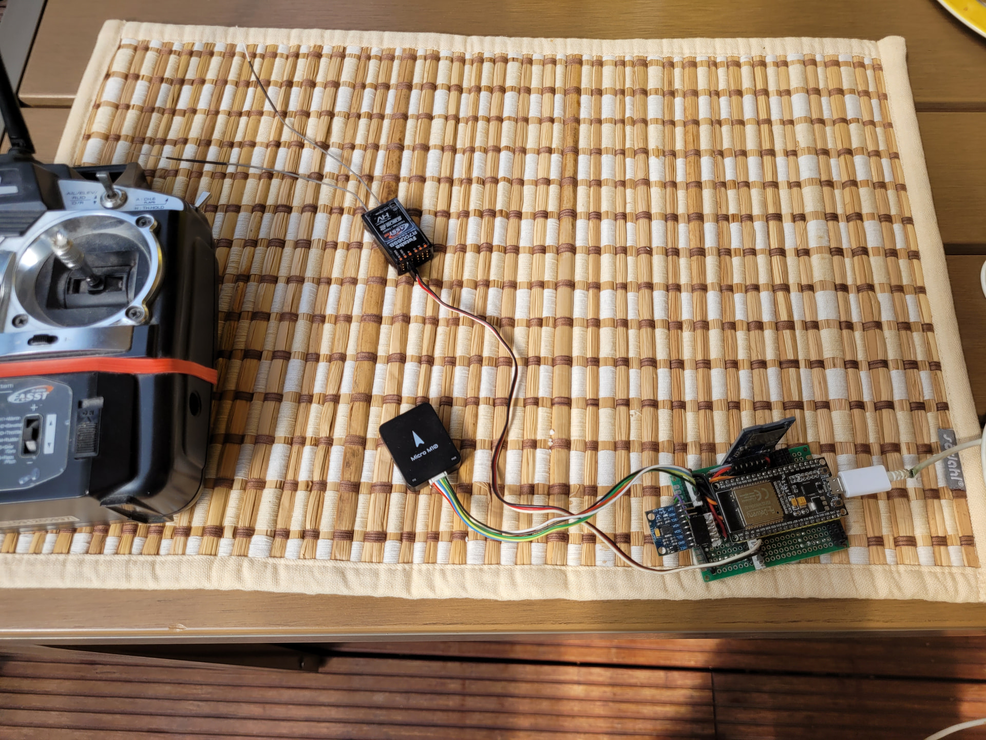

sorry, what state is this in at the moment, would your breadboard setup work to drive a rover in auto mode? i have replaced just about everything on my solar rover with esp32, so the only thing left is the flight controller.
I had read all about your project.
I didn’t testet my setup in an ardupilot auto mission yet as I used this setup with my own non ardupilut experimental code for an autonoumous rover.
But I am relative optimistic, that it will do the job if it is not a high speed rover. The loop rate on the ESP32 is lower as on the ST based flight controllers.
what do you mean lower? rover by default only runs at 50hz where aircraft run at 400hz.
Oh, I thought it is always 400hz on ST based FCs . Yes, the ESP32 rover firmware runs on 50hz
The only time 50hz has been an issue on rover for me is with high speed lidars and dshot.
I am using only standard PWM output for the ESC and I didn’t tried lidars.
Not sure if Ardupilot FW need a 3 dimensional position for an auto mission. My setup has only the hight information from GPS which is not always the best. No Baro
have you tried switching it to auto to see if it tries to move?
No, I didn’t, but I can reasample the platform back to my test car and check it.
I think I will try this within the next couple of days if this is ok for you

Today I was able to create with my (stationary) rover setup a small logfile.
logfile
Hello @geofrancis
did you checked my last logfile?’
This shows that the ESP32 FC tries to turn and speedup in direction to the waypoint if I switch from Manual to Auto.
But there are still some big questionmark regarding running indefinitely.
