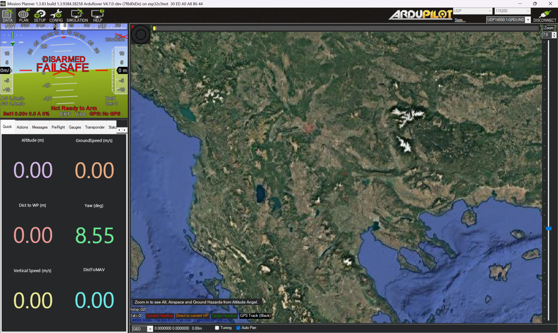

am use it but it move in pitch ,roll direction good only yaw wrong am change in param (AHRS_ORIENTATION) to yaw 270 but after change pitch be wrong
this is imu funcation am use
#-----INS/IMU-----
#define HAL_INS_DEFAULT HAL_INS_NONE
define HAL_INS_MPU6500_NAME “mpu6500”
define HAL_INS_DEFAULT HAL_INS_MPU6500_I2C
define HAL_INS_MPU6500_I2C_BUS 0
define HAL_INS_MPU6500_I2C_ADDR (0x68)
IMU Invensense I2C:0:0x68 ROTATION_NONE
define INS_MAX_INSTANCES 3 # only here for binary identicality
the problem is me have miss understand about roll and yaw :sweat_smile:
am determine the mpu work good

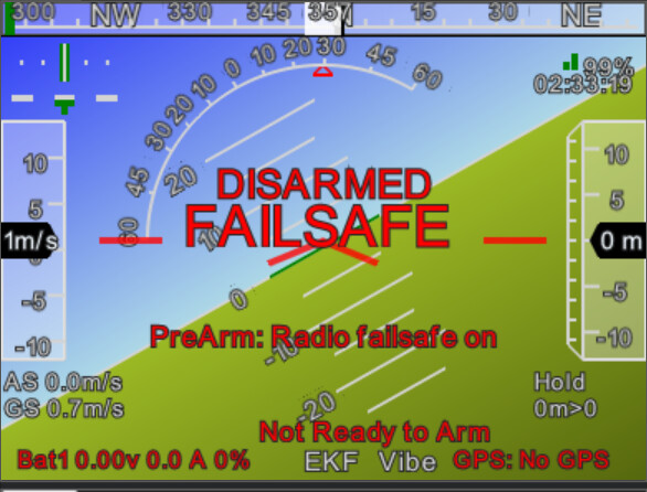

my miss understand come from when roll to right am see horizon in fligh data move to left like this
am determine this is right and work good
The AHRS_ORIENTATION is the right parameter to adapt your MPU6500 torientation to the frame axises of your drone.
As the ESP32S3 module has no fixed connection to the MPU and I don’t know how you want to mount all the modules I selected always as default ROTATION NONE. But this value will be over written bei the AHRS_ORIENTATION.
So you have to select the correct combination out of all possibilities.
If you roll your drone to the right the horizon goes left down, that is correct.
If you pitch your drone up the horizon goes down (more blue less green)
If you yaw your drone right the dirction numbers in topline goes to left.

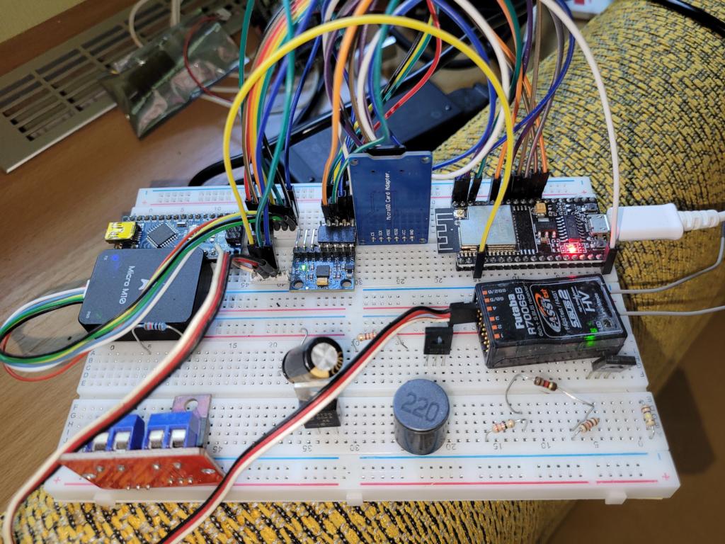

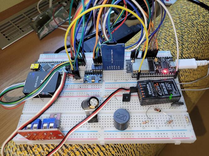

update 1 : am do some test my setup is fc put on breadboard after some search am determine the problem come from breadboard when ap work some times not work good (mean am connect but it like happen in above disconnect after 10minute )
or some times not see ap without am hold my finger in metal part in module esp32
the problem is breadboard absorb the signal from esp thats translate to me as ap not see in wifi list or see and connect but slow or like happen above
i will do some test am tell what happen next :flexed_biceps:
update 2: am do tests by udp by connect to ap(ardupilot123) and if am do disconnect and reconnect in about times 10 to 20 minutes it work and connect with no problem
but if am connect and leave it without touch about 30 minute to 1 hour is do disconnect or still connect but is freeze to solve this must do disconnect from mission and disconnect ap and reconnect ap again and reconnect mission again it work without need to do power cycle

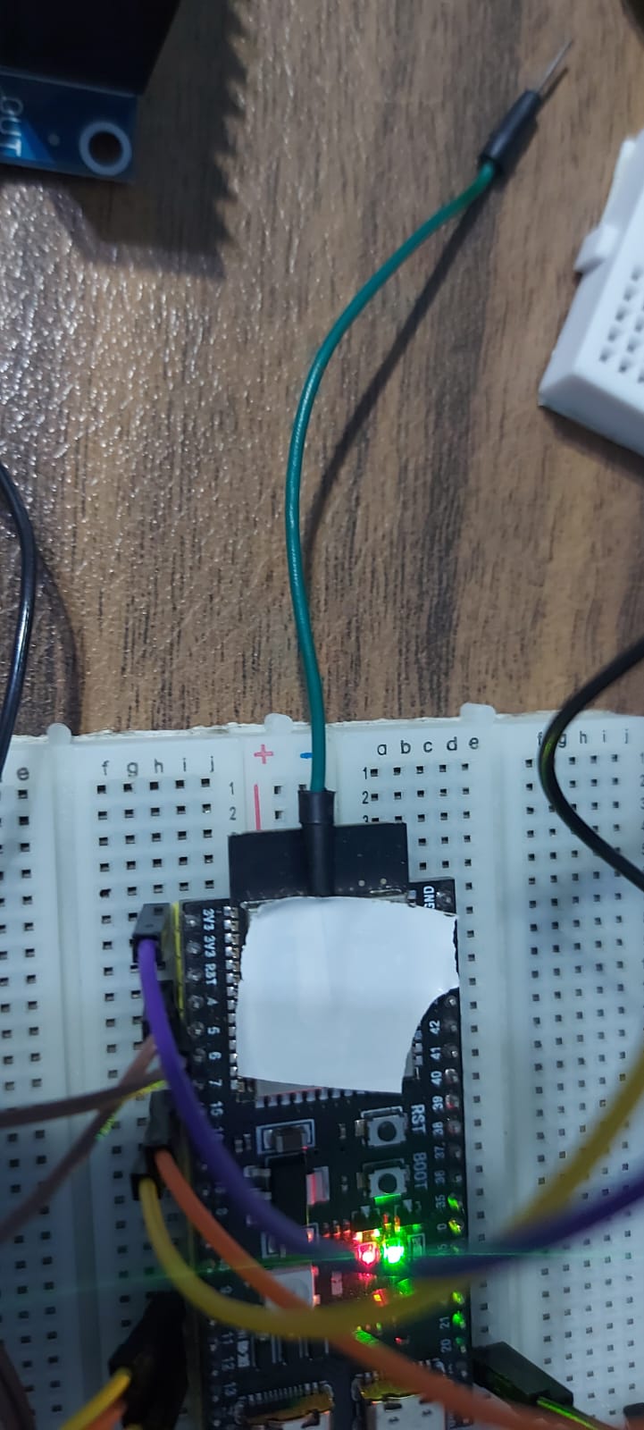

and to solve problem some lag in ap because breadboard absorb signal am try to put wire in metal part in module and it work
i hope when put fc in pcb by solder pin header and put fc on it solve problem of absorb signal :palms_up_together:

am determine problem
first am set devboard on breadboard when am supply am not see network ardupilot because signal absorb by sheet aluminum in breadboard to solve am put wire on rf shield in module am see network and connect :partying_face:
update thing not said
in above reply to you am said it work but not work good this haapen because am not put wire in rf shield , in first test before put wire some time ap see and some time hide because problem of absorb signal

My quick setup looks nearly like yours, but i don’t have any problem with RF absorbtion by the breadboard. Inhouse range over 2 floors and walls about 15m.
The metallcase is a shielding connected with ground and not to the RF. Maybe you can place your module a little up to the first row.
