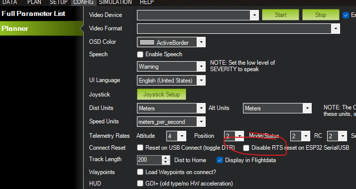

check this in planner setup
am try and still failed / i have question if am not connect any peripheral like (GPs, Mpu,etc) and only upload firmware to esp32 and try connect to mission planner only connect can this happen to failed to connect to mission planner??

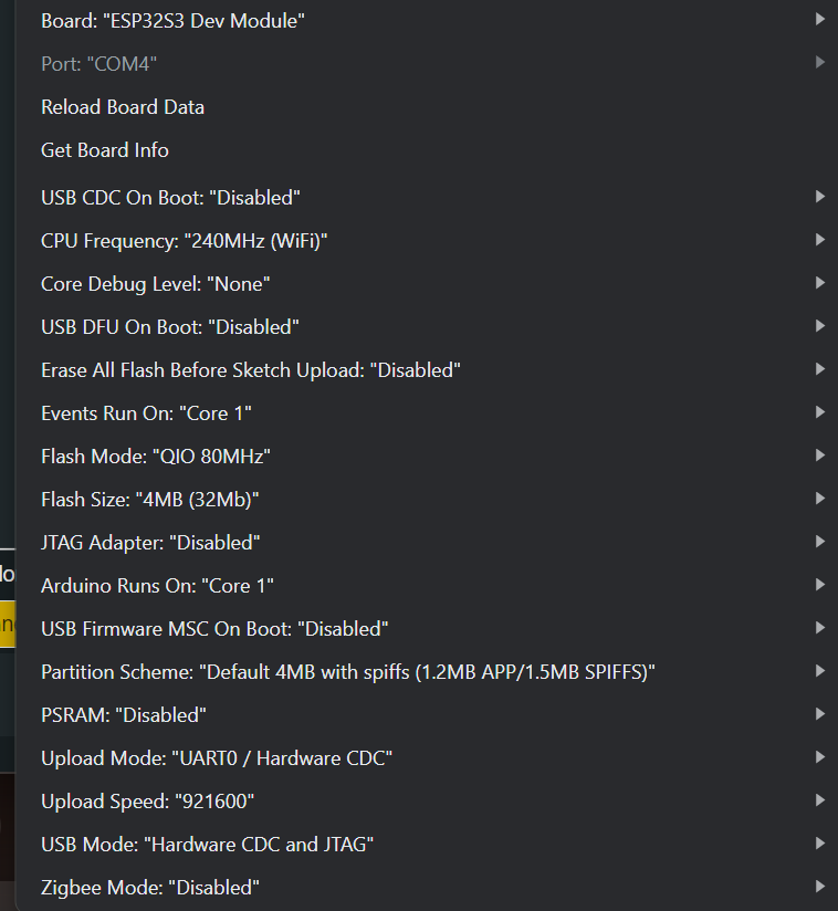

ESP32S3 Dev Module
on COM4
(this is am see in arduino serial )

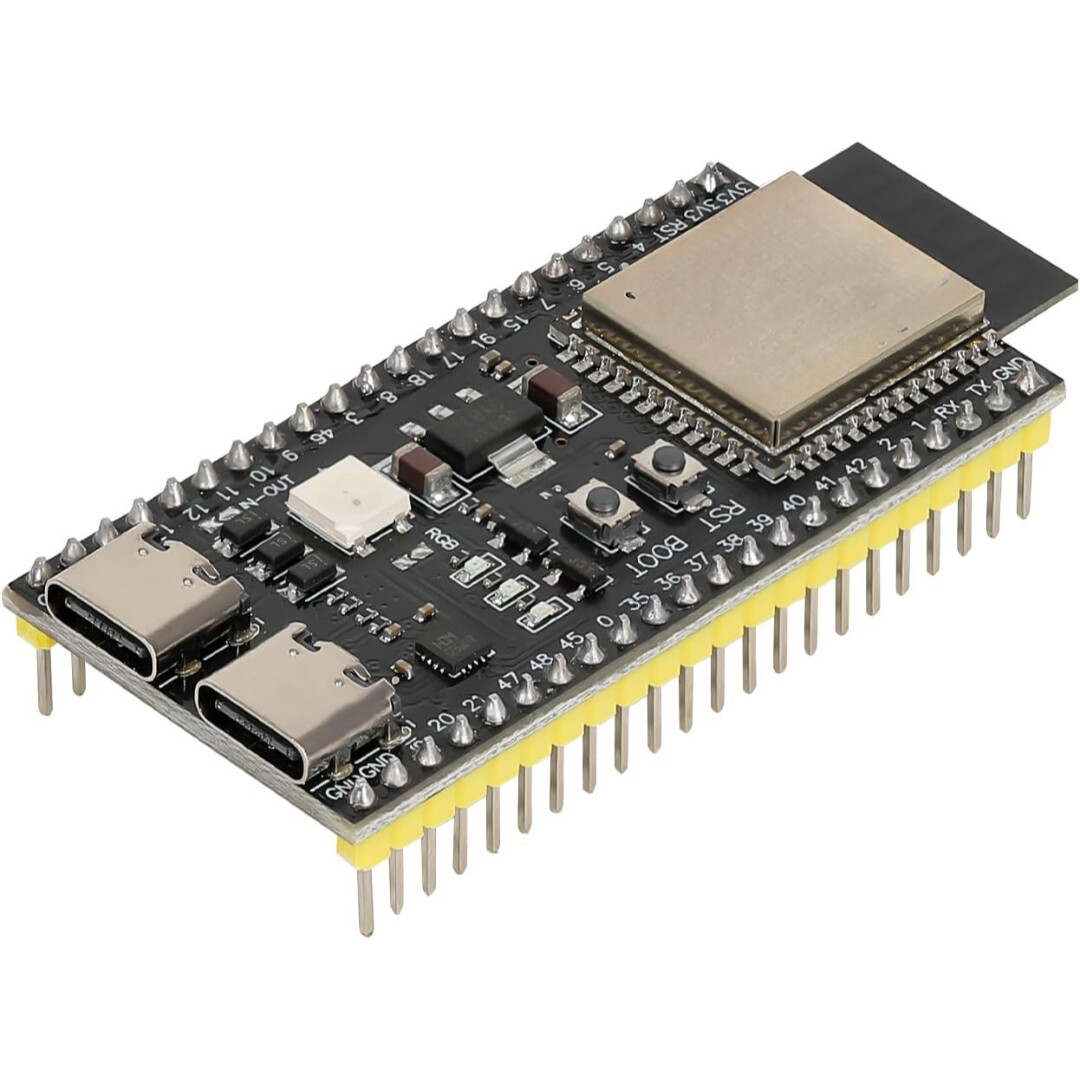

am attach photo of my board your board shape like this ??

your esp wroom is like this , if yes you use which name of board when configure firmware

Again I don’t think that it has something to do with original or clone modules. Mine is like the second version shown by you but not as shown on the picture with CP210x USB chip but with CH340 USB chip.

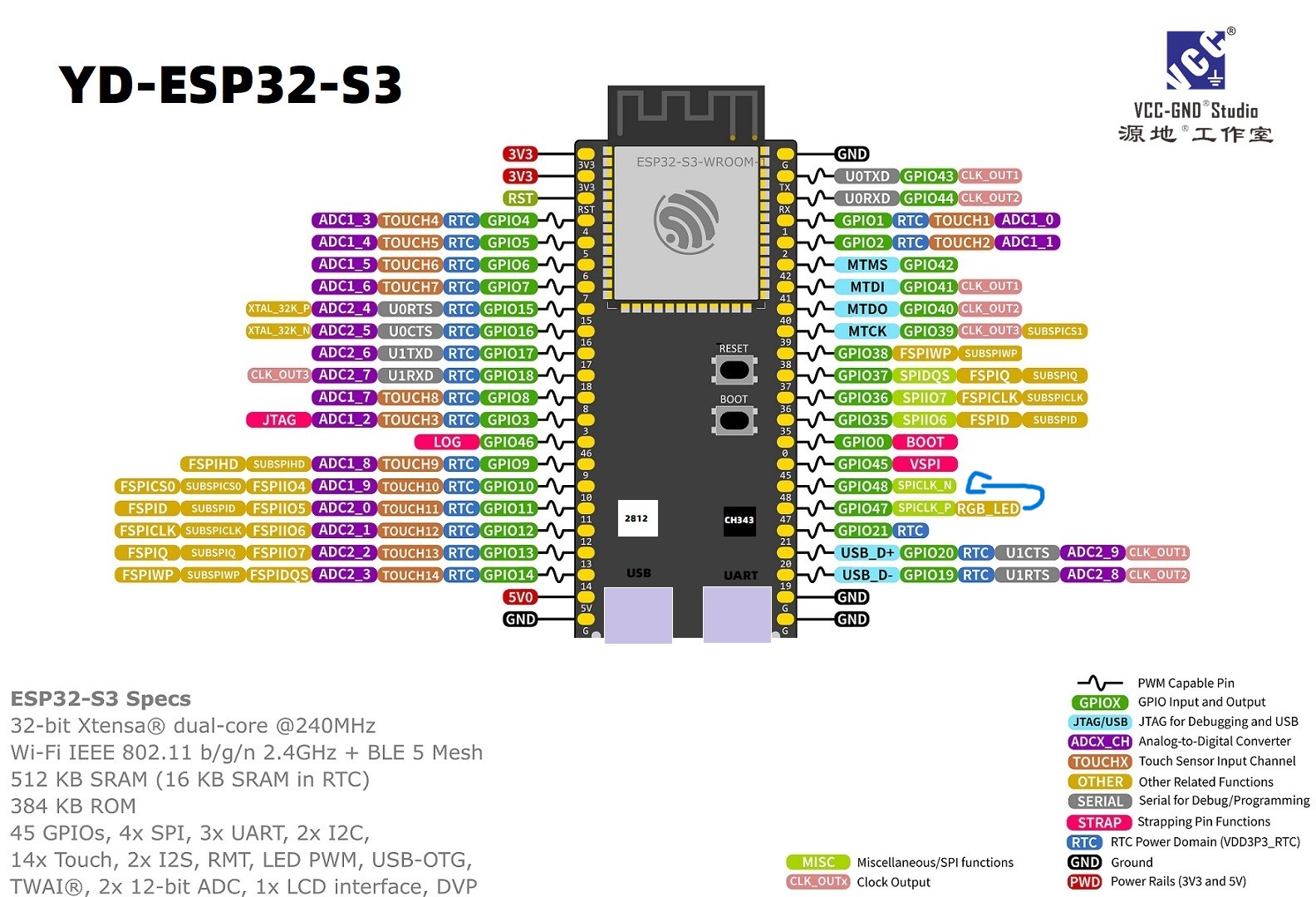

Can you send again the exact version of your ESP32S3 Devkit. Normally all information is shown on the shielding of the ESP32 module. I have seen some discrepancies of available GPIOs.

My board: (ESP32-S3-N16R8) Esp32s3devkit c (clone version ) my search am find the pin mapping is same like original one
