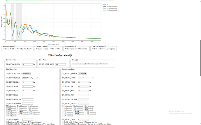

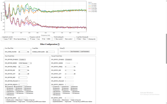

I’m trying to set up notch filter for my 15inch quad copter.
FC is micoair743v2
ESCs are bidirectional Bluejay dshot so I decided to go with ESC telemetry notch filtering for the first time.
Motors : Tarot MT4008 kv330
Props : 15inch foldable
Battery : 6s Liion 8000mah (960g)
Flight log
I tried to find out what value should go in the INS_HNTCH_FREQ, BW but am not really sure whether 50 and 30 are right values for them.
Is INS_HNTCH_FREQ possible to be found out in the graph or do I need to somehow calculate it utilizing ESC RPM average? If it were throttle based notch, I would confidently put 55 in there but is it same when it is ESC telemetry based notch?
Also, why do I see that many harmonics in the graph? Does it indicate any vibration on frame or arms? Do I need set up 2nd/3rd harmonics or use second notch filter in this case?
I’d appreciate if anyone can give me an example notch setting for my copter based on the log file. I’m planning to apply mutisource and update at loop rate option later if it is OK and practical to do so.
Thank you for taking the time to read and explain this. Also, any suggestion to improve the system is welcomed.

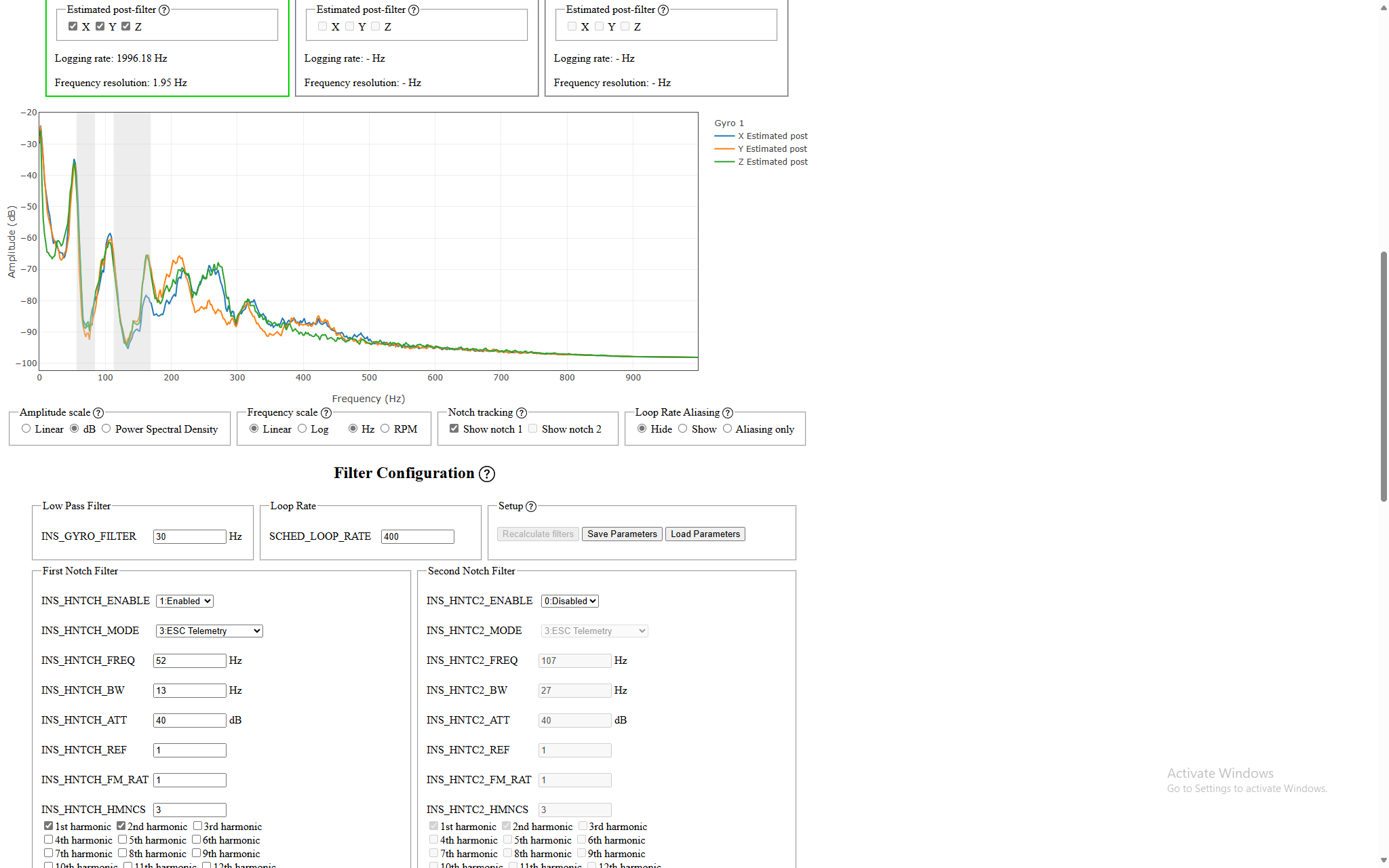

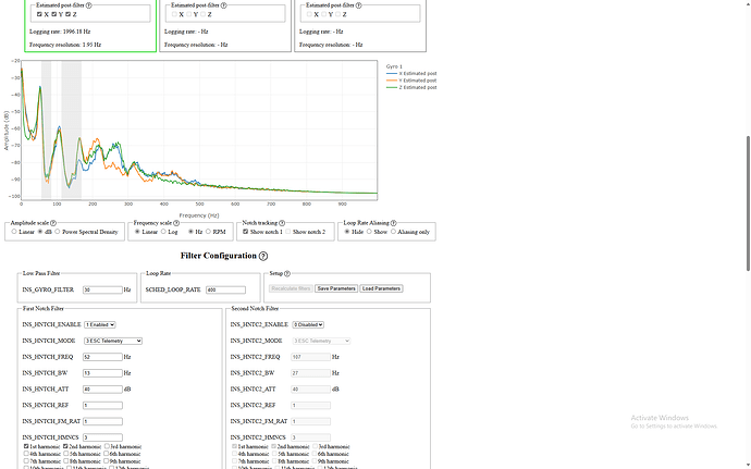

Use Estimated Post Filter. Check the Show Notch 1 box. Does the notch band align with the peaks? No? Why not? Perhaps the default Pole number for those motors is not correct?
Thanks for your advice.
I found pole number was 18 so I adjusted the param and flied it once again after reseting notch params into default.
Flight LOG
After changing pole number into 18, it still didn’t show much different graph. I can’t tell notch band align with peaks for sure.
Is there any part I missed?
or Is this better than the previous setting? The graph seems almost same.

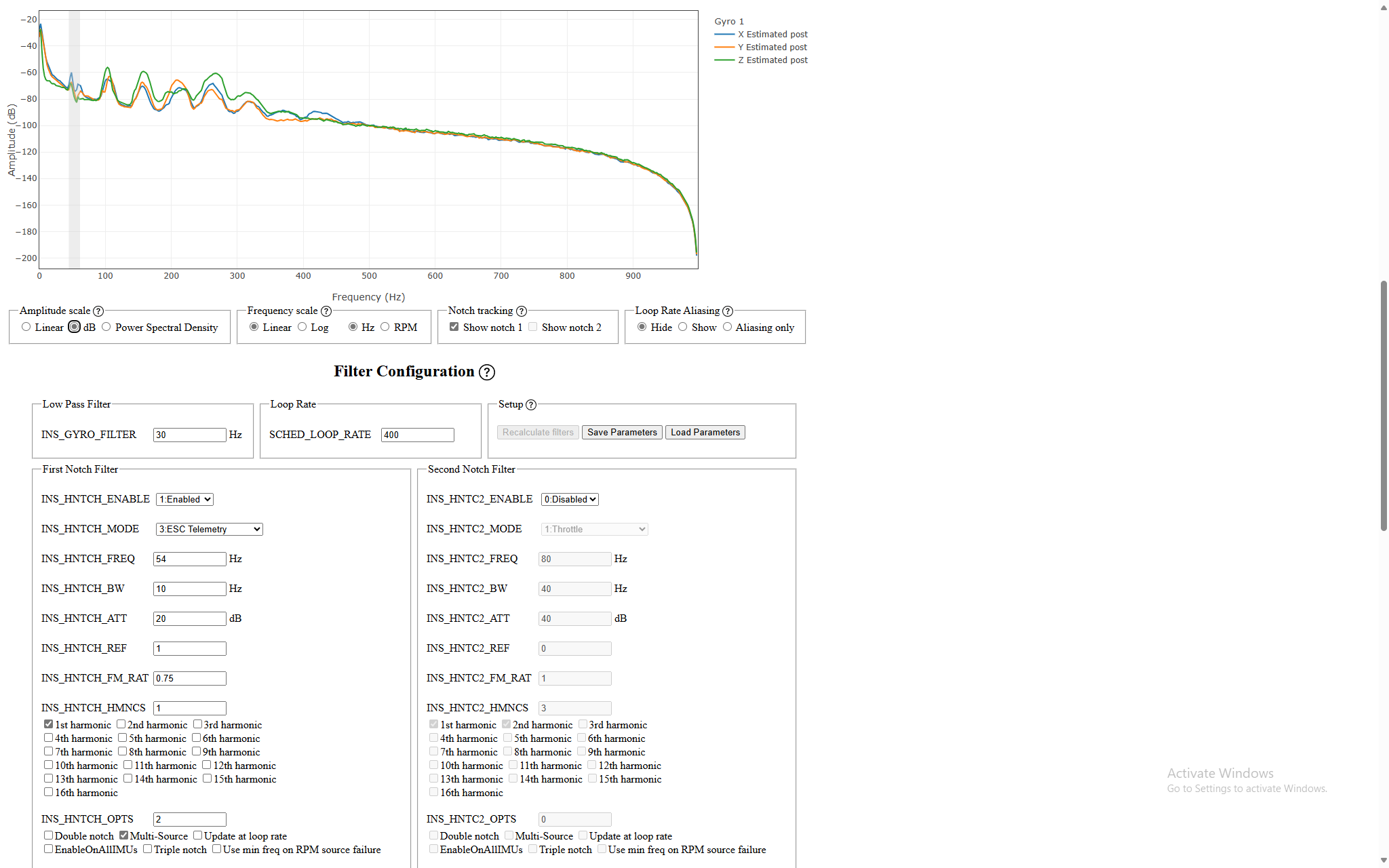

That’s not what I found.
Motor pole number: 24P
Sorry, It seems I got it completely wrong. I counted something right next to the coil not the magnets on motor cap. Yes, there were 24 poles when I just counted.
Thanks for pointing it out. I will give it a try again.

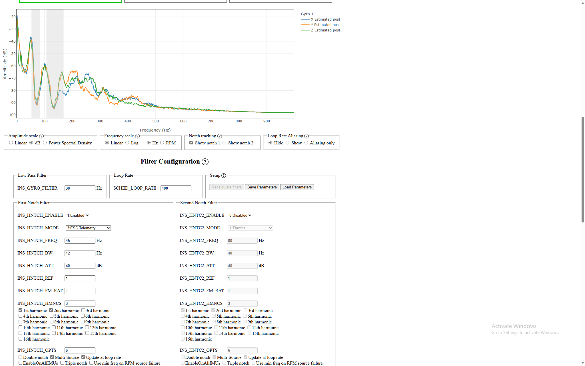

Instead of batch logging use Raw Log for that flight controller. It has an Sd card right? If not keep it configured as you have it.
set these:
INS_LOG_BAT_MASK,0
INS_LOG_BAT_OPT,0
INS_RAW_LOG_OPT,9
Thank you. I will fly it again after reseting notch params and those 3 params tomorrow.
Yes, there is a SD card.
I had a test flight with those params set as you asked to.
Flight log
Thanks for your time.
This looks effective with estimated post-filter. Give it a fly and check it out.

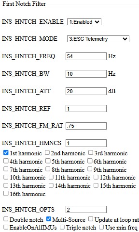

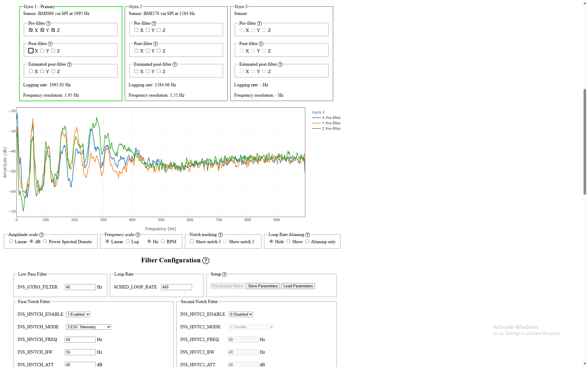

Hi dkemxr,
Here is the Flight log with the notch setting you adviced.
To me, the graph seems great with all peaks lower than -60.
What do you think of the result?

Looks good! Disable Raw Logging once the filter parameters are set or you will have some huge log files.
And BTW-That is only useful on higher performance processors (H743, etc) with a Sd card. Slow dog’s like F405’s, all SpeedyBee’s for example, will choke.
