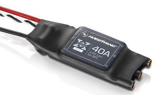

A friend of mine is having trouble with ESC calibration during the drone build process. The radio transmitter he’s using is a FlySky i6X, and the ESCs are from the HobbyWing X-Rotor series.
While trying the standard Pixhawk ESC calibration method, we ran into the following issue: when we connect the battery for the second time and press the safety switch (the switch stays solid red), we hear a long “beeeep” sound. However, the throttle does not reach its maximum value. When we checked the ESC datasheet, we saw that it lists “Throttle Range Calibration” followed by “ESC Calibration” steps. At this point, we got a bit confused. Isn’t the purpose of ESC calibration already to calibrate these values? If so, why is the throttle calibrated first under a separate heading?
Or could this problem be unrelated to that and caused by something else? I’d appreciate any help in solving the issue. I’m sharing the relevant datasheet and PDF files attached. PDF File

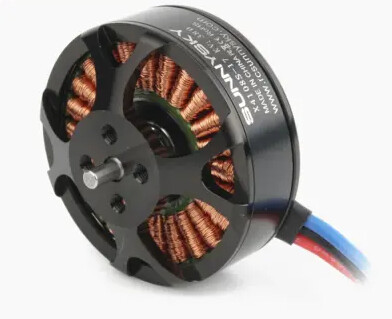

You’re right, Masayuki — I missed that detail. We’re using the X-Rotor 40A series. The motor brand is Sunnysky X4108S 480 KV.

Dear forum members, I forwarded your suggestions and what was written here to him, and I got a response today. He told me he had solved the problem, and I asked him how he did it. He said, ‘I plugged the ESC inputs into the Pixhawk backwards.’
