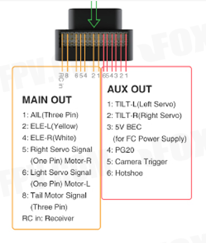

Second, I have my servo outputs as per this diagram of pixhawk. Currently I have 1100 as my pwm minimum and 1900 as the maximum for motor 1,2,4.
Do I need to assign Throttle to channel 3 of servo output as I have many tilt rotors have that assigned?

No !
