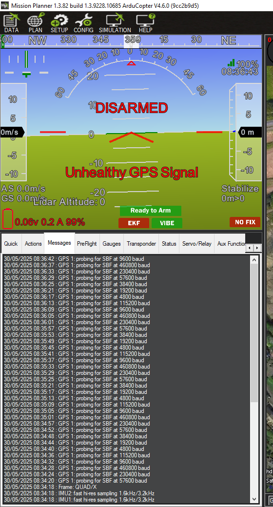

I am trying to setup a holybro Mosaic-H on a Cubepilot Orange+, but I am not having any joy!
I followed the instructions on this setup page, but the main LED is not coming on, and mission planner is pushing an endless stream of ‘probing for SBF at xxxx baud’ and cycling through all the available baudrates. It’s also showing 'Unhealthy GPS signal in the HUD, but I’m getting ‘No Fix’ instead of ‘No GPS’ so I presume the GPS is communicating somehow…
I have collected a disarmed log:

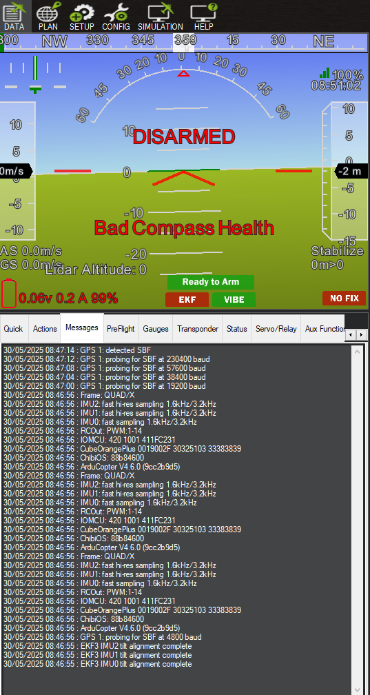

I also downgraded back to 4.5.7 and didn’t have any joy with this setup either… Although the error was slightly different in that it said ‘detected SBF at xxxx baud’ instead of ‘probing’.
Any help appreciated, looking forward to testing 4.6.0
After rebooting and trying a couple more times it managed to detect the GPS… I will try and take it to a better location to get a fix and report back.
