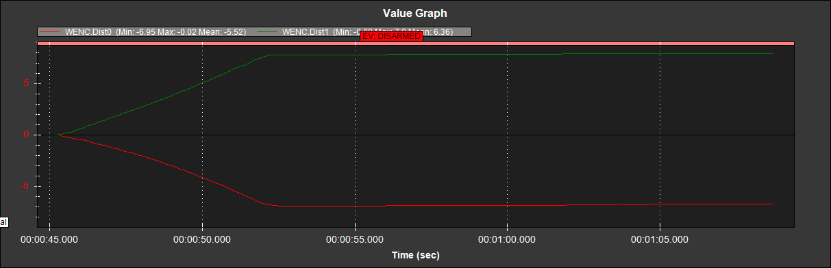

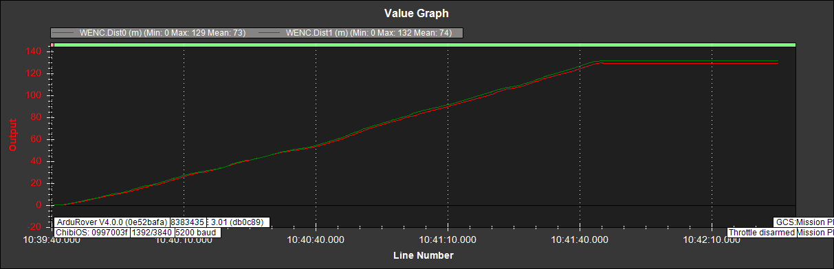

For adjustment and checking I prefer to move the vehicle a fixed distance (say 10m), which can be done manually without slipping, and check distances of each wheel on MP (down to cm precision). You should see this:
(ideally straights if speed is constant).
For CCW pivoting (possible on balance bot or tank, difficult on car):
See that left wheel (red) distance is negative, and right wheel distance (green) is positive (opposite for CW pivoting). For correct results, wheel distances to center must be correct (with correct signs).
