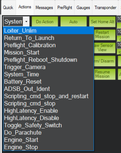

Melroy_Cordeiro:
dakefpv h743
On FC’s with flash memory that emulate an Sd card it has to be formatted. I don’t know if that’s true for that board. In those cases set the backend type to 4 and in Mission Planners Action Menu use the pulldown next to the Do Action button and set it for Format Sd Card and give it a try.
As soon as I set backend type to 4, I get the config error I mentioned above.
The actions drop does not show a Format SD card option.

Update Mission Planner to latest Beta and it will.
Thanks, that appears now.
I still get similar errors, with the formatting failed.
