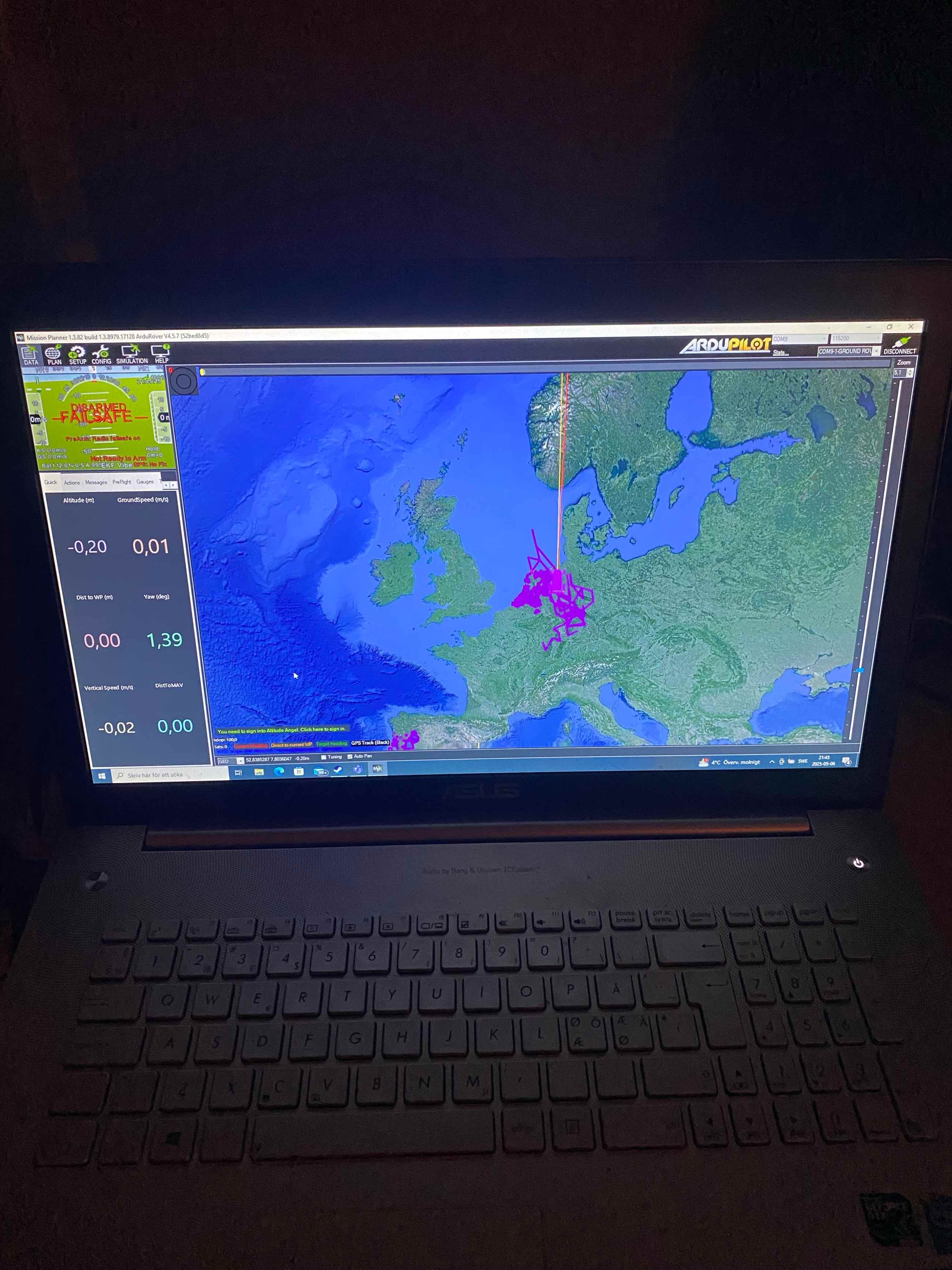

and followed to the point where I can’t connect, rx tx configured and binded. Can not connect via USB which is strange. Can connect with wifi but the final connection to ardupilot timeout

when you’re connected to the drone by USB can you see radio inputs in Mission Planner?

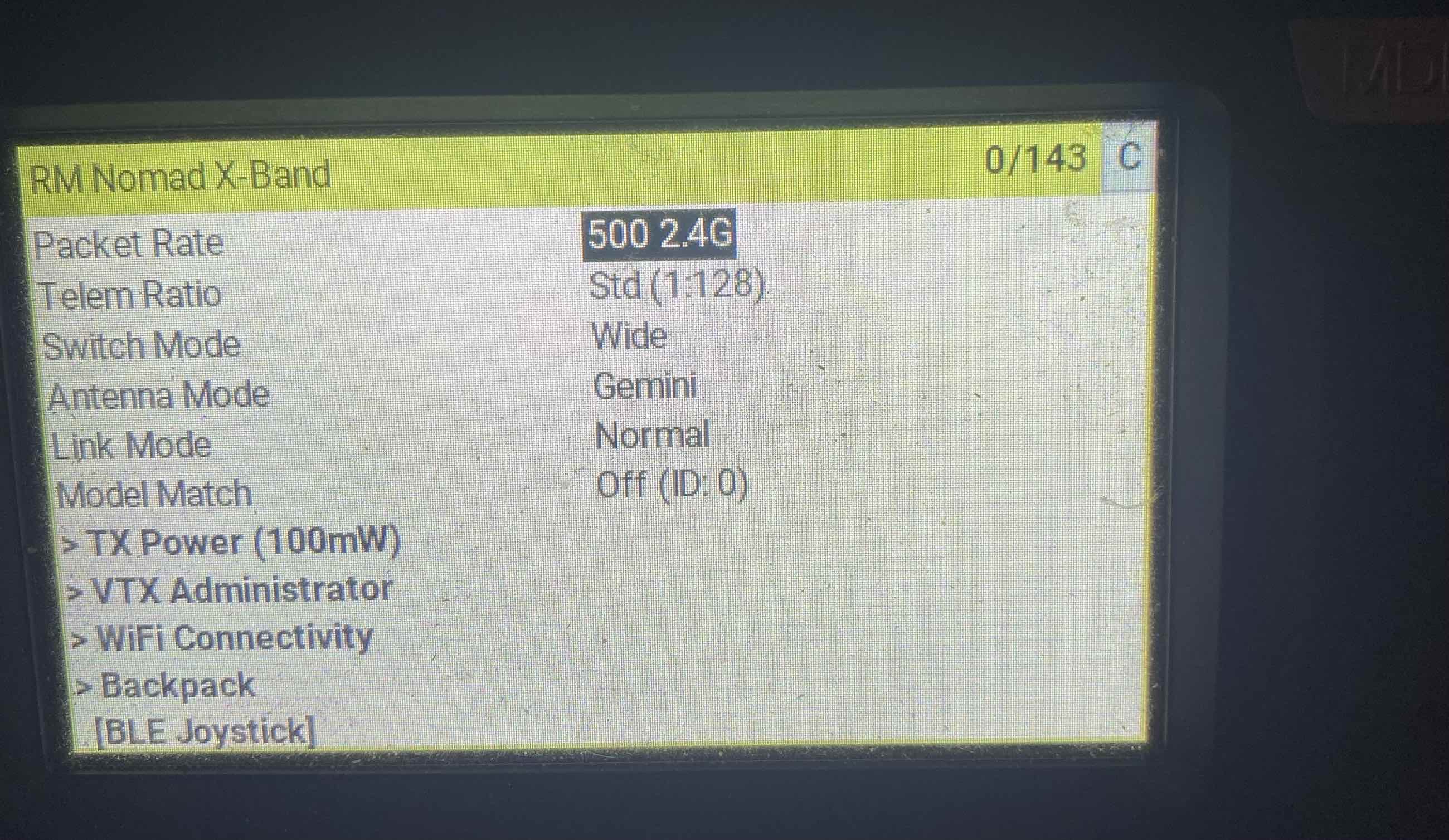

Totally new to this want RC and telemetry in 1, bought nomad. Yes usb to module but no com port come up in device manager, tried vía wifi but only backpack show up see picture, should I update?

Post a picture of the Lua Script when the radio is connected to the drone.

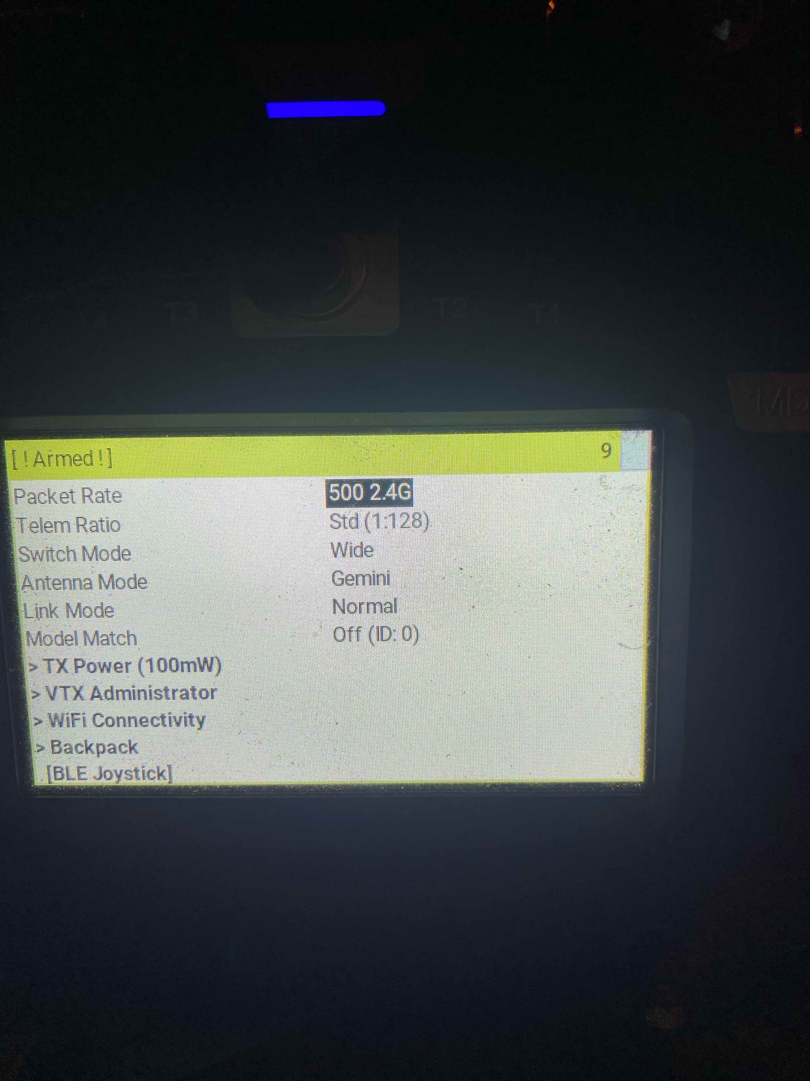

This lua script screen, say connected and get radio inputs even if they are bit delayed.

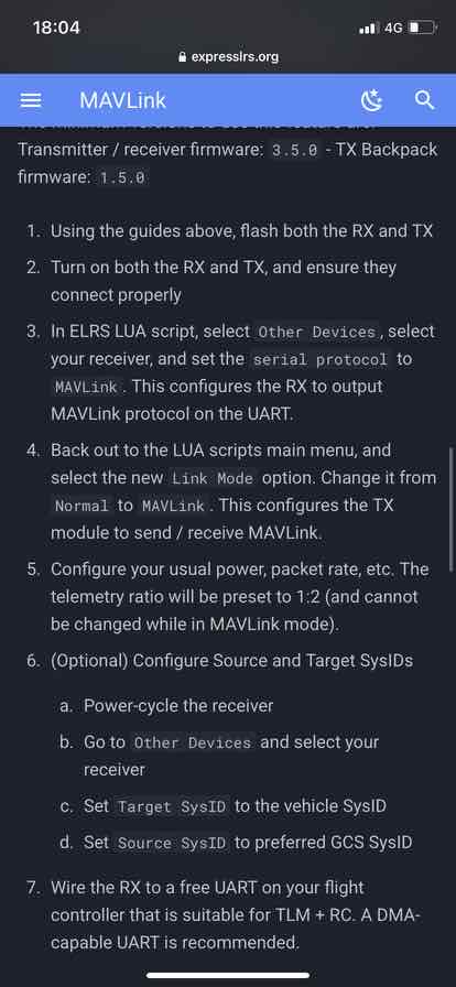

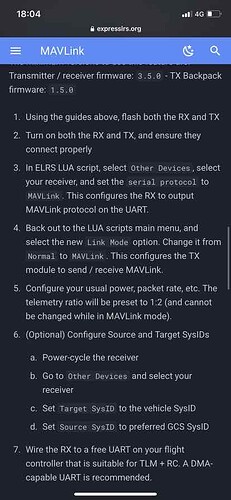

You need to follow these instructions. The radio is not setup for Mavlink, I see you still have it in normal mode.
Thanks is this the instructions? Can’t find other device the lua, is the full lua installed or how do install full?
It will only be there when you’re connected to the receiver. You’ll need to scroll down to find it. There is only one Lua script, but make sure you are using the most recent one.
