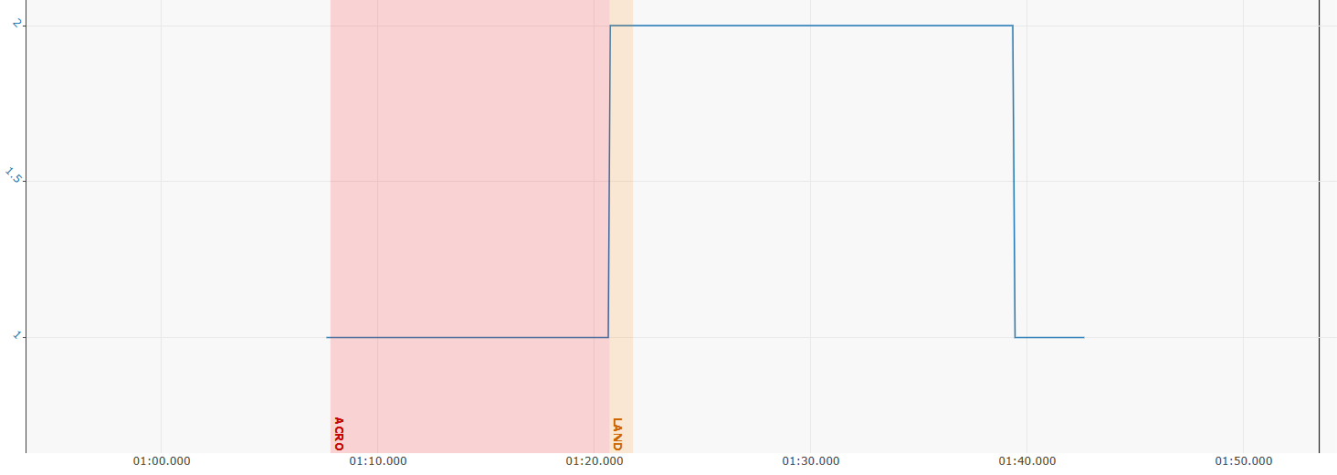

Please post a .bin log file.
.bin file, using wetransfer: Unique Download Link | WeTransfer

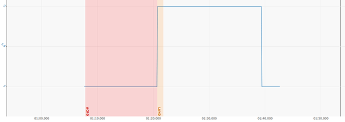

while making the log file ( props off, system outdoor, arm & spin up, transmitter off ), I think RTL did work… the drone increased throttle, then decreased throttle, then stopped motors. That looks good to me
So RTL may work, but my testing by using mission planner and looking at the messages in the hud display may be the issue…
The flight mode field switches to ''RTL" while using a channel to switch to flightmode rtl, but I do not see a flightmode change when I switch off the transmitter… So perhaps that got me confused.
If that is it, thanks for the help already :slight_smile:
Boris

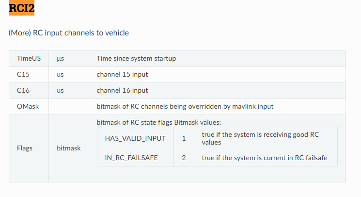

IIRC if the copter considers itself landed the RC failsafe action is to immediately disarm. Log shows detection of RC Failsafe condition.
RCI2.Flags:
If the copter is disarmed, no failsafe will take place.
If the copter is armed but has landed, the copter will immediately disarm.
If the copter is armed in Stabilize or Acro modes, and the throttle input is at minimum, the copter will immediately disarm.
Otherwise, the copter will take the actions as configured in the parameters described below.
Hello Lupus,
Thanks for the RC12.Flags way to check for rc failsafe, that would have been useful for me to know ( and now I do ).
Boris
