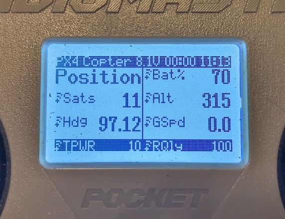

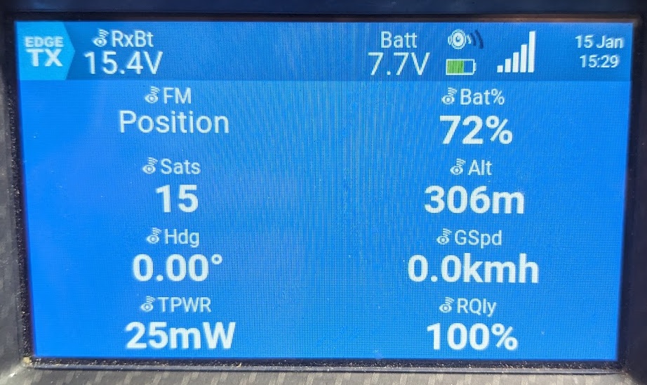

One thing I’ve started doing is using a Widget page with ELRS telemetry values that show ELRS status values. These are things not captured by Yaapu or Ardupilot. It’s helpful to have visibility to these values.
I use both ArduPilot and PX4, and I started using this approach because of PX4 telemetry limitations. But it works on either system.
Note the transmission power (TPWR) display.
Arming ExpressLRS is required to get full dynamic or user-set power from the transmitter. It resides solely on the handheld, hence the reason you can now optionally just assign a switch rather than a switch + channel.
