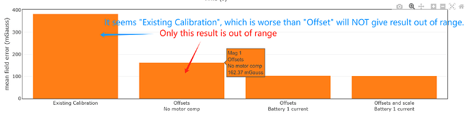

@xfacta What calibration method are you using. As if you check below
Then I got Z =580 (out of range, Why magfit's output result is out of parameter range? - #24 by lida2003). The curve are much more close to expected.

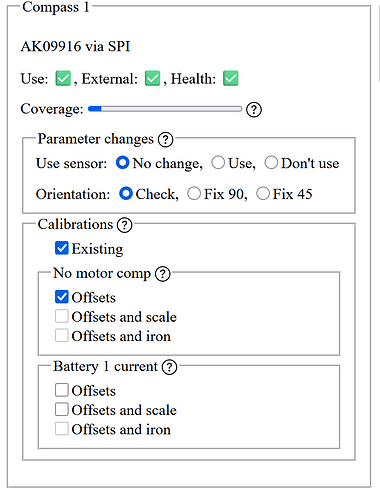

In magfit, you scroll down to the bottom of the page, in the bar-graph section you will see which bar is the lowest (best calibration) which is Battery1 Current/Offset+Scale for yours, then scroll back to the top and deselect all calibrations except the good one from the graphs.
Then you “save” that calibration, which gives you the text file you can apply.
You can try different selections to see how that match the expected calibration in the X/Y/Z line graphs.

Further more, I have checked this data with offsets, but it’s outof range even if “Existing Calibration” has large MFE than “offset”.
Is this mean “No motor comp offset” method is more likely out of range?
But why not use the calibrations I gave (or from Battery1 Current/Offset+Scale) ?
@xfacta It’s OK for @KATKAM_SHIVASAI .
I don’t have current monitor, which leave me no choice. But the result is out of range which can’t be put in MP, as ardupilot doesn’t accept it.
So I’m asking if the “No motor comp offset” method is more likely out of range?
