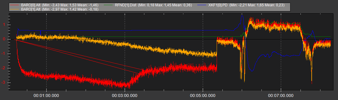

I am currently trying different combinations of settings and noticed a few mistakes on my side:
  • In the previous figure, I plotted VD instead of PD. The correct plot is below. Ideally, the green graph (PD) should be mirrored in comparison to the red line with a small offset of 0.17m). It deviates from that, especially at the beginning and at the end (at low altitudes). That and the minimum range of range finder 1 being 65cm makes it plausible, that actually only the first range finder is used (like some of you told me too). It would be unfortunate to have the hardware to cover the whole range from 0m to 60m and being limited by ardupilot. I will do some more testing…
  • By default, surface tracking was activated (SURFTRAK_MODE was 1) which is not recommended to be used together with fusing the range finder into the EKF (according to the warning here). I am not sure, whether it actually helped in the situation at the end of the plot, where the height estimate was so bad. But that would mean, that the surface tracking used the second range finder, which seems unlikely to me. Does someone have an explanation, why the drone kept the height so well (in PosHold) at the end, despite the height estimation being bad.

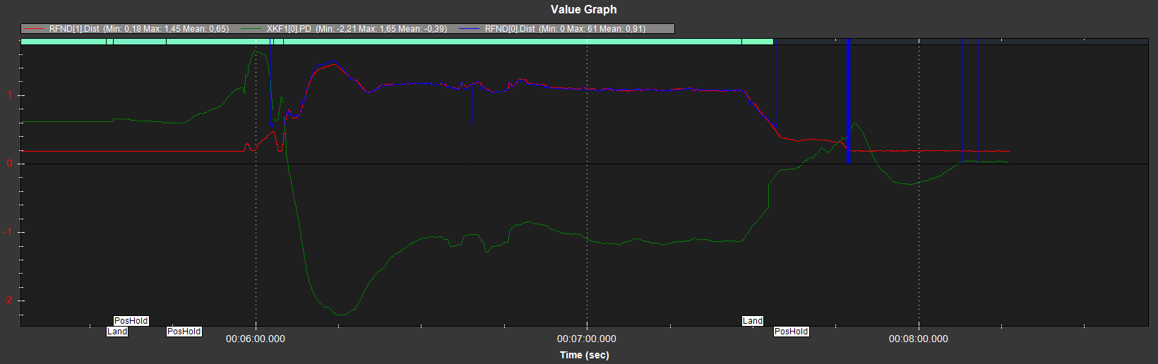

I just noticed EK3_GND_EFF_DZ (currently set to 4). Regarding the following plot: At about time = 6 sec the estimated negative height (XKF1[0].PD blue line) increases. Shouldn’t EK3_GND_EFF_DZ = 4 prevent that, since both barometer altitudes (red and yellow) don’t exceed -4m?
