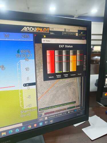

I’m currently working on a Vision-Inertial Odometry (VIO) setup and facing an EKF velocity variance error that I’m unable to resolve.
Hardware setup:
  • Flight controller: Pixhawk 2.4.8
  • Companion computer: Raspberry Pi 5
  • Camera: Raspberry Pi Camera Module 3
  • Connection: Pi ↔ Pixhawk via UART (TELEM port)
Software / setup details:
  • VIO running on Raspberry Pi 5 (providing vision position + velocity)
  • Vision data sent to Pixhawk via MAVLink
  • EKF configured to use vision position and velocity
  • GPS disabled (indoor testing)

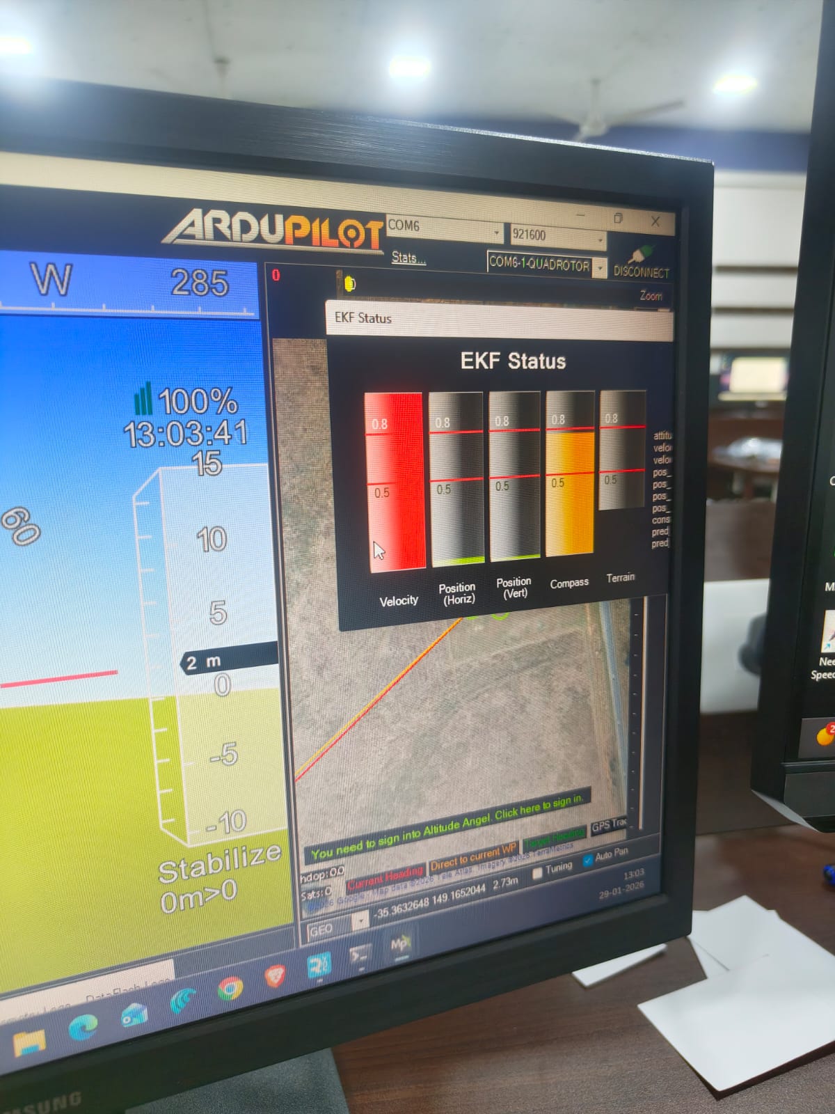

  • During operation, EKF throws velocity variance errors, and sometimes EKF fails or triggers failsafe
Observed behavior:
  • VIO estimates (position & velocity) look stable on the companion computer
  • Drone sometimes arms and takes off
  • After switching modes (e.g., Stabilize → PosHold/Loiter), thrust drops or EKF fails
  • Issue is inconsistent (works ~1/10 times)
What I’ve checked so far:
  • EKF parameters set as per documentation (EK3_SRC1_POSXY / VELXY / POSZ)
  • Vision data rate is stable
  • No obvious timestamp issues on the Pi side
  • Default failsafe parameters (no major changes)
Questions:
  1. What typically causes EKF velocity variance when using VIO?
  2. Are there recommended EKF or VIO noise parameters for vision-only navigation?
  3. Any known timing, scaling, or frame-alignment issues with Raspberry Pi 5 + Pi Cam 3?
  4. Is Pixhawk 2.4.8 limiting EKF performance for VIO use cases?
Any guidance, parameter suggestions, or logs you’d like me to share would be really appreciated.
