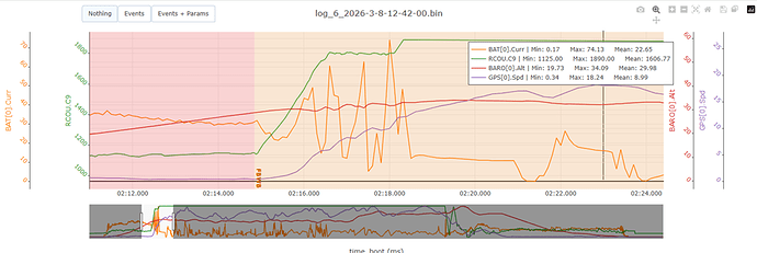

I’m having a problem with a VTOL (2 tilt motors, 1 tail motor). The aircraft flies perfectly in hover and fixed-wing modes. However, during the transition, the motor control oscillates, and I have no idea what’s causing it:
In the screenshot, the current line is shown in orange to represent the motor control.
Once the switch to fixed-wing mode is complete, the oscillation in motor power disappears and the motors are controlled correctly.
I would be grateful if someone could give me a tip on which parameters influence this behavior.
Attached is a link to the log for the experts.

Furthermore, I still can’t find a clear answer to the question of why the left engine (RCOU.C3) and the right engine (RCOU.C4) are “throttling up” more or less evenly and then throttling back down during the transition or in the phase where the aircraft is accelerating to reach minimum airspeed. If they had to compensate for yaw, they would have to “throttle up” in opposite directions to counteract the rotational movement. But my initial question was about this “throttling up.”
Do you have any idea?

If you mean throttling up continuosly, that happens because initially, the motors tilt forward, so they have to divide power between lifting and forward thrust, increasing overall power. After a short while, when the plane gains speed, the wing begins to generate lift and the hover power decreases.
You’re absolutely right. I have to apologize - I linked the wrong file, which is why we were talking past each other. I was already wondering about that. The file I uploaded and that you analyzed is much older and was created before Qwick-Tune. Here is the correct file, which is also the one the image above refers to.
Interestingly, you can clearly see how Qwick-Tune improves PID control.
My original question and the screenshot above refer to this file.
