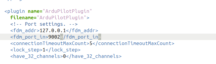

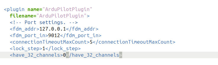

I have added the second aircraft to the Gazebo environment by creating a copy of the model and increasing its communication port by 10. The first aircraft connects and flies without issues. However, when I connect the second aircraft, the first one immediately falls.
I suspect the connections are interfering with each other, but I’m not sure how to properly configure them to run independently. I can share the SDF files for both aircraft so you can take a look. I would really appreciate your guidance on how to set up multiple aircraft in Gazebo without conflicts.

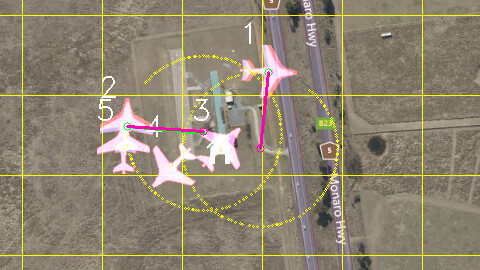

Thank you for the suggestion. I have tested it, and everything works fine without Gazebo using the following command:
sim_vehicle.py -v Plane --map --console --count 5 --auto-sysid --location CMAC --auto-offset-line 90,10 --mcast
However, this command uses the default Plane model, not the mini_talon_vtail. I haven’t added the mini_talon_vtail aircraft yet. Could you guide me on how to include mini_talon_vtail in the SITL simulation alongside the other planes?
Great! To run two Gazebo planes set --count 2 and add -f gazebo-zephyr --model json to the sim_vehicle.py option list.
The Gazebo world will need to include two zephyr models that have been named differently and with the ports set to 9002 and 9012 respectively.

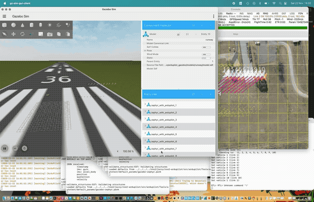

@Ahmet_Demir1 - I’ve looked into this a little further and multi-zephyr sims in Gazebo are possible, but needed a little work.
plane-swarmx10_trim_480p
The following patches are needed:
The example is run using the following steps:

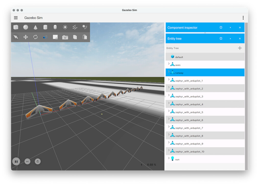

  • Make 10 copies of the zephyr_with_ardupilot model in ardupilot_gazebo and name the folders zephyr_with_ardupilot_1, zephyr_with_ardupilot_2, …, zephyr_with_ardupilot_10.
  • Edit each model and set <model name="zephyr_with_ardupilot_{n}"> etc.
  • Edit each model and set <fdm_port_in>90{n-1}2</fdm_port_in>
  • Edit the zephyr_runway.sdf world and add entries for each model:
    <include>
      <uri>model://zephyr_with_ardupilot_{n}</uri>
      <pose degrees="true">{2*(n - 1)} 0 0.422 -90 0 180</pose>
    </include>
Run Gazebo and check that the 10 planes are lined up along the x-axis
Start sim_vehicle.py
sim_vehicle.py --debug -v Plane -f gazebo-zephyr --model json --count 10 --auto-sysid --location CMAC --auto-offset-line 90,2 --console --map
Note the patches above will need to be applied to ardupilot and mavproxy first.
Once all the SITL instances have started (there will be 10 terminal windows, one for each SITL instance), adjust some parameters to make it easier to see the planes in a single screen.
For n = 1, … 10
vehicle {n}
param set WP_LOITER_RAD 20
param set RTL_ALTITUDE 10
Then
alllinks mode FBWA
alllinks arm throttle
alllinks rc 2 1600
alllinks rc 3 1800
alllinks mode rtl
This will arm and launch the planes in FBWA with a slight climb. The mode switch to RTL should put them in a loiter about home with a radius 20m
