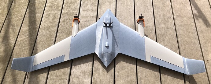

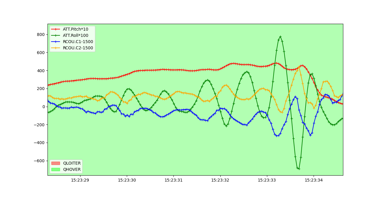

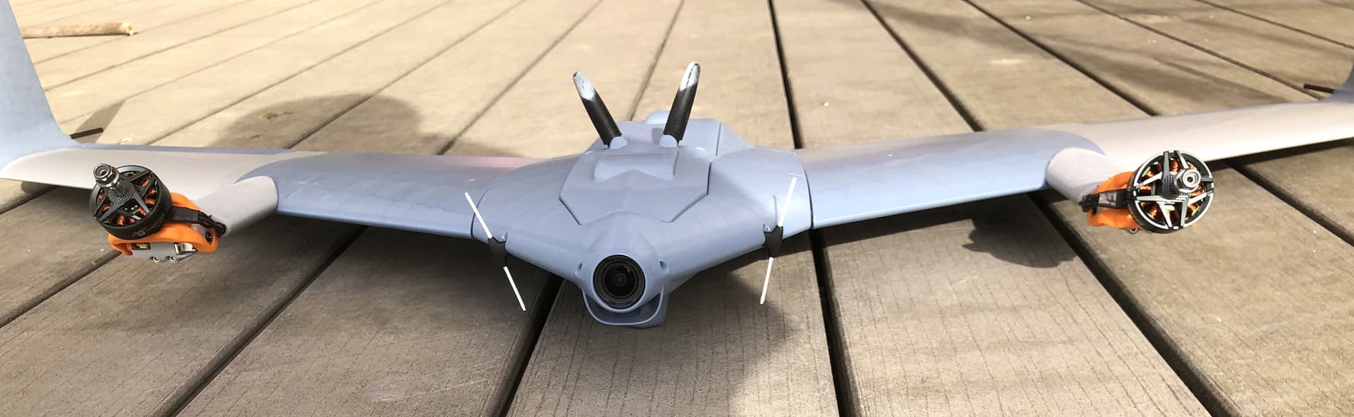

I am working since a while on a 3D printed fast TVBS (Kakute F743 Wing, T-MotorF90 2806.5 KV1950,GEMFAN 6x45x3). This results in Q_M_THST_HOVER 0.46 @ 20A with 6S. Design goal is to have a fast FPV TVBS with >200km/h. The frame is very stiff with two carbon-bars going through the wings. The overall weight with a 3300mAh Lipo is 1.6kg. It flies in horizontal mode stable (tested up to 140km/h yet).
It is flying well in QHover & Qloiter and I even did some transitions to horizontal. When doing a transition I encounter strong roll oscillations which can be easily reproduced by flying with high pitch angles (see picture for Qloiter & Qhover & bin below).
Unfortunately the QuickTune lua fails: (QAUTOTUNE - VTOL autotune for quadplanes - #148 by warp2)
https://www.swisstransfer.com/d/e7db7a30-b76e-48fa-b48a-03efe4d3447f
Does anyone have any recommendation how to tune the mentioned roll oscillation in transition?

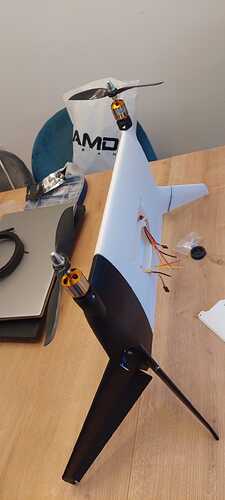

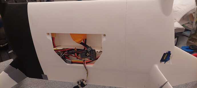

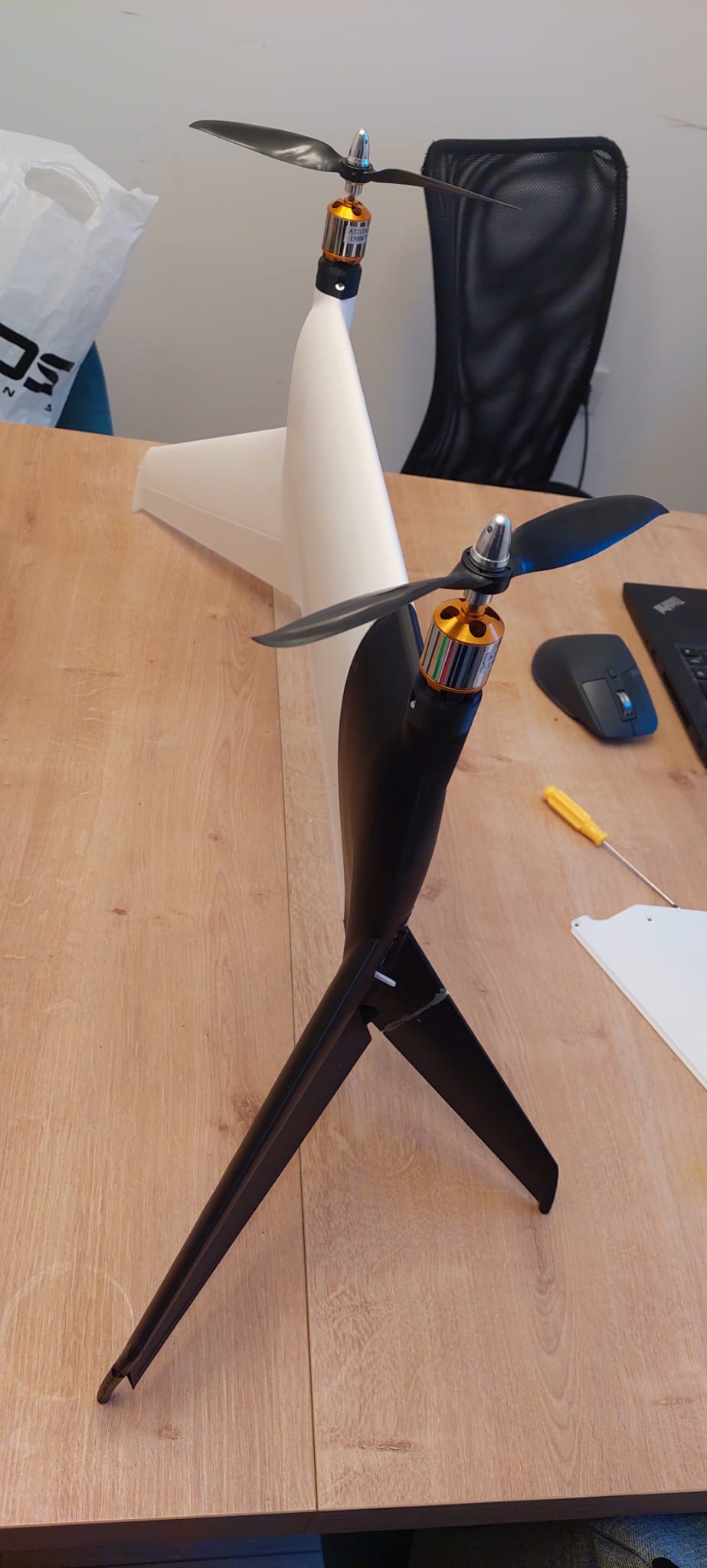

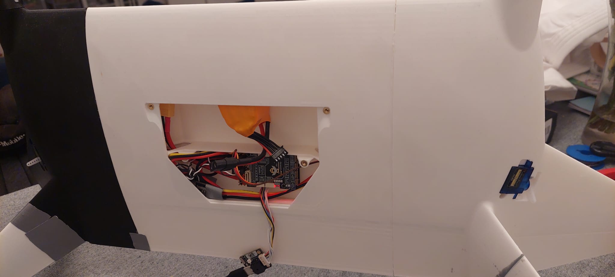

I am not sure if everything is set right, first try to set ardupilot or any fc setup.

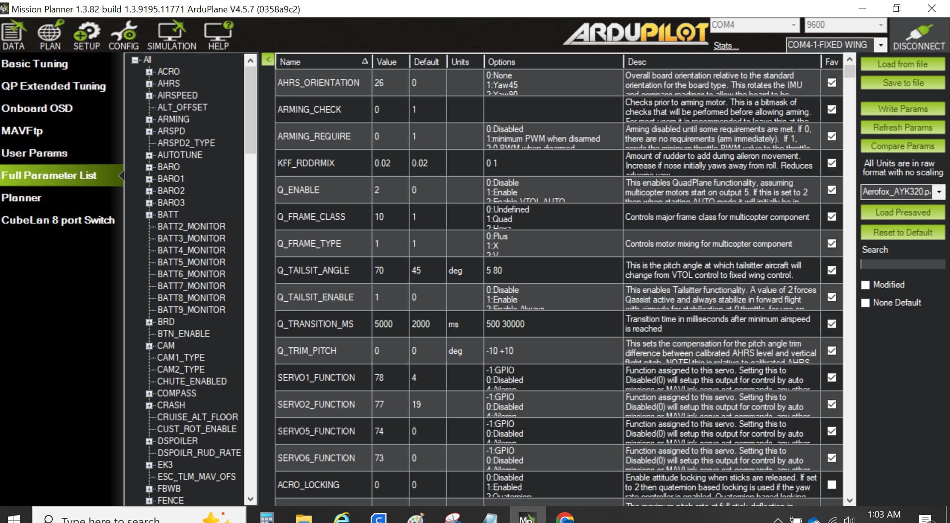

Servo response looks OK when plane is leveled, but when in hover position, servos dont act right.
Also, motors are always off (unless I give them a spin), shouldn’t they stabilise with differential thrust?
I like it. One thing is if you have issues you can add more flap surface.
Thanks, sure if needed I can do that, but first I have to set up ardupilot right :slight_smile:
