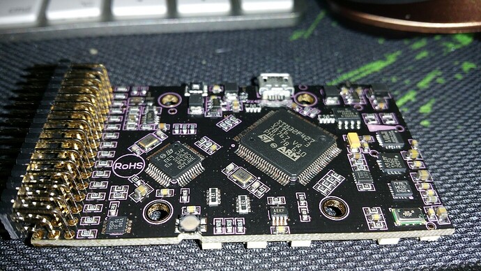

Not that it matters but the 2.4.8’s are not clones as there was never an official one to clone from. It’s a component cost reduced version of the 2.4.6 relabeled as a 2.4.8 so it sounds like a upgrade.
Did all 2.4.8s use F103? Or did the early ones use F100? By the way my 2.4.8 has the MS5611 baro
Oh okay, I have done this multiple times to recover from the soft-bricked state caused by the dshot fw update without realising that it also updated the bootloader. So I guess the Message log will show 0 0 only

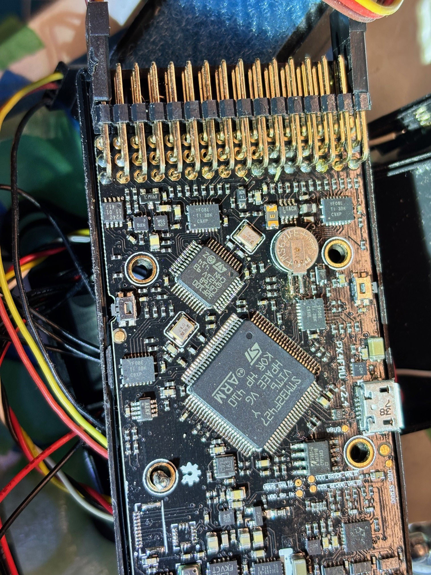

Is this the F100 or F103?
I don’t know that any of them did. But one from the 2017 vintage was F100
I don’t know. It’s a bencher I connect on occasion for one reason or another. I would not use it in any model. Open yours up and check.
OK, opened up this one I have and it’s a F100 also.
Mine is definitely F103. I have checked.
