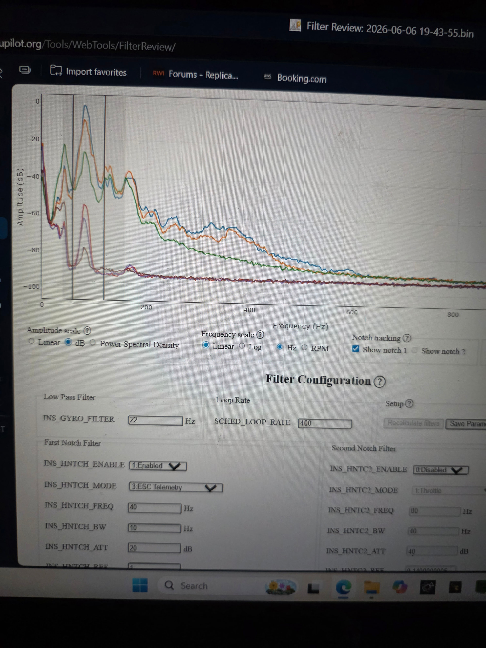

I have a question regarding the configuration of ESC telemetry notches when using DroneCAN ESC telemetry.
I am using Hobbywing 6X SE motors and have set the poles to 28, but the notches are not aligning with the noise peaks at 42/84Hz. I found that if I manually set the center frequency to 84Hz it works, and I am currently covering 42Hz with a throttle notch.
Do I need to set the SERVO_FTW_POLES parameter specifically to make the ESC telemetry notches function correctly with DroneCAN? Leave them at 28 or defult of 14?
Picture is what happens if i use only esc telemetry notches. Poles set to 28

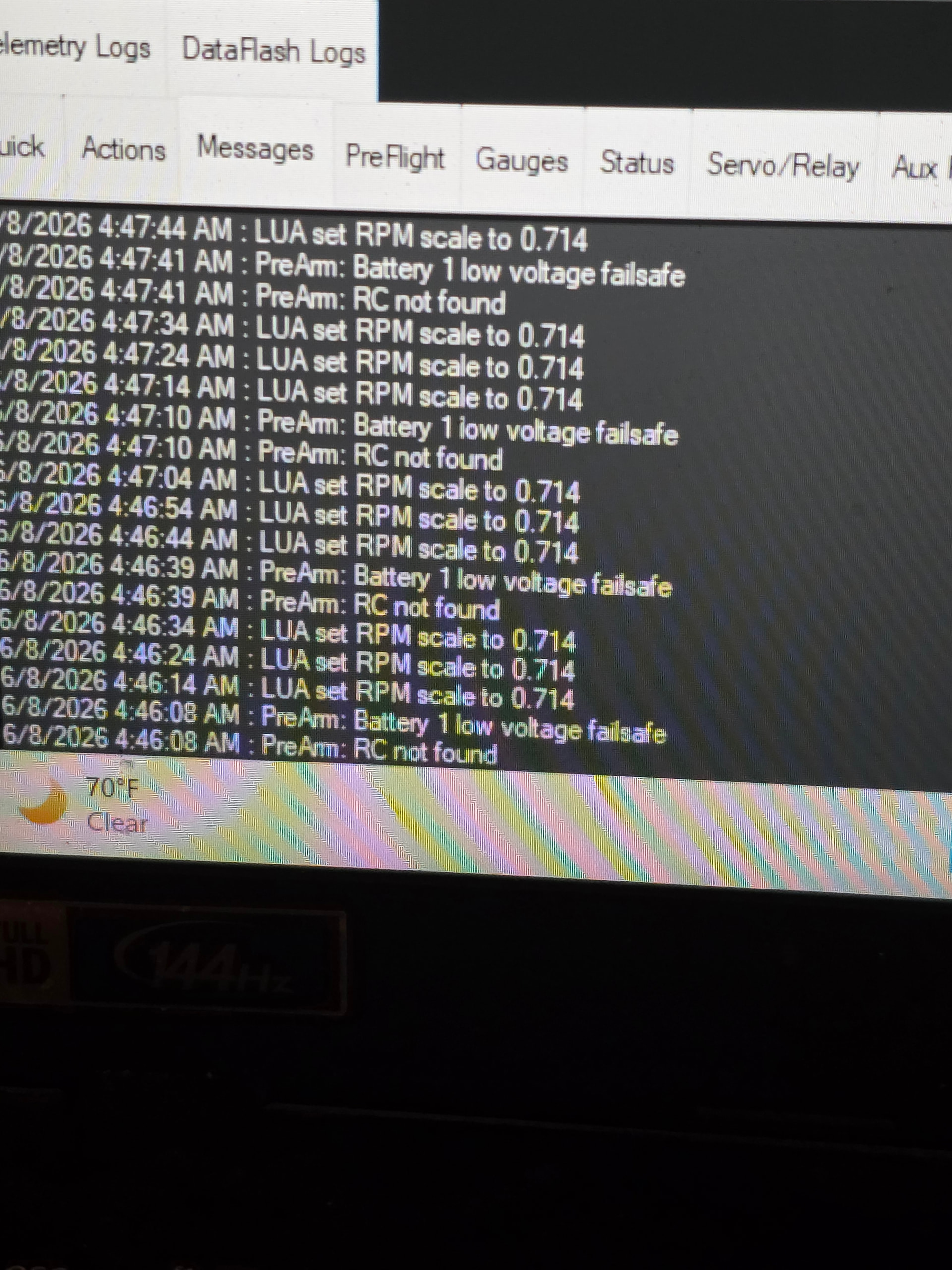

Think I i got it. Im seeing it in the messages
i thibk i got it

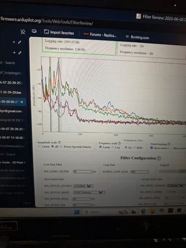

The reported RPM should now be correct. The center frequencies of the notch filters should now match the motor noise peaks.
Is it supposed to keep popping up in the messages like that? Im only connected to flight controller via USB. I did use AI lol.
Edit. I got it fixed. Thanks for your help
No.
I bet you saved that script into a file and uploaded it using mavftp to the flight controller and then rebooted the flight controller, right?
Somehow 0 became 1000
gcs:send_text(1000, “RPM scale set to 0.714”)
Beautiful

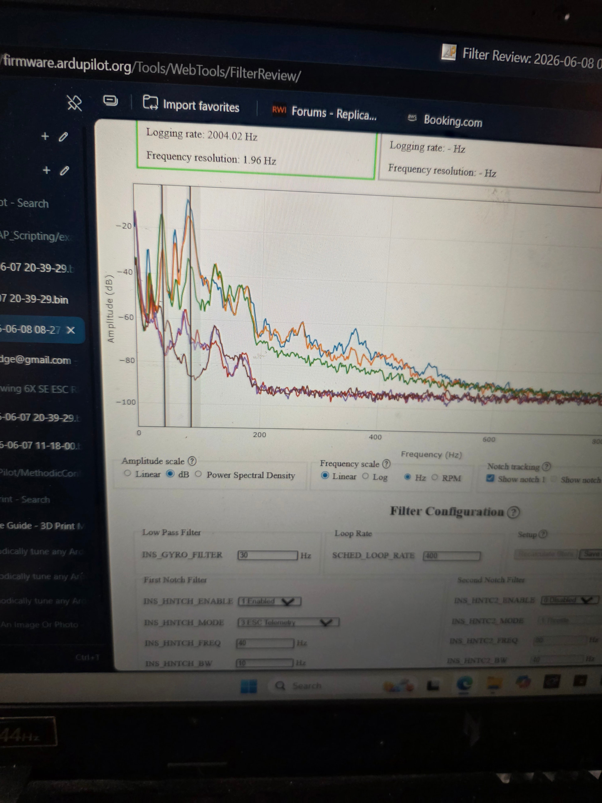

Your post notch signals look really good. Now just get the PID notch to work.
For a 22inch prop 6kg quad im surprised i only need 40hz and 1 harmonic to get all the noise down. I could probably raise the gyro filter higher than 30hz. What do you mean pid notch? I did quick/autotune but the step response was way off. I need to do a manual tune. Autotune over dampened it.
