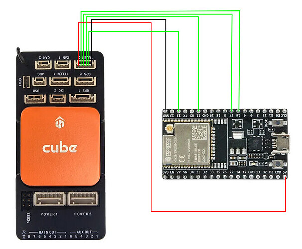

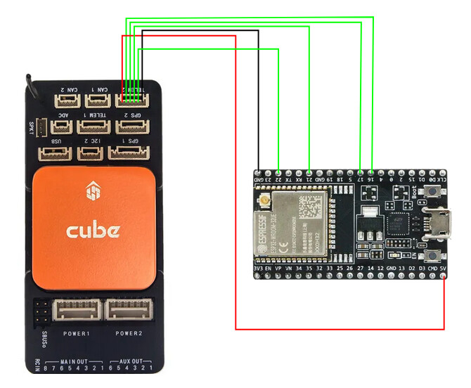

Which UART pins sis you use? Hope you used the secondary UARTs and not the debug UART.
Yes, I’m facing disconnects, but not between the Pixhawk and the ESP32, but between the ESP32 and the computer. Right now, I’ve not connected the ESP32 to the Pixhawk, I’m trying to set it up first by connecting to the WiFi and accessing 192.168.2.1.
Understood. Again, which UART port did you use?
This is the wiring.
Okay, you said you connected it to a computer. First I would suggest to try another USB cable. The voltage over a USB drops quite a bit. So for this reason I’d rather power the ESP from a stable voltage source like the autopilot itself.

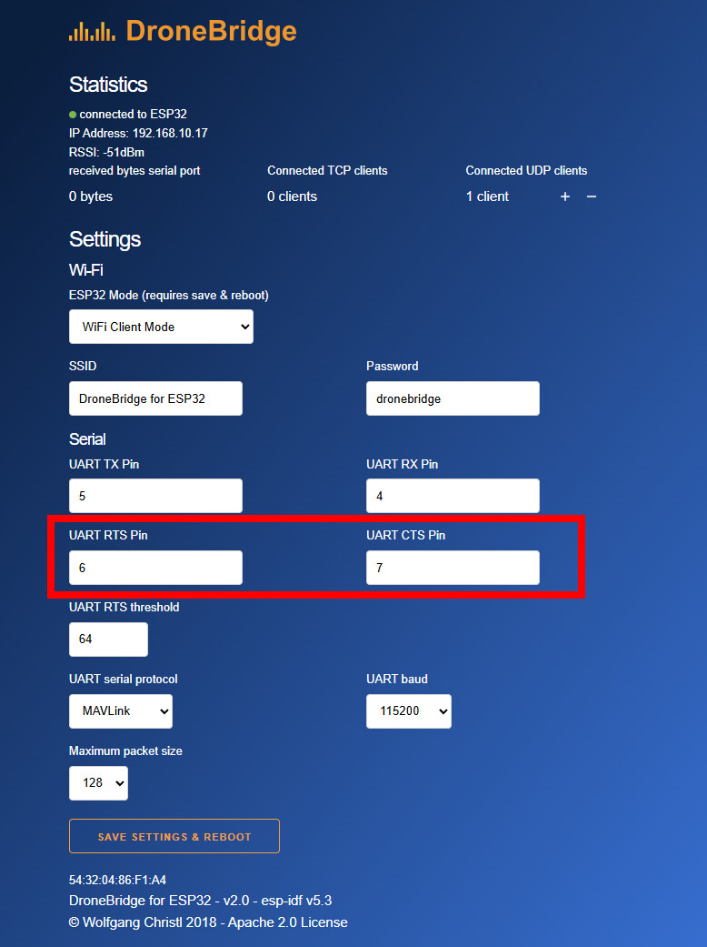

I just wanted to mention something which may help solve this:
If only 4 wires are being used (Rx,Tx, +,- ), then it is very important to set “RTS” and “CTS” settings to 0.
I spent days trying to work out why I had frequently drop outs. Eventually found some documentation advising about this.
–> Unfortunately this is not mentioned in the ArduPilot documentation. :neutral_face:
