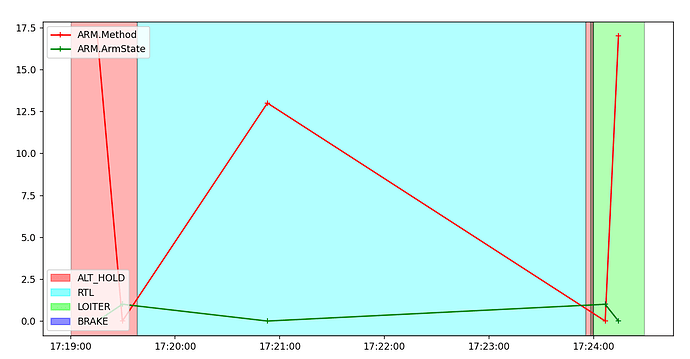

The only Arming Methods shown in the log are rudder. (Method 0)
The part I’m confused about is even though the rudder went to full travel, the throttle seems to have only just come out of the deadzone. Is this controller a center-sprung throttle?

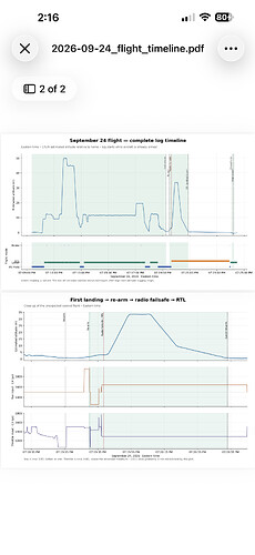

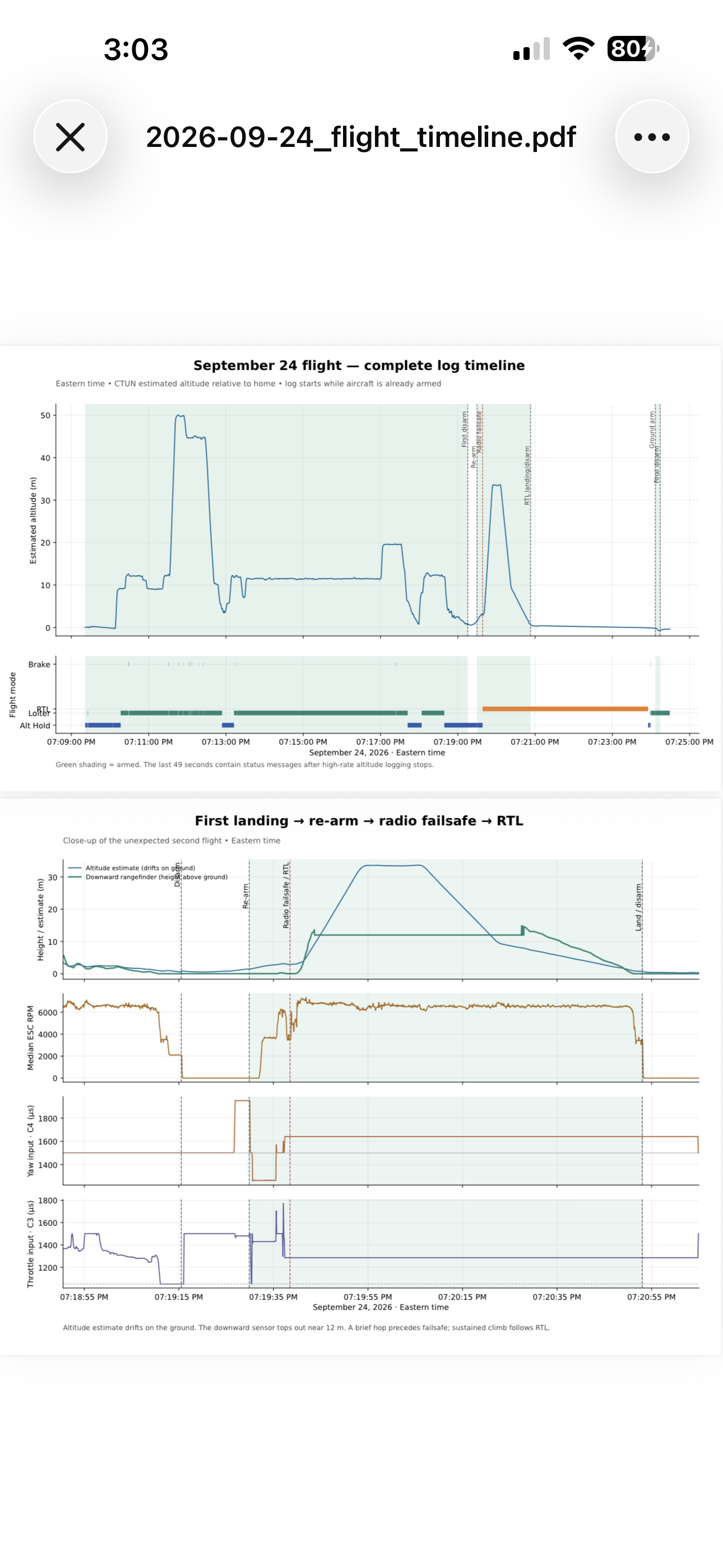

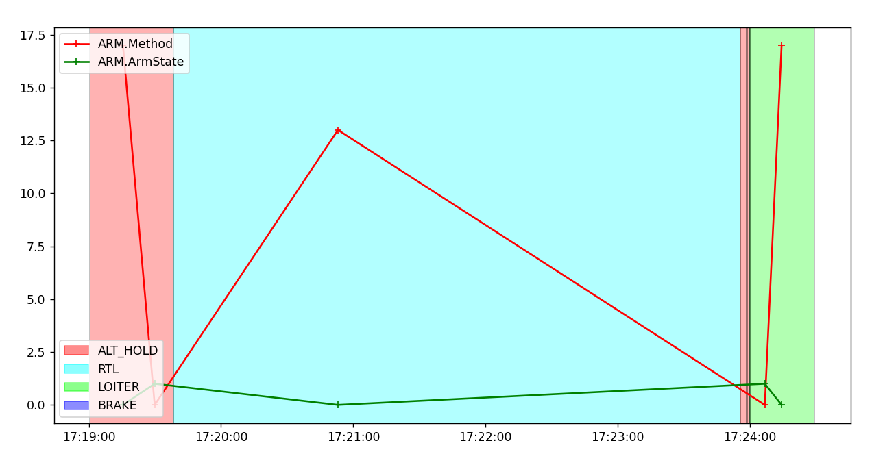

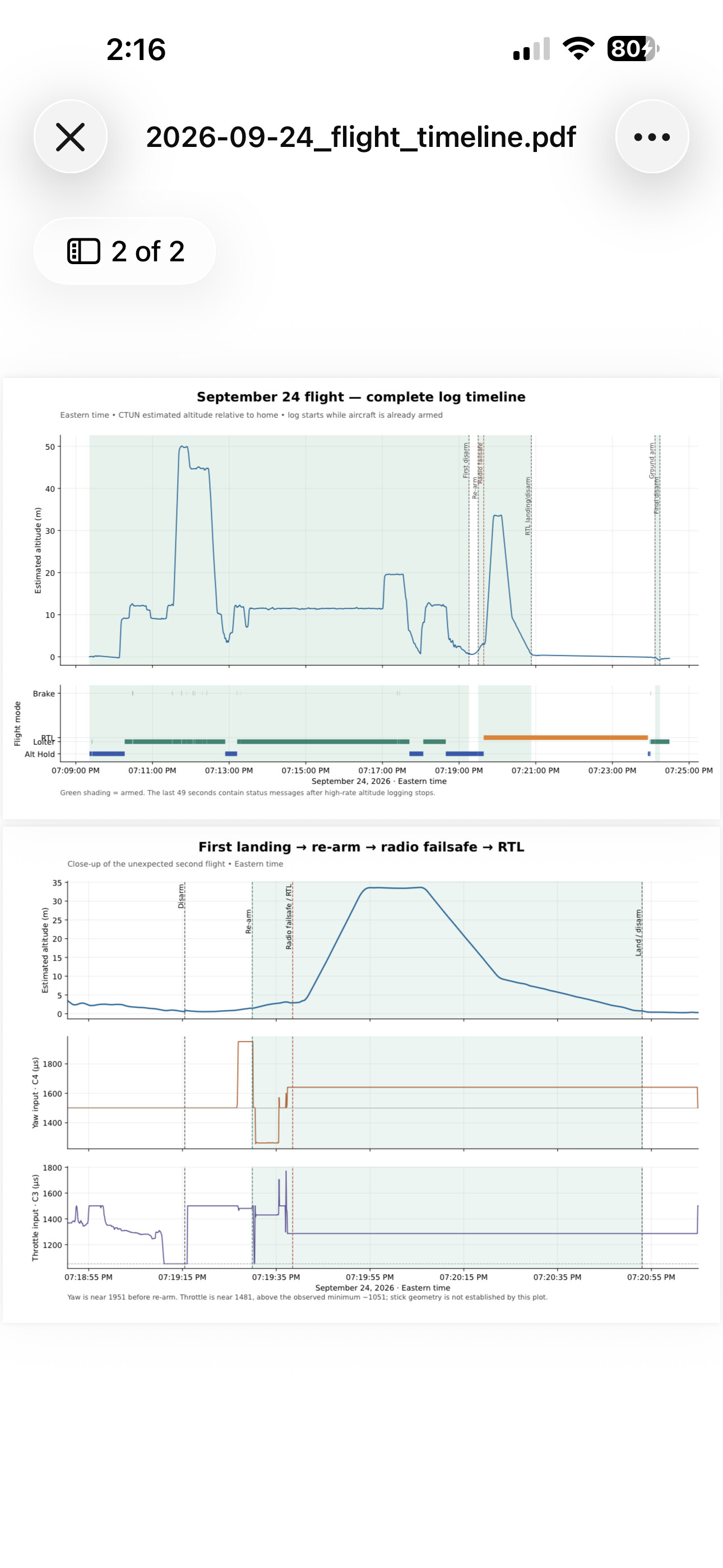

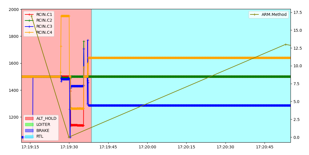

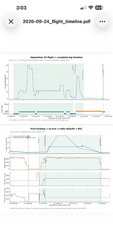

It appears that I did do a successful disarm after the first short TestFlight, and it looks like after powering off the remote control when I placed it into the pelican case faced down, it must not have been fully off because the throttle joystick was moved to a position to apparently rearm, but the question still remains if the throttle were in a state at approximately 5 o’clock, which would be my arming position and it remained that position that would not have been sufficient throttle for it to takeoff so the question is it looks like it armed, but the radio fell safe actually is what caused it to take off and go to the height, overwriting the joystick position. I’ve attached ChatGPT graph. After the automatic land after the radio fail safe takeoff in landing. I did another arm and immediate disarm.
Updated graph

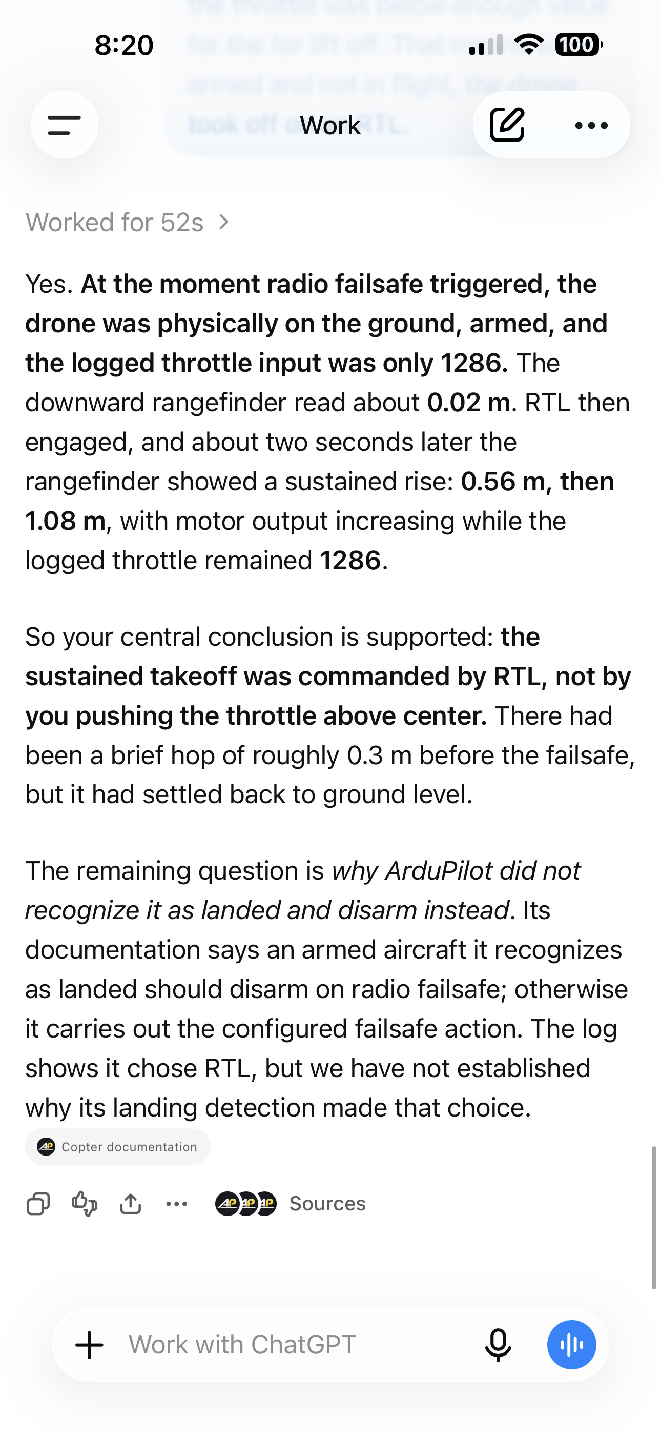

My conclusion is that when I place the remote control down to power was still on sufficiently for the joystick to work, even though the screen was turned off, and by pressing the joystick to a certain position for the throttle and YAW, it caused a re-arm. The mystery is that the throttle never exceeded 1400 and for a center detent remote control you must push it above 1550 and higher on the throttle to get it to take off the ground. As you can see the throttle never exceeded 1400 so the only way that it left a ground was with RTL in control. But why would RTL have an effect when it never left the ground? It seems like a very dangerous possibility in the software.
Because it was not “Landed” it was at Land Complete Maybe then the FS occurred.
The aircraft was physically on the ground, but the radio failsafe occurred during the short interval where ArduPilot had only reached “LAND_COMPLETE_MAYBE,” not full “LAND_COMPLETE.” RTL therefore won the race against the land detector.
