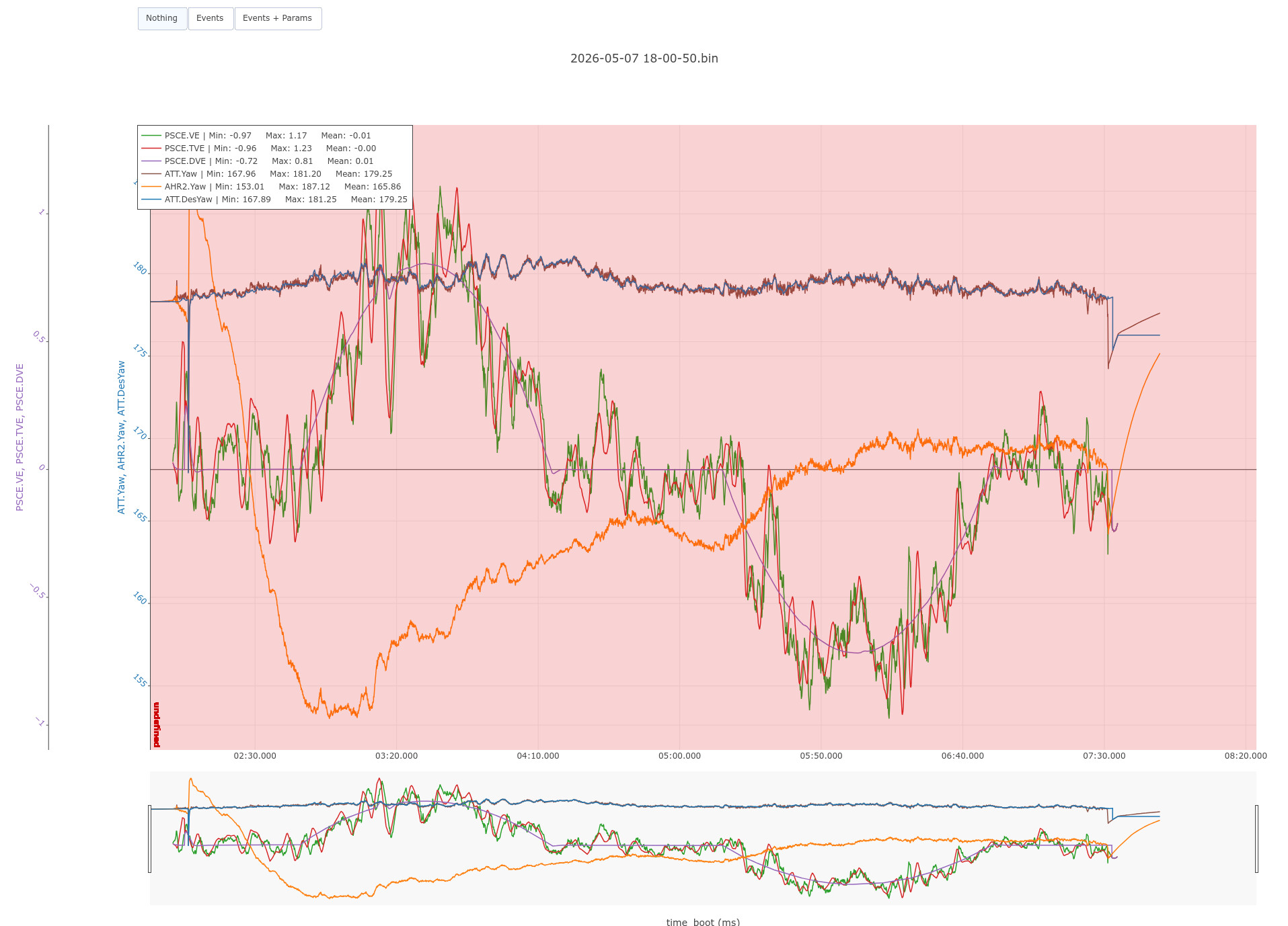

I am not very confident in this analysis, but:
  • the low-level tuning seems quite good (maybe yaw is not as sharp as it could be, but that is likely not important for a drone show)
  • the actual velocities oscillate around the desired ones - all the time, not just at takeoff and landing
  • this is accompanied with 30ish degrees of deviation between ATT.Yaw and AHR2.Yaw, which indicates to me that there is still a compass problem of some sort.

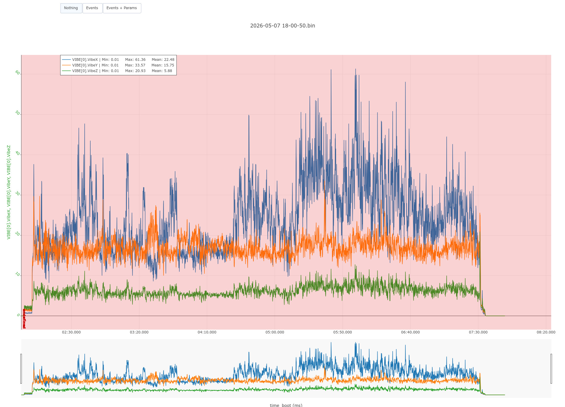

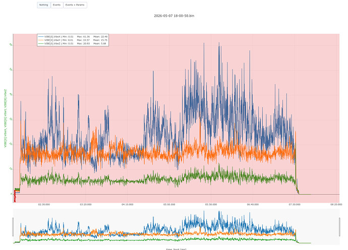

This may be additionally exaggerated by severe vibrations in Y and especially in X, which both are frankly way too much for such a tame flight profile:
My advice would be to fix the vibration issues and to improve compass positioning (and then to redo compassmot, of course). Compass positioning is not easy on a 3" build, but people have done it successfully in the past.
Toiletbowiling indicates bad heading estimate.
Your vibrations are too high.

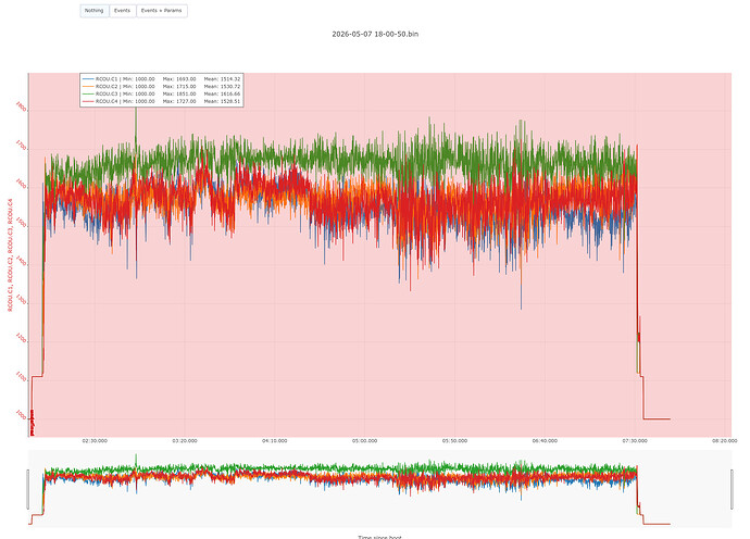

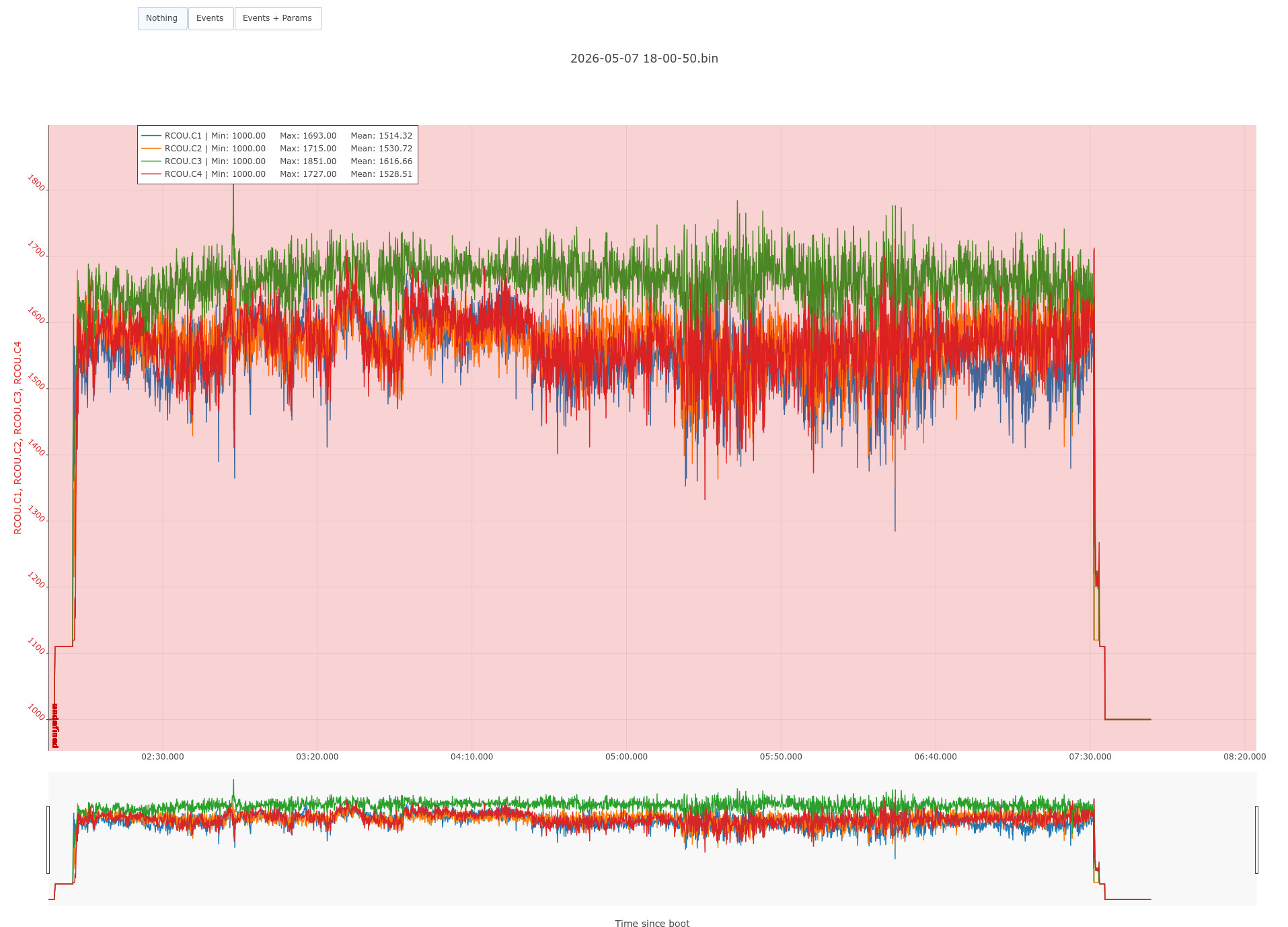

Yet another issue, which is very prominent in the first log in particular, is that RCOU.C3 (front left motor, according to the frame configuration) dominates all other motor outputs. This seems to happen over a range of flight headings in various logs, and in my opinion is a reason to check for possible mechanical issues.
I was doing the test for my new backup telemetry, so I thought RTK+ was not getting to the drones, so its mechanical issue and not related to the telemetry
To be more specefic my secondary telemetry is directly connected to the RTK board rather than FC, and the secondary telemetry is only sending RTCM3 + Base correction data
