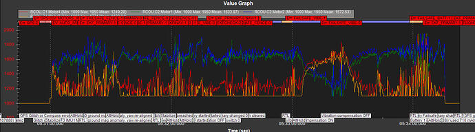

My quadcopter (10" frame, 7" propellers, ArduCopter V4.6.3) generates vertical vibrations when it is flying, and even when it is supposed to land slowly: the expected path downwards is regularly modified by short bursts of power.
I hear a specific noise at, say, 4 Hz, and the drone clearly vibrates around the vertical axis.
Propellers are new, motors are clean, the FC (DakeFVP H743) seems gently fixed.
I looked at RCOU and discovered that ONE of the 4 motors regularly dropped at 15% of its speed (the minimum in flight), whilst the other motors had a decent speed.
So I recalibrated the ESC… and now, all 4 motors drop at 15% one after the other. So of course the drone vibrates…
Also, CTUN.ThH is stable at 0.126 , and CTUN.ThO moves around 0.1.
VIBE.X was around 30, VIBE.Y around 70, so I added a filter

I thought (well, ChatGPT suggested) that the drone may be under-weight: putting all motors above 15% power would push the drone upwards ; so it would decide to stop each motor one after the other.
So I added some weight to the drone, but it does not help:
  • the 4 motors drop to 15% one after the other: every second or so (the 4 Hz I mentioned may be due to 4 motors at 1 Hz each)
  • the motors seem to have similar behaviors by pairs : Motors 2 + 4, and Motors 1+3, have “saw” shapes: 15% up to 70%, down to 15%, one pair after the other.
  • CTUN.ThH is stable at 0.2 , and CTUN.ThO moves around 0.2.
  • after filter, VIBE.X = 6, VIBE.Y = 6, VIBE.Z = 4
Does anyone have a clue of what may be happening?

Incorrect configuration.
Either read and follow the ArduPilot wiki documentation (and stay away from chatgpt) or use ArduPilot methodic configurator software to guide you through the correct and safe configuration sequence.
Your altitude controller is missconfigured and the notch filter also.
Post a link to a .bin log file.
Here it is
Looks like it needs some tuning. There are many params with default values. I see You tried AltHold, but did not do anything with the hoover learning results. First - use stabilize and decrease value in Basic Tuning and check if it oscillates. When it stops, then follow with alt hold and learning hoover.
After that PID tuning - there are many ways, easy is quick tune, autotune also is not bad. You can do it also manually using pot from transmitter.
That is a bit simplified, but general way I do it, and more or less docs describe.
All of that is described in documentation.
Read the documentation or use AMC. (first! :slight_smile:)
Yea, you have quite the mess with the parameters. Some are are not suited to a 7" propped craft and others are not set at all. You have some serious Yaw bias going on.
Start over from default and use the AMC.

Basically, I moved to ArduCopter 4.7, revisited parameters but I kept most of them similar, and when I went out for a tuning test, the flight was far far better than previously. So I can follow the tuning track now.
I must admit I don’t really know what I changed,..Most parameters used to be the “default suggested” ones and still are.
