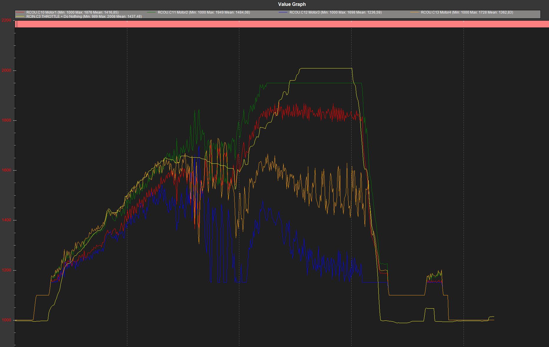

Seems there is a problem with CG and it is underpowered. One of the motors maxed out, max throttle and it did not even mover up?

I saw the rpm and the maxing out. but i honestly didnt understand why this happened

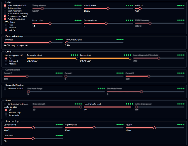

What are Your AM32 settings? Seems motors are unable to reach full power, probably due to wrong KV set. 6000rpm for 920kv motors running at 4s is far from max RPMs they should have.

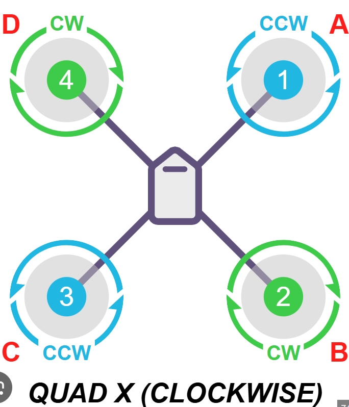

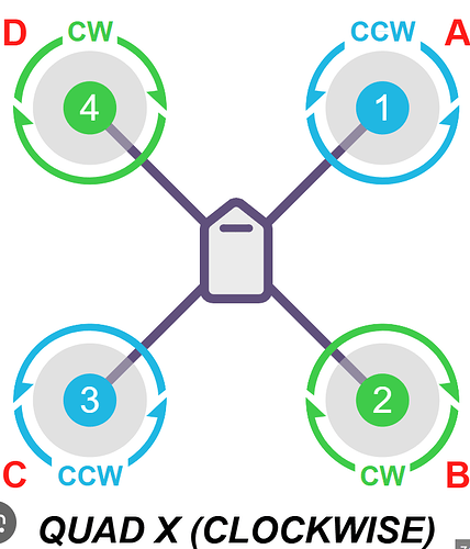

Also please check your props for the correct rotation.

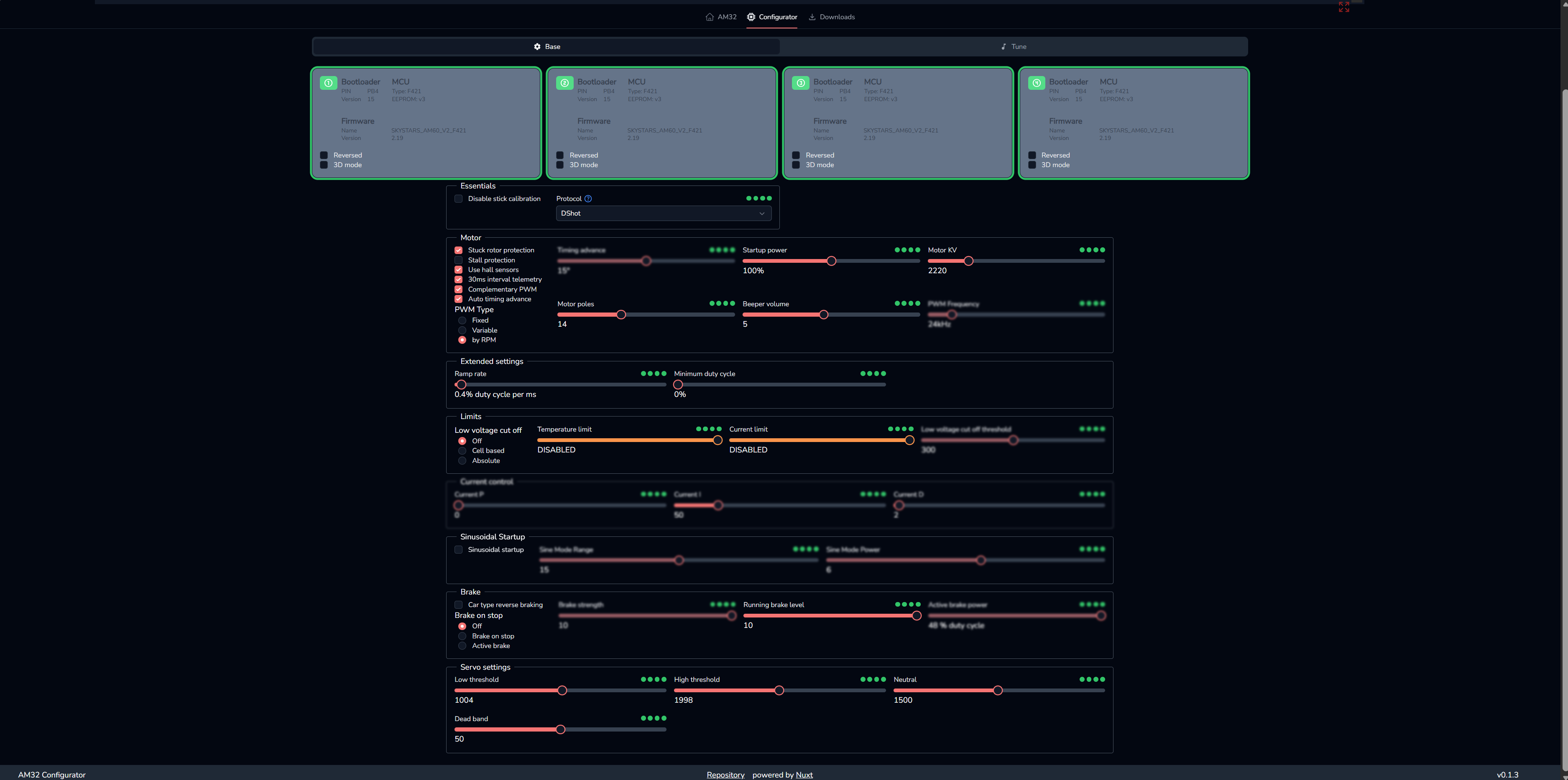

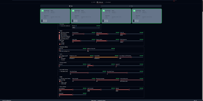

I have attached an image showing the AM32 settings. I kept nearly everything as default. Im out of solutions.. I think i have issue with the motors as they were old but i would like to confirm it some how. Any ideas?
Props are mounted considering exactly this frame attached in the image and the motor is rotating in the right direction

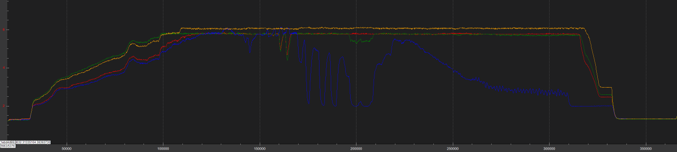

I just checked POWR.Vcc and its around 5V but i dont know if the current is loggedf and i dont have a setup to meausure it
I would appreciate if you have any comments after providing more details. I can see in the ESC data voltage and current are normal except having one large peak for a second and then back to normal

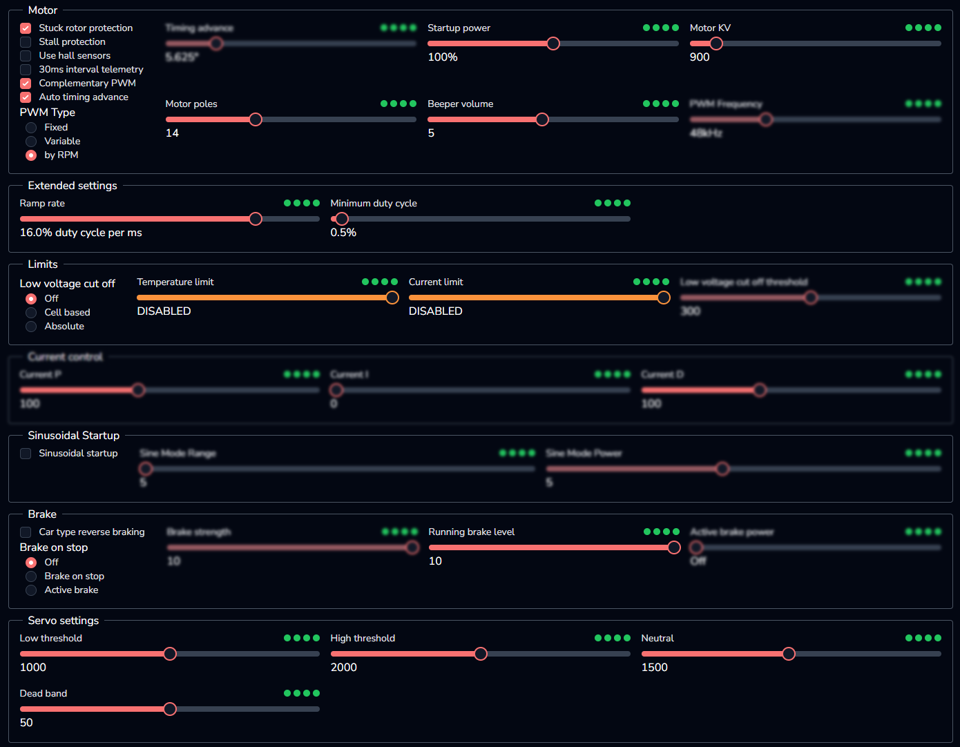

Settings are messed up.
Set it this way:
No wonder You have issues with getting motors power
But i have kept all settings to default except changed the protocol from Auto to DShot.
I can see that the biggest impact is the Motor KV in my case is set to 2220 KV. Am i thinking right? Is this what blocking the motor to ramp up?
It is far from default. You can use “send dafault config” or something like that in configurator and see
  1. You do not have hall sensors on motors, so why this is enabled at all? (for sure not by default, and this ESC does not support hall sensors at all)
  2. KV
  3. ramp up slider decides how fast ESC can increase PWM duty, and accelerate motor
30ms interval telemetry? No idea what that does, but never seen is used and for sure is not enabled by default.
I have exactly same ESC, and that is NOT set as “almost default”.
