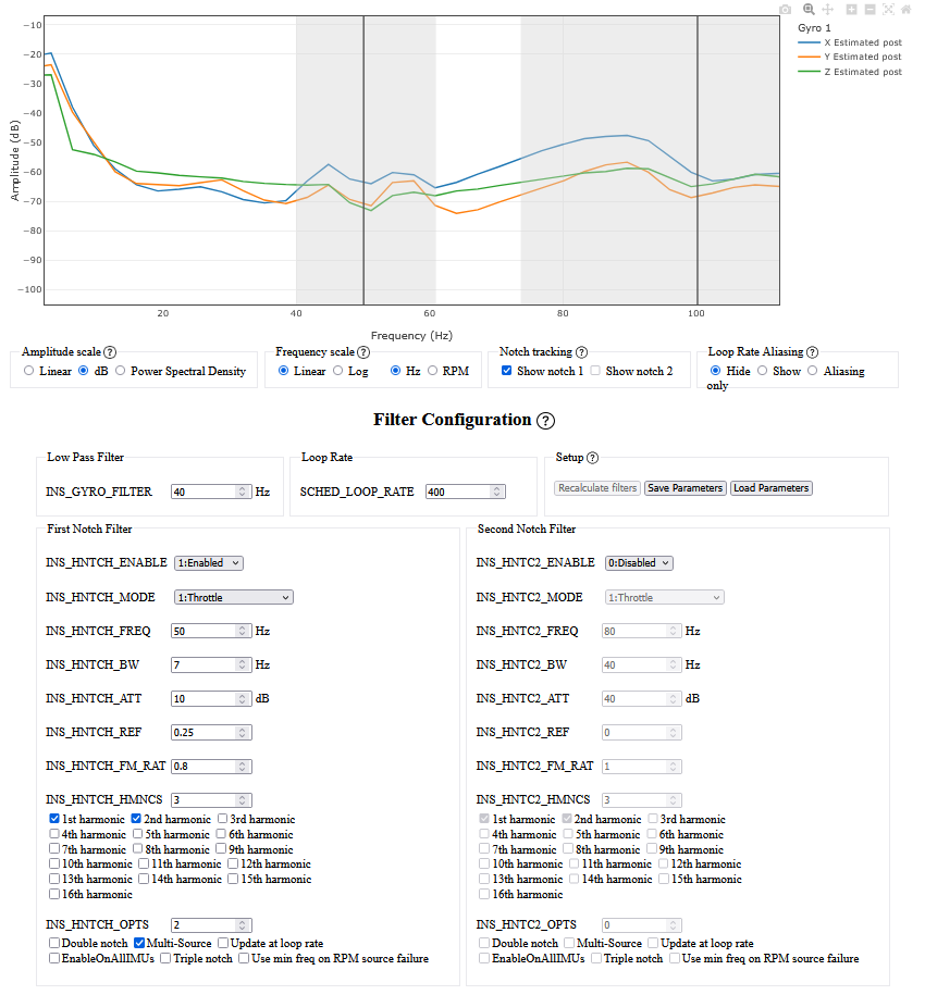

Attitude PIDs looks acceptable, maybe a bit too high, apply what Allister suggested, you may try alternatively this filtering, it push LPF higher but I afraid it won’t affect the tune much:
INS_GYRO_FILTER,40
INS_HNTCH_FREQ,50
INS_HNTCH_BW,7
INS_HNTCH_ATT,10
INS_HNTCH_REF,0.25
INS_HNTCH_FM_RAT,0.8
INS_HNTCH_HMNCS,3
INS_HNTCH_OPTS,2
INS_HNTCH_ENABLE,1
INS_HNTCH_MODE,1
INS_HNTC2_ENABLE,0
ATC_THR_MIX_MAN,0.5
PSC_ACCZ_P, 0.2
PSC_ACCZ_I, 0.4
To better review PIDs it’s good to have Fast attitude instead of Medium attitude logging in LOG_BITMASK
