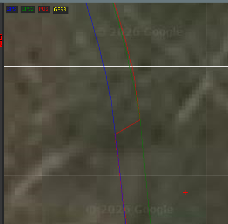

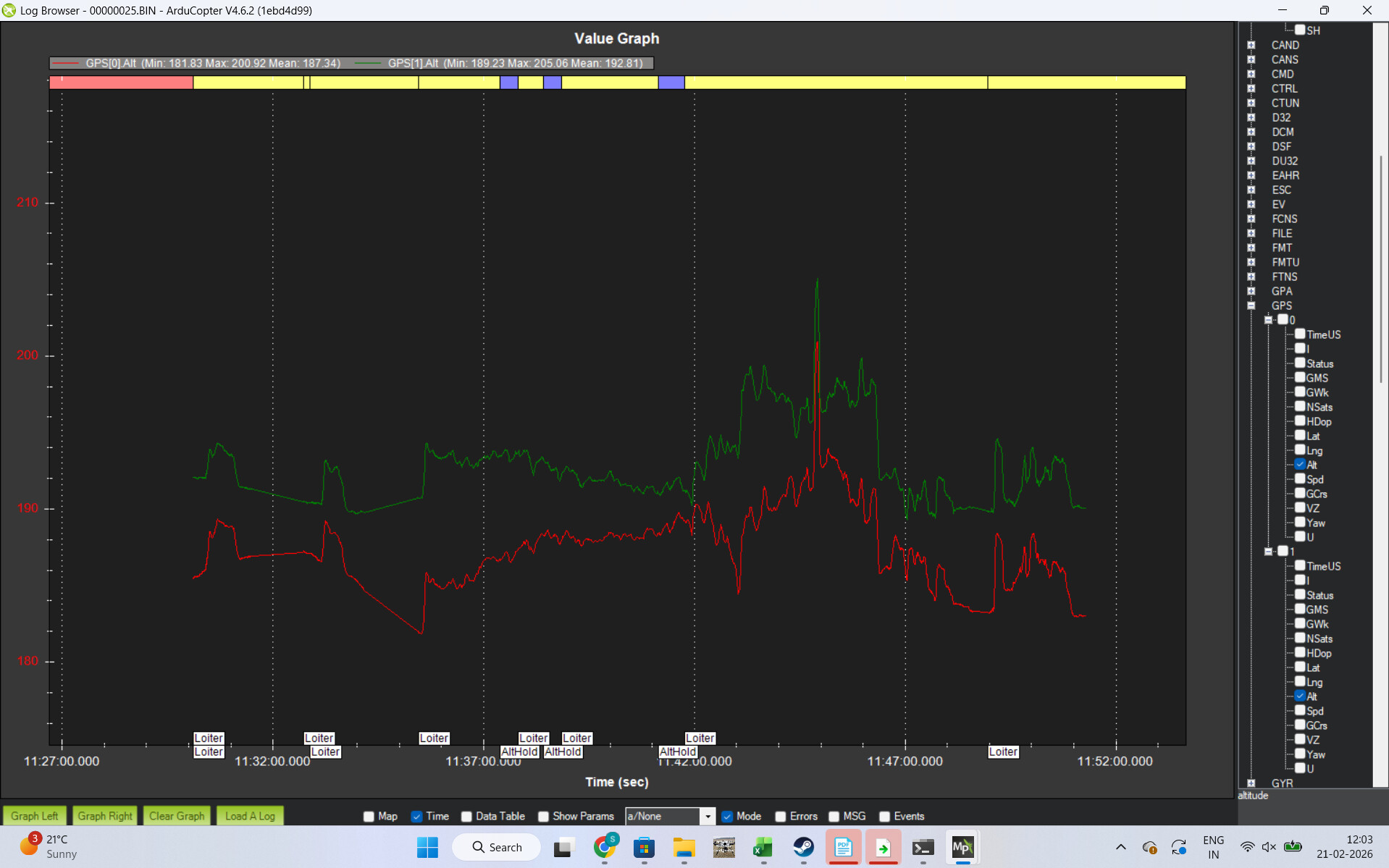

Desired and Actual attitude seems synced, Viberations in all axes are below 10, RCout Shows variance in PWM, the thing which i think is abnormal is alt reading from GPS, I’m using two GPS which are placed at same height, but log shows 10m variance through out.
From params GPS Switch is set to Use best and log shows variance between alt of both gps, can it be the reason ???
GPS_Auto_Switch : 1 : Use Best
GPS_Primary : 0 : First
No offsets have been given for both the GPS
Both the GPS are placed more than 20cm apart, and at same height.
I can have a test flight by configuring use of primary GPS only or by disabling second GPS to formulate Root cause??? Will this be right approach ??? @amilcarlucas @andyp1per @xfacta

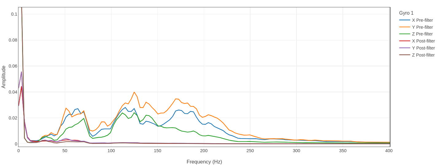

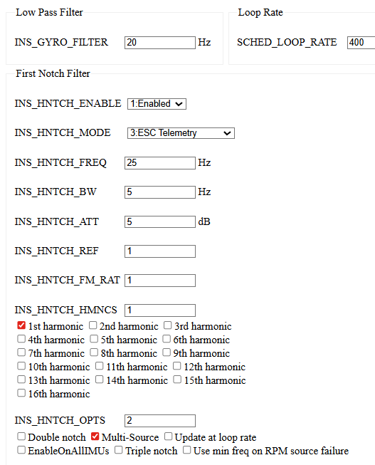

First thing I notice you dont need any harmonic notch filter at all. There’s essentially nothing to filter and the configuration was wrong anyway.

INS_HNTCH_ENABLE,0

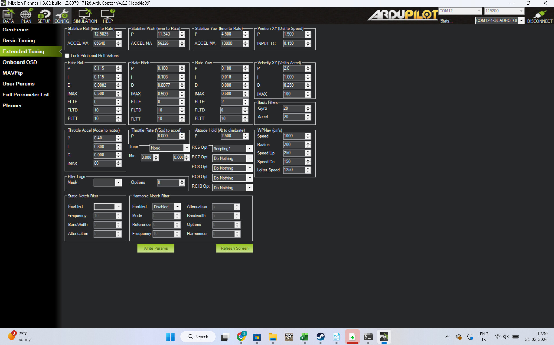

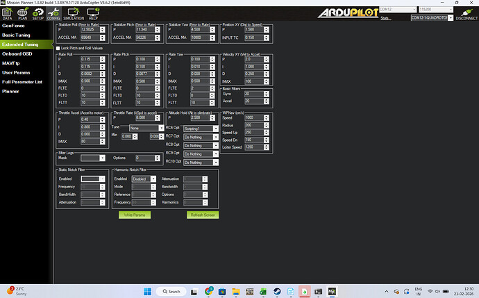

If I assume the ATC parameters are the result of pitch and roll Autotune, then lets make some changes to smooth things out a bit:
ATC_ACCEL_P_MAX,56226  -> 45000
ATC_ACCEL_R_MAX,65640  -> 52500
ATC_ANG_PIT_P,11.34    -> 10.2
ATC_ANG_RLL_P,12.5025  -> 11.25
ATC_ANG_YAW_P,4.5      -> 6.0
ATC_INPUT_TC,0.15      -> 0.20
ATC_RAT_YAW_I,0.018    -> 0.05
ATC_RAT_YAW_P,0.18     -> 0.5
ATC_SLEW_YAW,6000      -> 3000
PILOT_Y_RATE,202       -> 60
This is ACCEL values -20% assuming you will have a payload, and Angle P’s -10%. Some Yaw PID increases to get it behaving properly.

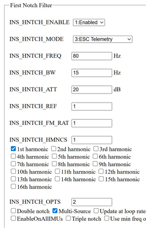

Set this for the notch and then disable Raw Logging. It’s only used for short flights to configure the notch otherwise it creates huge files like one of those.
Then give Auto Tune a try.
Thank you @dkemxr , I’ll have a test flight tomorrow with mentioned changes and update here about the same.

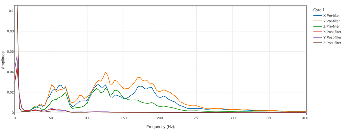

80hz is too high for 28", something like this is more appropriate.

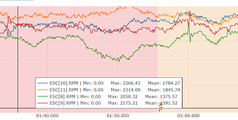

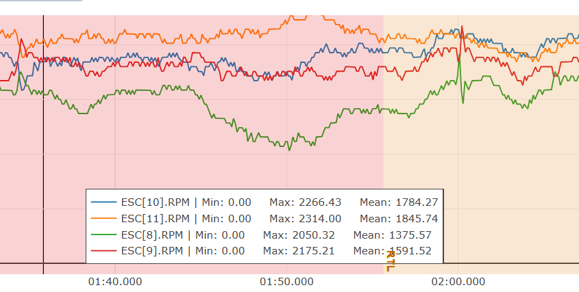

You need to take a look that your motors are in level or COG issues because motor connected to output 8 works much less than others, it can cause instabilities
Yes, I think you are right. Could add the 2nd harmonic too as it’s a shade over 50dB. Or not.

I disagree.
There’s no need for any harmonic notch filter at all. You’ll just be introducing unnecessary PID lag or similar artefacts.
See in this graph the post-filter (INS_GYRO_FILTER) is practically a flat line across the bottom of the graph at close to zero amplitude. On the db scale some noise nearly comes up to just under -50db and most noise is less than -100db. It does not get much better than that.
The parameter you need is: INS_HNTCH_ENABLE,0
and INS_RAW_LOG_OPT,0 since I think this is no longer needed.
I’ll look of the rest of the logs.

EDIT: The primary GNSS unit is switching The GNSS units are changing which is primary based on their different signal quality. This is possibly what’s causing the odd behaviour at waypoints, even though the switch-over is not actually at waypoints - it may just appear that way.
Try these settings:
GPS_AUTO_CONFIG,2
GPS_AUTO_SWITCH,4
GPS1_GNSS_MODE,37
GPS2_GNSS_MODE,37
