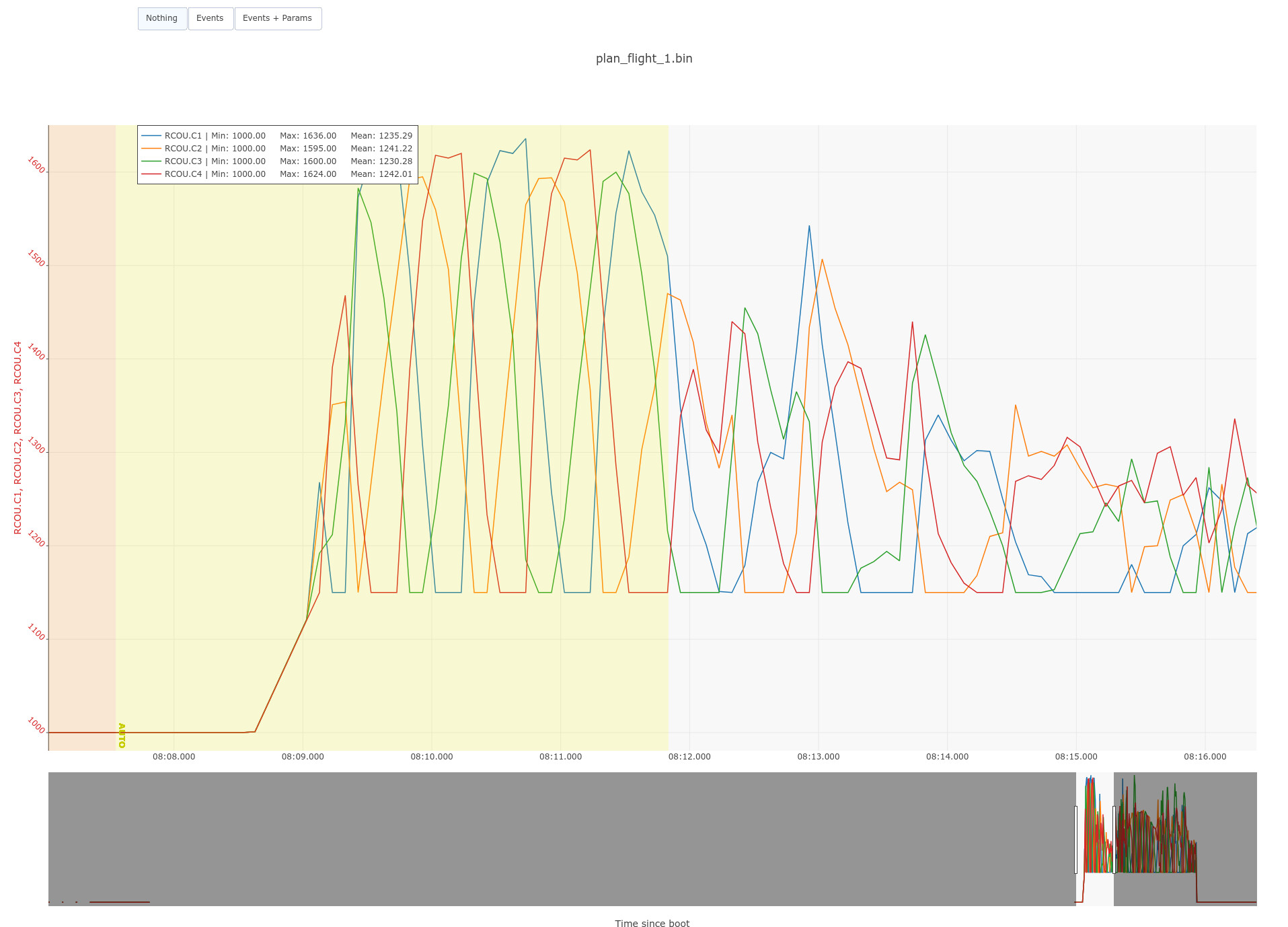

In Guided or Auto Mode, I set the takeoff to 3 meters relative to home, and at 3 meters, I get the event not_landed, which means takeoff is complete. But for some reason, the drone increases altitude by another 25+ meters. In waypoint_auto.bin, I set the waypoint to have an altitude of 2. You can see that the drone’s takeoff overshoots and then it descends to 2 meters to reach the waypoint.
Do you have any idea what’s going on?

You have not even attempted to tune your craft - and still tried to fly a managed mode.

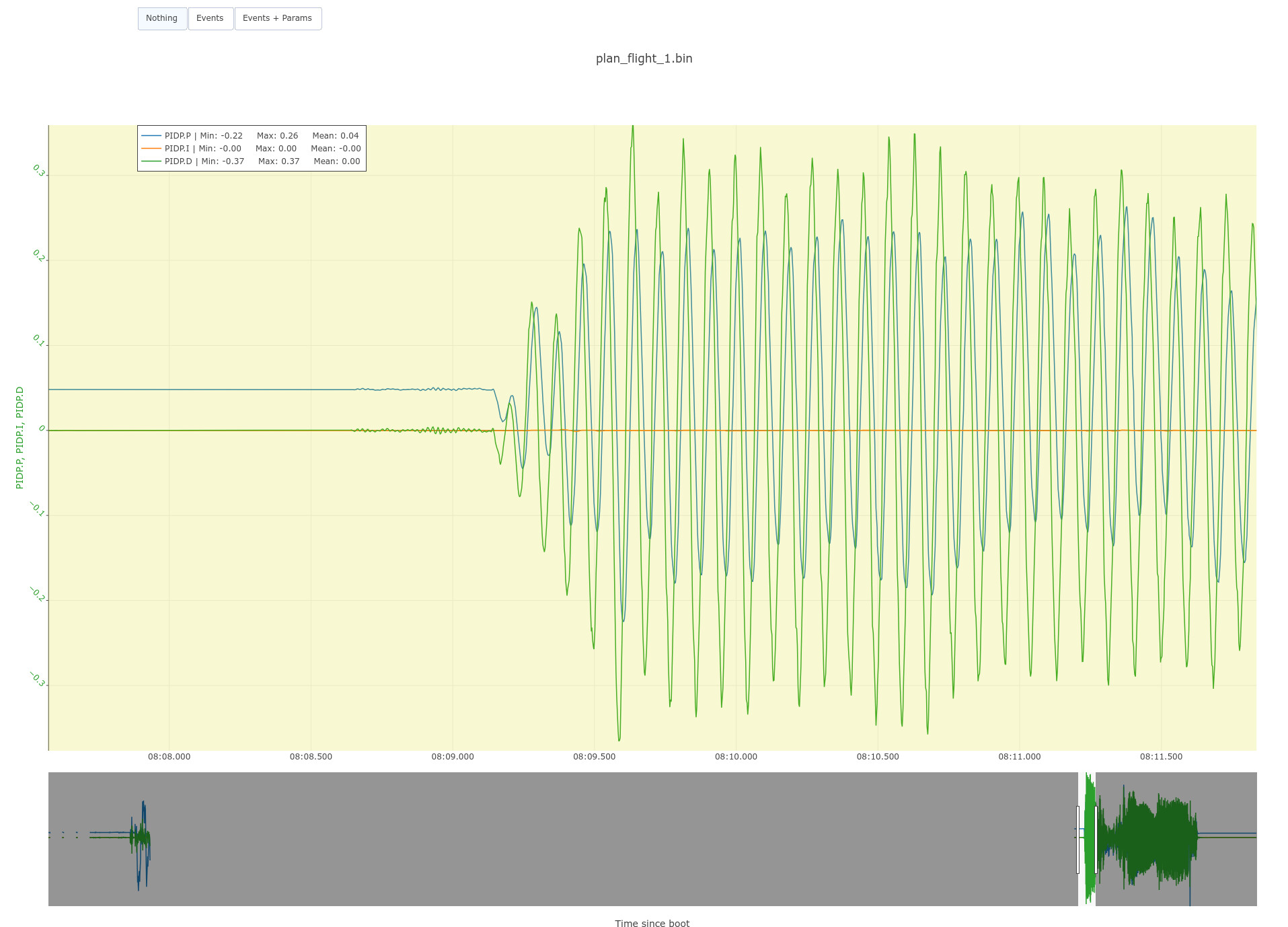

All PIDs are at defaults, PID responses look like this (these should not oscillate clearly, especially the proportional part, and should not normally exceed 0.1 when not doing anything crazy):
and motor outputs like this (not clipping from either above or below, should be normally quite similar to each other when hovering, with some noise maybe 100 PWM wide):
so there is nothing to talk about. Tune the machine. Sorry for the burst of anger, but it’s a really bad idea to fly autonomously before completing basic tuning.

The tuning is non-existent and motor outputs are oscillating badly, often hitting minimum PWM.
I think you’ll find the copter is rising in an attempt to maintain stability - throttle has to go to ZERO for the copter to descend.
I would say you need to fit an RC receiver and complete all tuning before revisiting this issue. Once the copter flies perfectly with an RC transmitter and receiver in all situations and failsafes are tested, then proceed with guided-only operation.

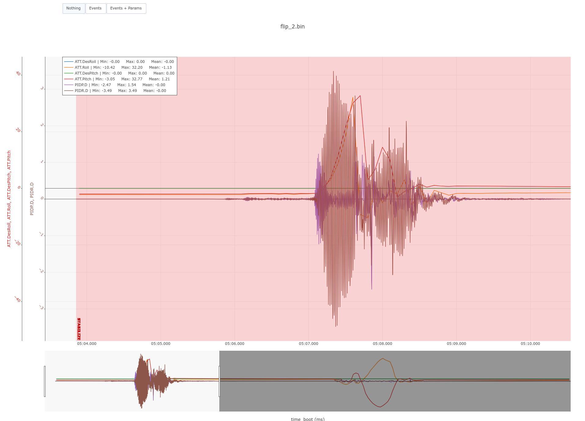

But every time I increase throttle, the back right motor lags (or doesn’t generate enough lift) and the drone flips. Here’s one example: video and bin file. Here’s another: video and bin file. The back of the drone faces the camera, so the right motor that is visible is motor 4/B and the left visible motor is 2/C. Launching off the LiPo is super unstable and could damage it, so that could be the cause. Another hypothesis is that my ESC isn’t passing enough throttle to the back right motor.
Here are my updated params. What do you think is causing this behavior?

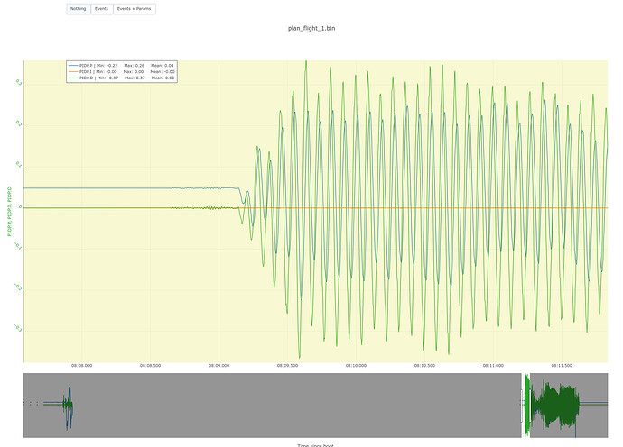

The primary cause, 99% likely, is the default D values for roll and pitch PIDs, 0.0036, which are way too high for this machine in its current state. They do this:
and quickly saturate the entire control bandwidth. For a new agile machine, I would start with a value of about 1/30 of that, say, 0.0001. While this will not give you sharp control, this should get you to something resembling a sensible hover.
