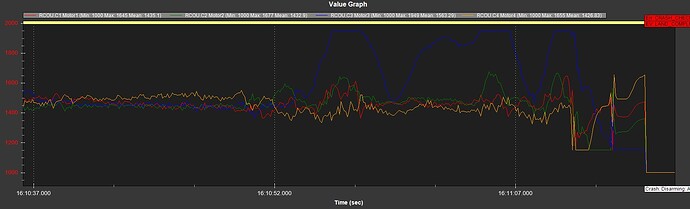

I am having an issue with my drone.
Carbon Fibre Frame, 11inch props, Pixhawk 6 Mini, 6S, Arducopter 4.6.3.
The drone will take off and fly perfectly for several minutes, and then it will control and crash.
Log 7, drone took off, flew forward, and when I yawed to the left, it lost control and came down in a semi controlled manner and crashed.
Prior to that flight it had been flying OK.
I have been testing and the latest flight, was going perfectly for 6 minutes and then started to lose control. I managed to land, but then it flipped over.
I assumed it was something with the compass, but I am no longer sure.
Ignoring log 7 as it’s old firmware.
Seems to be an intermittent thrust loss on Motor 3. And you have a lot of default parameters; Notch filter not configured and you have the Bdshot version of firmware flashed but not configured. Some hardware problem and basic configuration and tuning.
In Log 7, motor 1 had the same intermittent issues. Either way, the crashes are a mechanical problem, not a software issue. Check power distribution, prop mounting, wire harnesses.
And the tune can be improved.
Thanks, I will look at the hardware.
Yes, there is room to improve the tune. It is running the default tune for 11 inch, and it flys pretty well. I have to get this issue resolved before doing any autotunes, etc.
I have discovered the negative wire from the 4 in 1 ESC’s to the flight controller was broken. Would that cause these issues?

How can you see there is an issue with motor 1 and 3. To me the logs look OK until everything goes wild.
When an output is commanded to max as this was there is a lack of thrust indicating a problem.

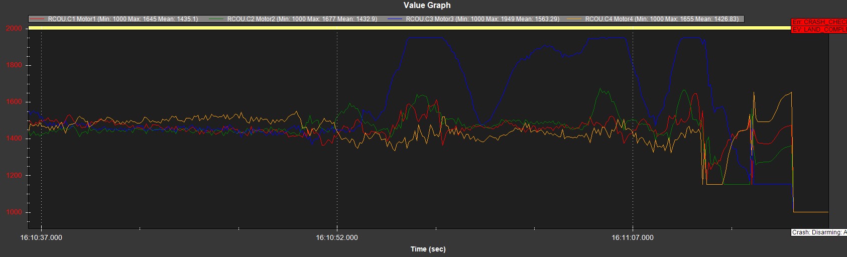

Following your suggestions, I pulled the drone apart, but couldn’t see any damage to the wiring to the motors, and the soldering looked OK. Couldn’t see any issues. I replaced motors 1 and 3, to be on the safe side.
Below is the log from the test flight. Took off and drone started yawing to the right (CW), then started pitching and rolling, so landed.
The log showed the F/C maxing out motor 3, but it wasn’t. There is the message, Potential Thrust Lost, but there wasn’t.
After landing, the motors powered down (as they do), but then increased in speed, not responding to the throttle. It all ended with me unplugging the battery.
Is this a flight controller or ESC issue? I can generally work out what is happening, but this one has me beat.
The RCOU values are only showing what the FC is commanding, not always what the ESC is seeing or doing. In this case it’s clear the FC is commanding full power as you’ve seen, to provide some kind of stability correction, but the FC is not seeing any kind of result from it. As such it’s giving the thrust warning because all it knows is it’s asking for max thrust but it’s not getting it.
It’s a Motor or ESC isssue. Also check wiring and other physical connections. Don’t overlook prop security.
