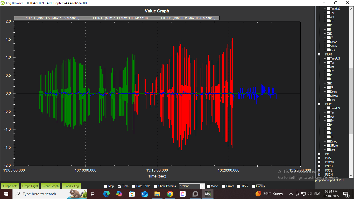

Hi mr.Shawn, I tested my DRONE after repair it flies good and also hovers in alt-hold mode. so that I tried with Auto-tune. I set
AUTOTUNE_AXES - 7
AUTOTUNE_AGGR - 0.1
It shows the below data
but also shows auto-tune failed few times in the flight
So i tried again and the DRONE crashed. the log of crashed flight is as follows.
kindly let me know about the issue with this and i would grateful

Motors 1 and 2 get into an oscillation fight and and very quickly are oscllating between maximum and minimum outputs. There’s no evidence of a desync or a fault like that, but maybe this combination is just not up to the job.
These are the same motor/ESC positions that gave issues in the first crash log.
EDIT: Interestingly, current seems most effected by Motor 2 output so that may be a clue. Motors 1 and 4 hardly affect current even when driven to maximum.

I simply graphed the battery current and all the motor outputs. This is not definitive though as there may be slight lag in the current measurement (maybe) or those T-Motor ESCs have been known to react badly to over-current spikes that dont appear in the conventional current monitoring. There could also be other conditions like wind or attitude change that mean the motor outputs dont directly correlate with current draw.
In my experience the Antigravity motors are low on torque (or power?) and could possibly be a source of instability since they may not respond well the changes. At least some of the models I’ve seen are like that. They are typically advertised as “long time” flight meaning they draw low current, but they also lack authority and can be difficult to tune and only work in particular weather conditions. So just be aware of that.
One of the things I noticed is your Rate PIDs are quite high, which could be OK, or it could be sign of the control loops trying to get good response out of those motors - unsure at this stage.
I would drop the D terms a bit to make sure those ESCs are not getting too hot:
