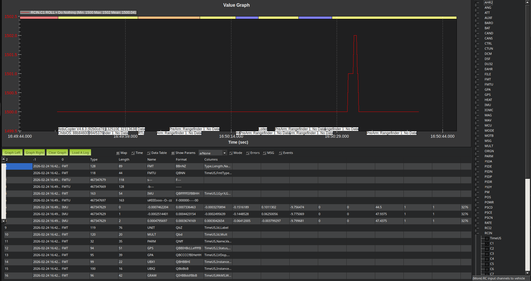

Here is the complete turn of events
Our range finder was faulty. U can see in attached image rangefinder1: No data.
So, we decided to turn it off. We used mavproxy on jetson nano which was on drone connected with FC. Jetson was accessed on terminal through SSH. We routed the mavproxy –out on laptop and connected on mission planner on laptop. Modified the parameter. Rebooted the pixhawk and motors turned ON.
Attached image is from 2nd last log file and this is the link of 2nd last log file on FC: https://drive.google.com/file/d/1oh7uI_7-mlyj0XRdJkcEhpFRNlKDjboY/view
Motors turned on in which log file? If it is first log, then are you using dronecan escs since there’s no RCOU data.

Not much to see in these logs. The Arm switch is initially high for both and there are no motor outputs being commanded. And as noted there is no ARM field in the log which is odd with the default bitmask.
