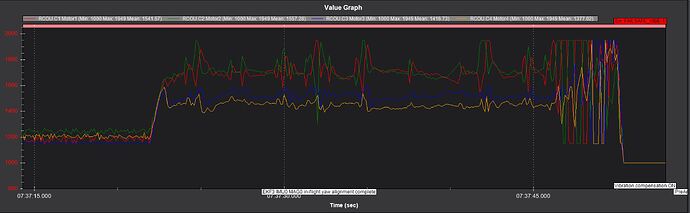

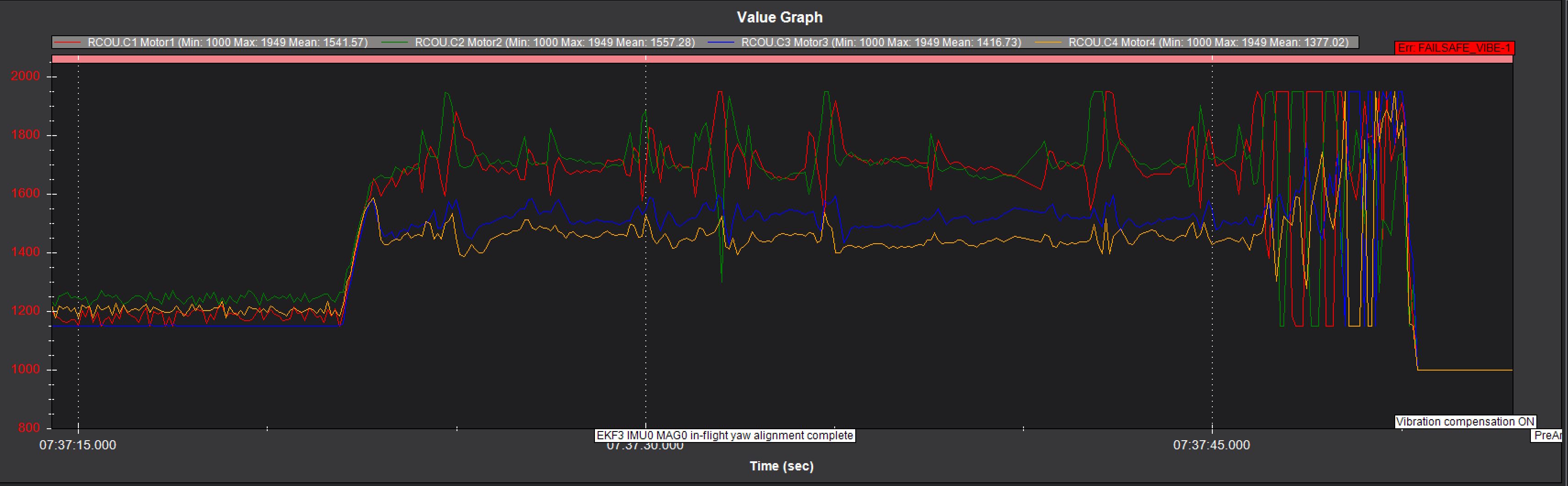

Why? The tune on this craft is not in any shape to configure the Notch filter. You still have some pre-first flight parameters at default. There is a mechanical Yaw bias clearly shown on the RC outputs and some large oscillation. You can review this log for yourself by graphing these fields:
I don’t understand your fixation with the Notch filter. Your very 1st post was about configuring that and the craft had not even left the ground. There are fundamentals to get right before that can be properly configured. Have you given up on the Methodic Configurator?

It is normal for the aircraft to drift in all directions in stabilize mode.
ALT_HOLD mode only stabilizes altitude, it is normal and expected to drift horizontally.
You need to just follow the steps, without being creative and skipping stuff just because you do not understand them.
Do all the steps. Why did you skipped the non-optional step 11?
Understanding the steps does help, but doing them helps even more.
This forum contains lot’s of posts explaining “Yaw bias” and how to fix it.
Exactly which ones overwhelmed you? Be specific. Only then can we help!
Here is a chance for you to take some initiative, learn something useful and figure this out for yourself. Open the log in Mission Planner and check the “show parameters” box. In that screen page down to the ATC_ACCEL parameters. It shows the values you have and the default value. Do the same for the MOT_SPIN and the PSC_ACCZ_P/I parameters.
And with respect to the Yaw bias do as @amilcarlucas suggested and search the forum. This problem occurs all the time and must be fixed. I included the graph above so you can reproduce it and determine for yourself if the fixes you are trying are working or not.

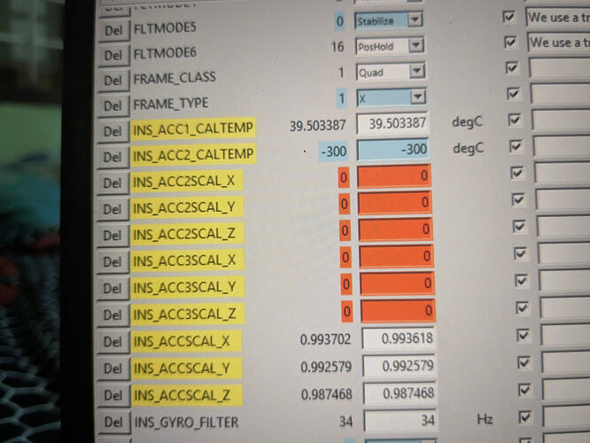

Sir I just checked from step 2 itself and I find a problem in step 12. I am attaching the photo and zip file.
Pls tell me regarding this parameters with red colour.
Tell you again you mean?
What was the answer in this post?
How many IMU’s?
sir extremely sorry for my action i really forget that I put a post regrading this.
You keep forgetting stuff. Please fill the “reason why this parameter changed field” for each parameter that you change from it’s default. Your future self will thank you, and we will thank you as well.
Exactly sir actually I didn’t get much idea regarding this values earlier so I uploaded the default values.
