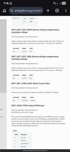

I am trying to apply voltage compensation on our copter properly and found this in the wiki.
Our copter is 14cell system and its max voltage is 58.8v.
Would compensation still work for our copter? Current setup is Min 42, Max 58.8v.

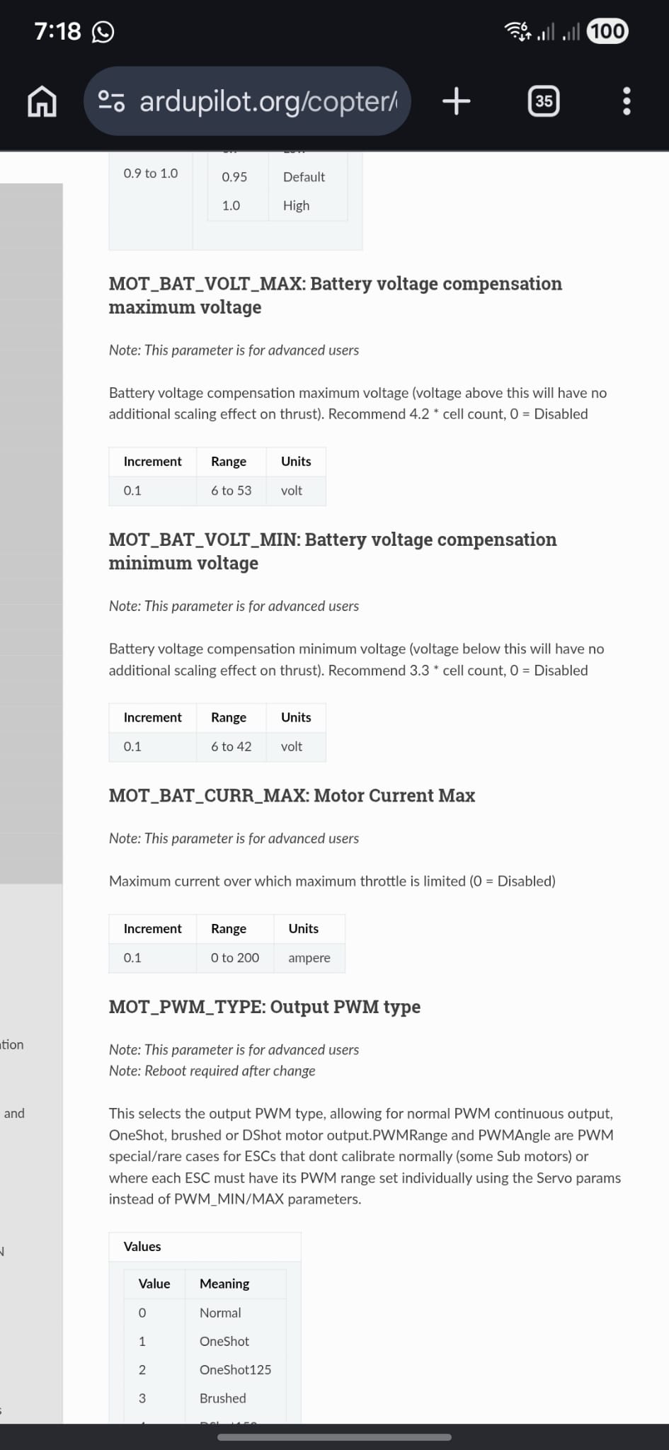

Ignore the limits. It will work outside of them. Release 4.8 will have higher limits to avoid this issue.
Thank you!
